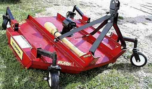

I need to top up the gearbox in the 4 blade Scorpion cutter/shredder that came with my Iseki tractor. Anybody know what it takes? I don't have a manual.

Who's gearbox do they use?
As a rule, most of your standard rotary cutter gearboxes use regular, off-the-shelf 80w90 gear oil...
I've seen pix's of the J-bar, but not in person... how is the performance of the "4-blade", & what capacity?

This J-bar rotary cutter appears to use a 40 hp OMNI gearbox, which uses the 80w90 gear oil...
