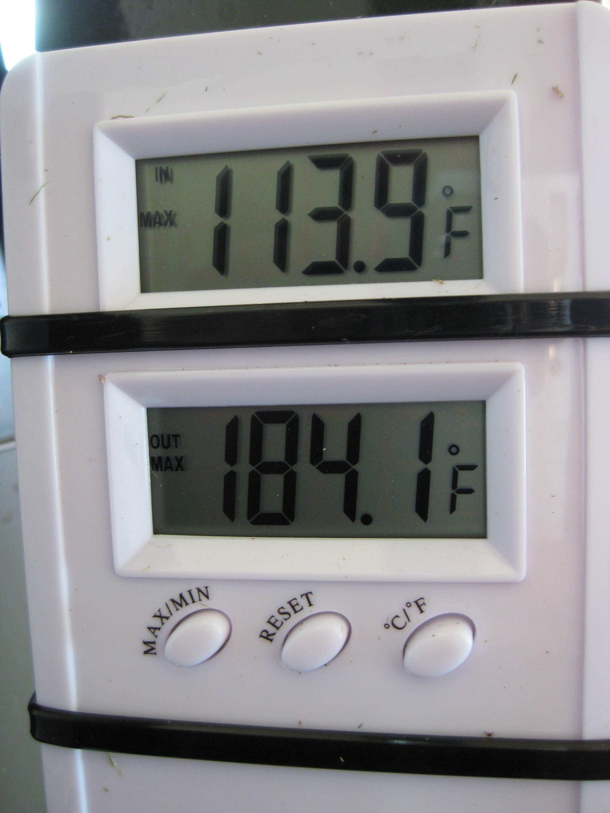

   / Gearbox heat #10
Botton temp is trans after 2 hours cutting ( upper is sun shining on
the built in probe )
