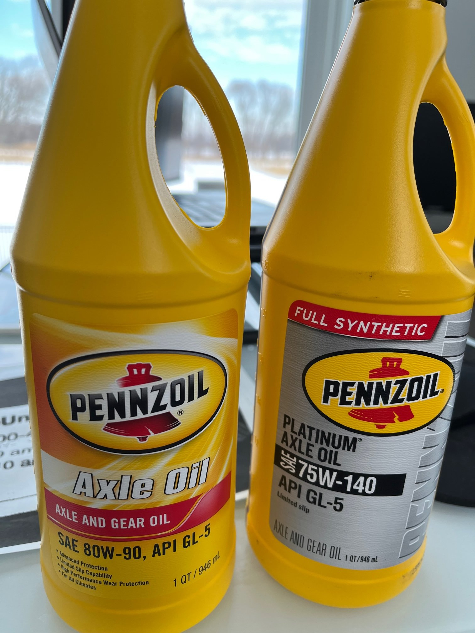

Looking at manual attached for my 6' Tar River tiller, it says gear oil in side and center gearbox. I went to hardware store and got these two bottles. Look like the right stuff? For Side Gearbox says SAE 140W. Will this Penzoil SAE 75W - 140 work? For Center Gearbox, it says SAE 80W - 90, assuming this Penzoil 80W - 90 will work? thank you

I'm sure that's fine. Gear box oils are generally not very fussy choices, as long as they are thick enough, and you have satisfied that requirement perfectly.
In fact, it strikes me as just a bit... fastidious... yes, fastidious of them to call out a lower viscosity grade, once they've already called out a higher viscosity for another gearbox. I mean, seriously, is the oil not going to flow into the spaces it's needed? Is it really going to slow the engine down??? Curious how this lands on others here.

If it was me, I'd buy one or the other and use it in both.

rotary tiller gear box is low RPM, you can use both two type gear oil no problem.

No benefits in this gearbox application for synthetics.
I’d use the cheaper 80-90 or 90 weight.
