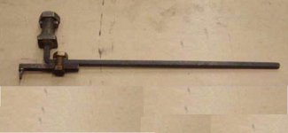

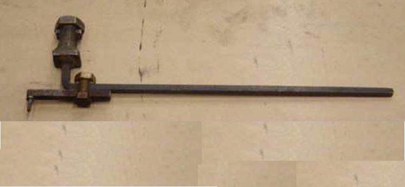

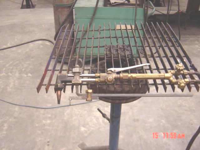

I made this rotating table, and circle attachment for my torch years ago, you can cut some fairly accurate holes with this setup. And if you drill a hole on the opposite side of the circle you want, you don't have to worry about blowing a hole to get started.
