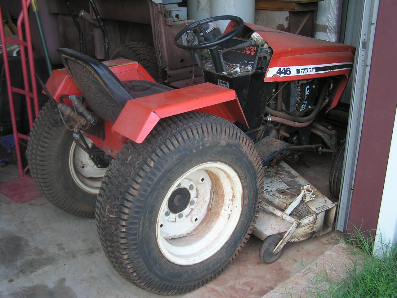

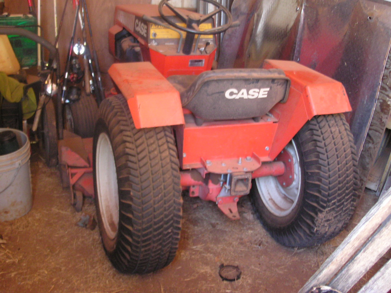

Not always true. Some hydraulic pumps are designed for motor oil.
Like these Case/Ingersoll garden tractors.
If you use hydraulic fluid they will not drive up a hill!

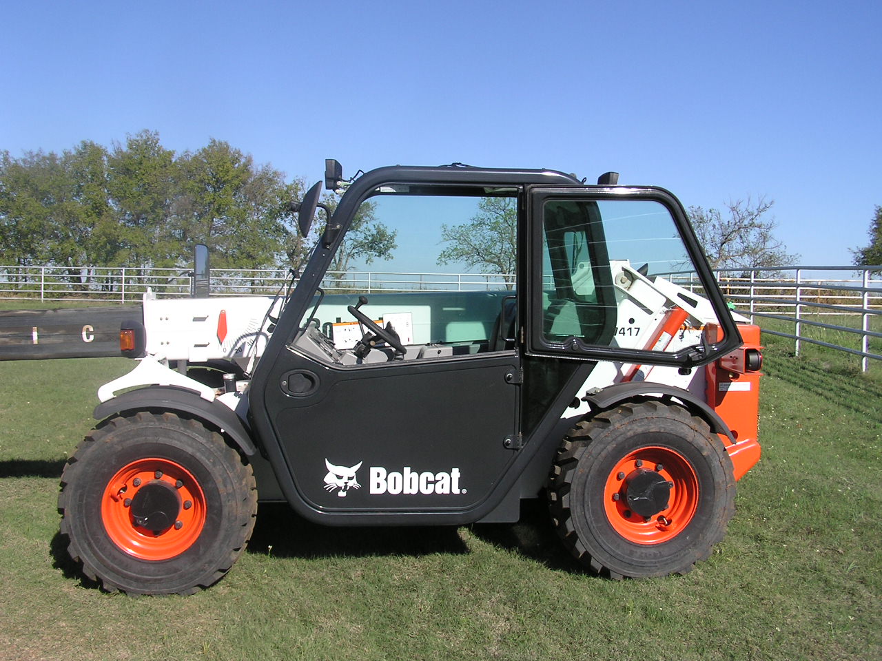

My compact telehandler uses 15w-40 motor oil.
6' wide, 6.5' high and 13' long. Tire size is 14x17.5.
Top speed is 15.5 mph and it will lift over 5,000 pounds!
