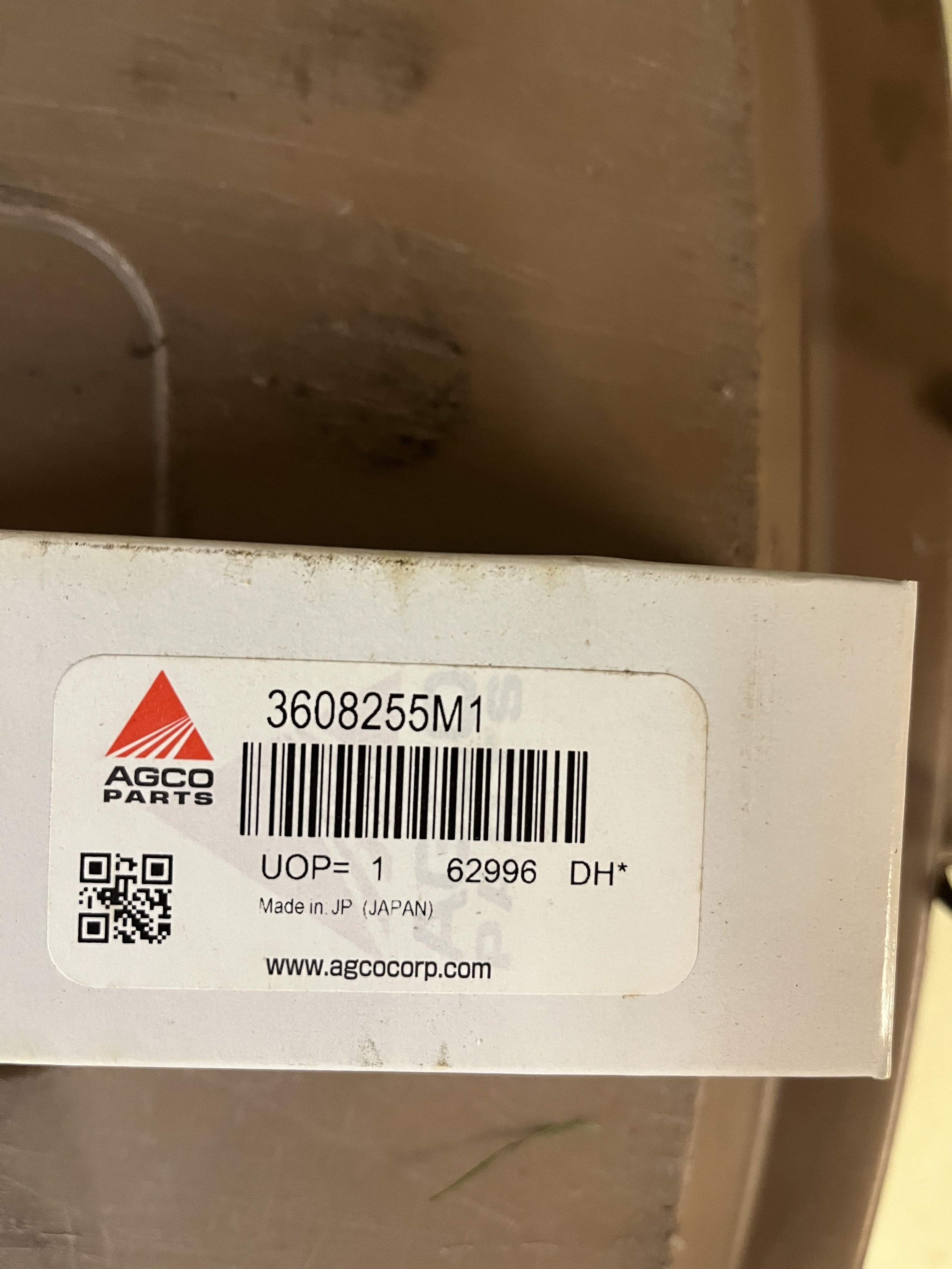

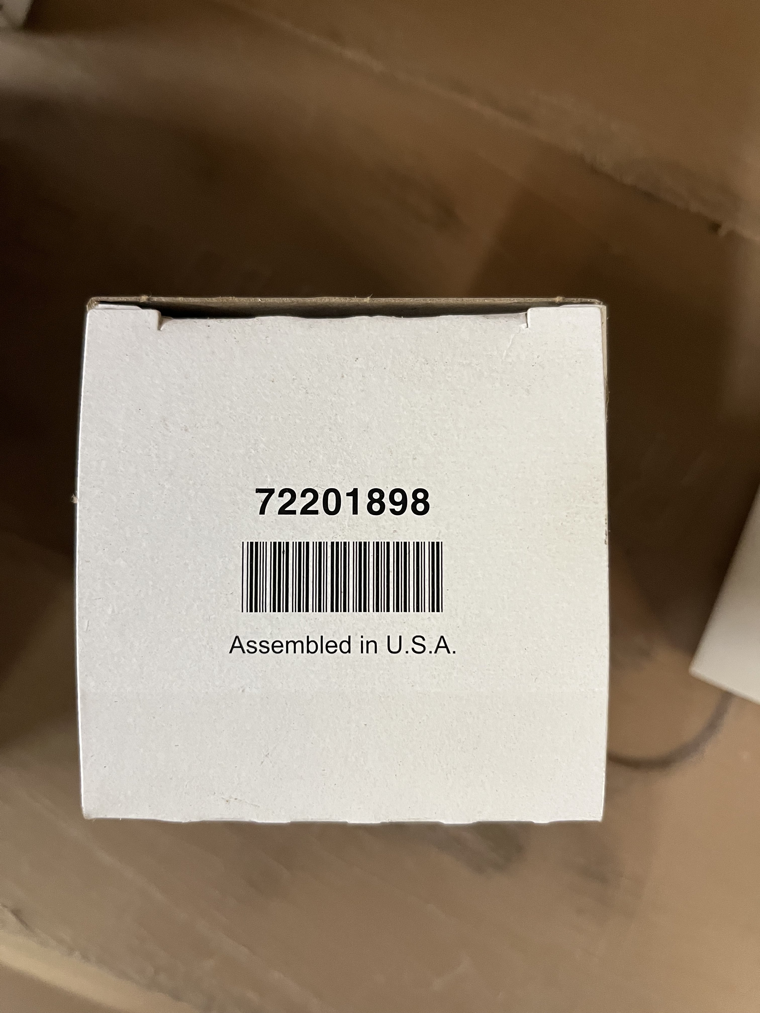

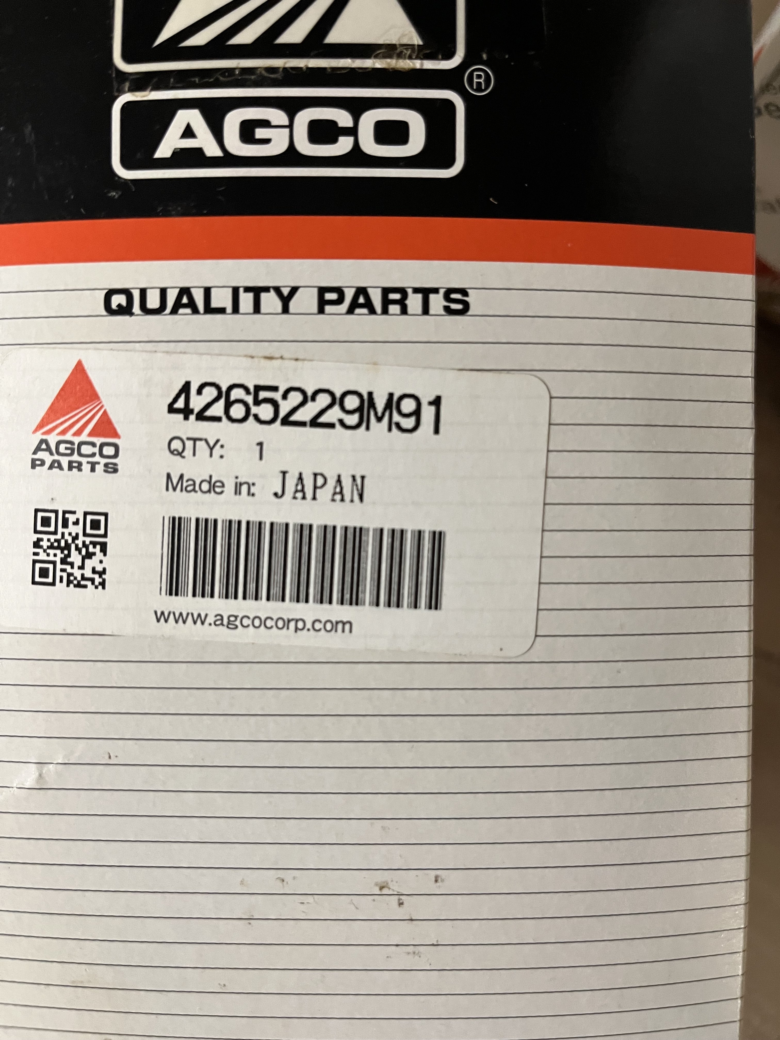

   / GC2610 TLB fluids, filters, etc #2

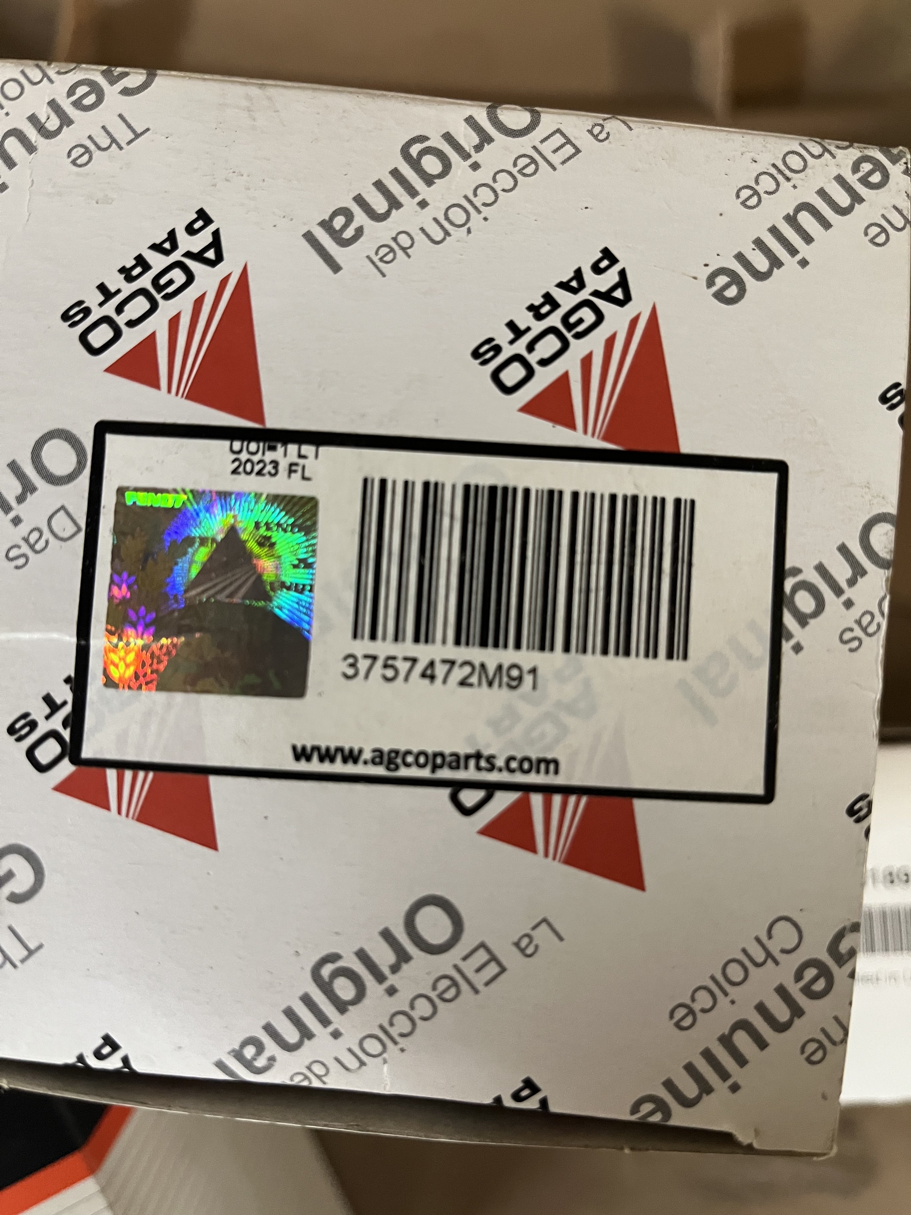

Hope this helps.
Fuel:
Oil
Air
Hydraulic
Mines a 2410 TLB, but the manual is for both 2400,2600,2410,2610
