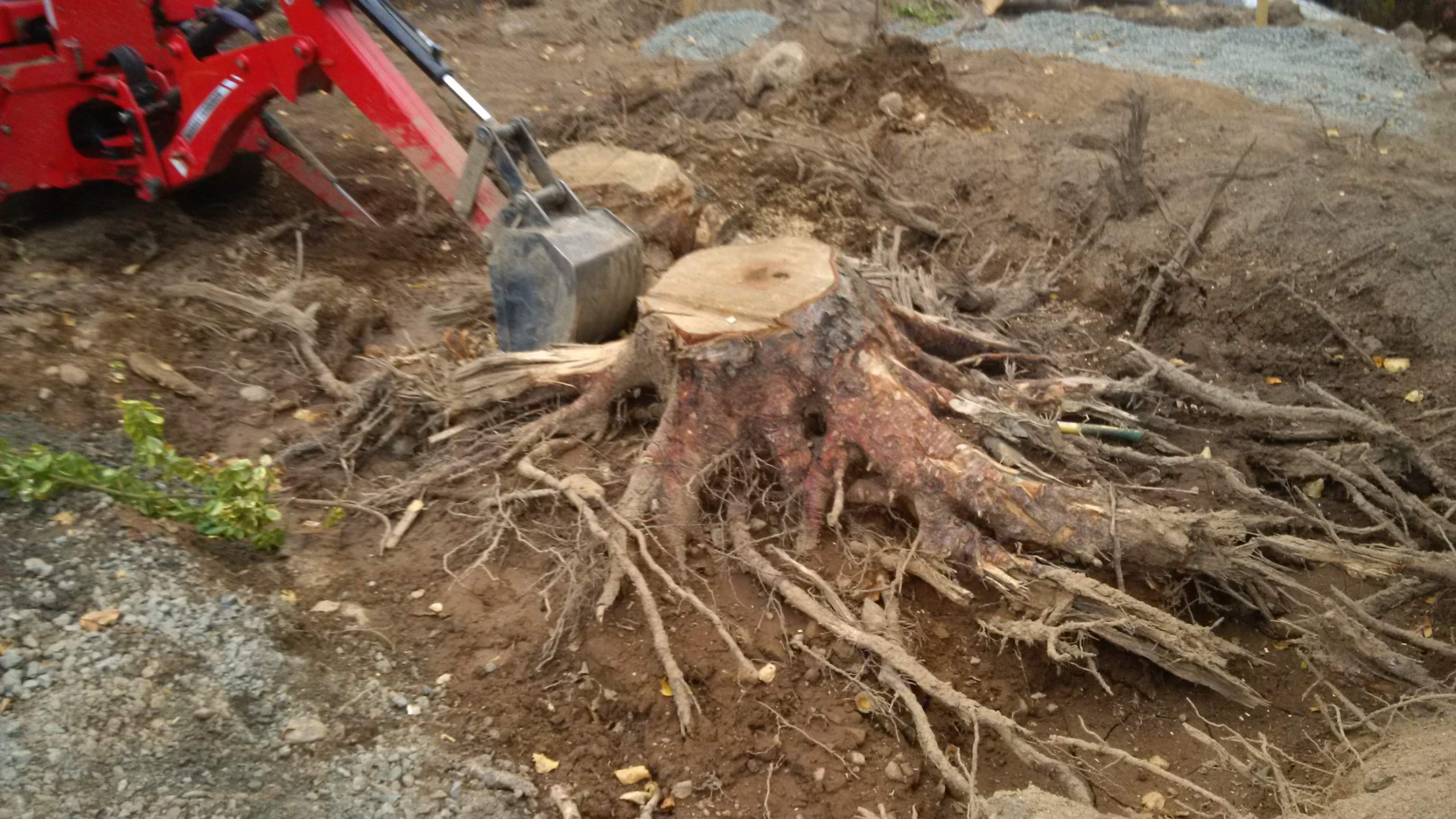

The hydraulic line (with the yellow zip tie) to the backhoe valve burst on me. I went to Princess Auto and got a new line made up that night. Threaded onto the valve underneath the right footboard where the old one was removed. Installed quick coupler onto end of new line and then connected back into backhoe quick coupler, fired up the tractor and then voila NOTHING!
So what did I do wrong? I assumed the new hose would fill itself and the air would cycle through the system and get purged at some kind of air vent on the pump or am I dreaming?
I have since tried it with putting the couplers into 3PH mode with yellow to blue and then red capped to see if that would purge the line but nothing.
Still no movement on the backhoe, the FEL works like it should. Can someone tell me what I am missing. First time tractor owner, not stupid just a newbie. I can be taught I think.
Thanks again,
Glen

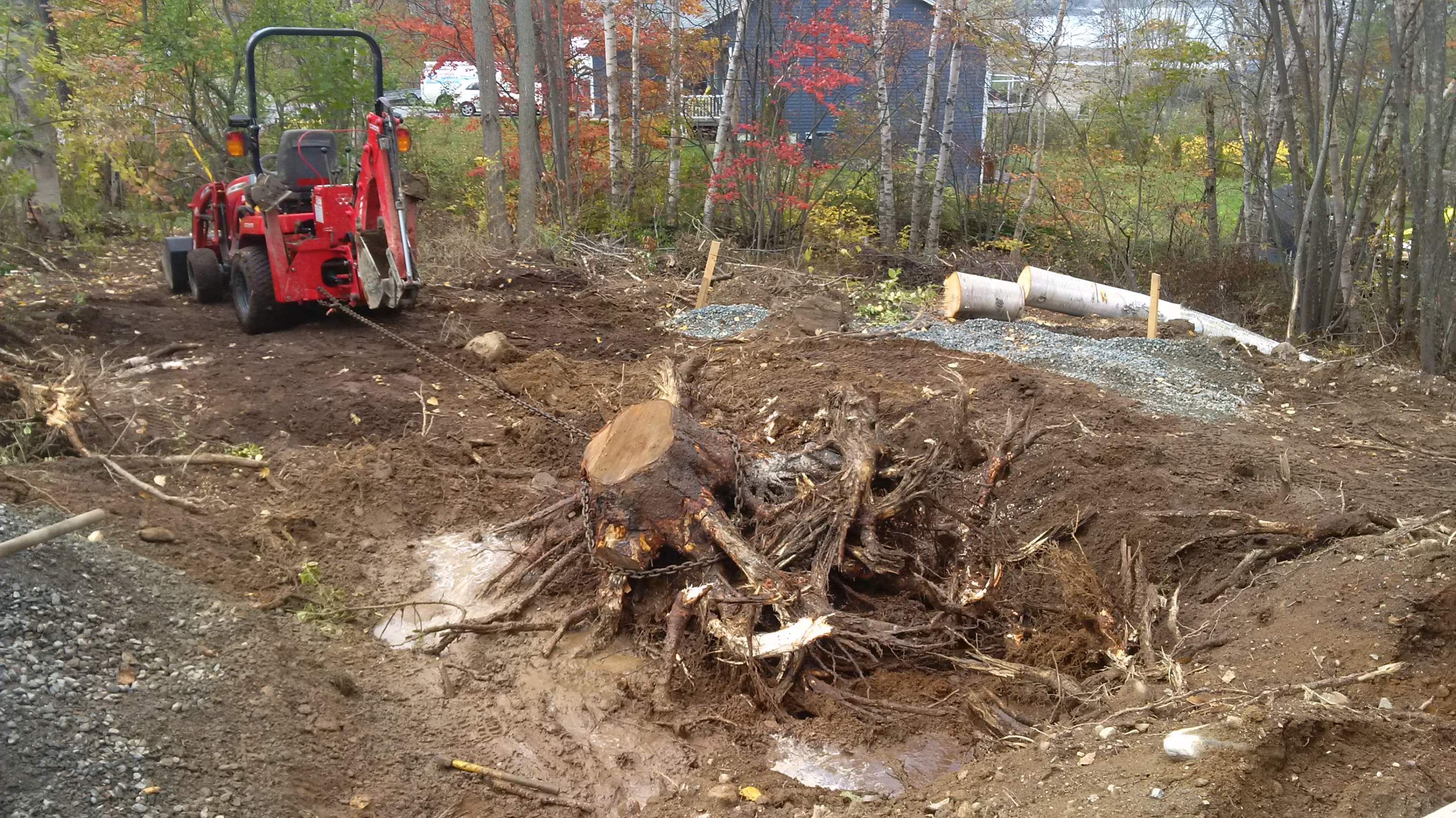

Thanks for the help guys. Got everything up and running and now understand the hydraulic system a little better on the tractor.
Turns out there was debris in the line where I threaded it onto the valve underneath the floor board. Disconnected the line and saw it. Use some compressed air to blow it out through and voila the fluid started flowing.
Was able to finish my tree root project. Now all that is left is when it stops raining to level and compact the new shed foundation.
