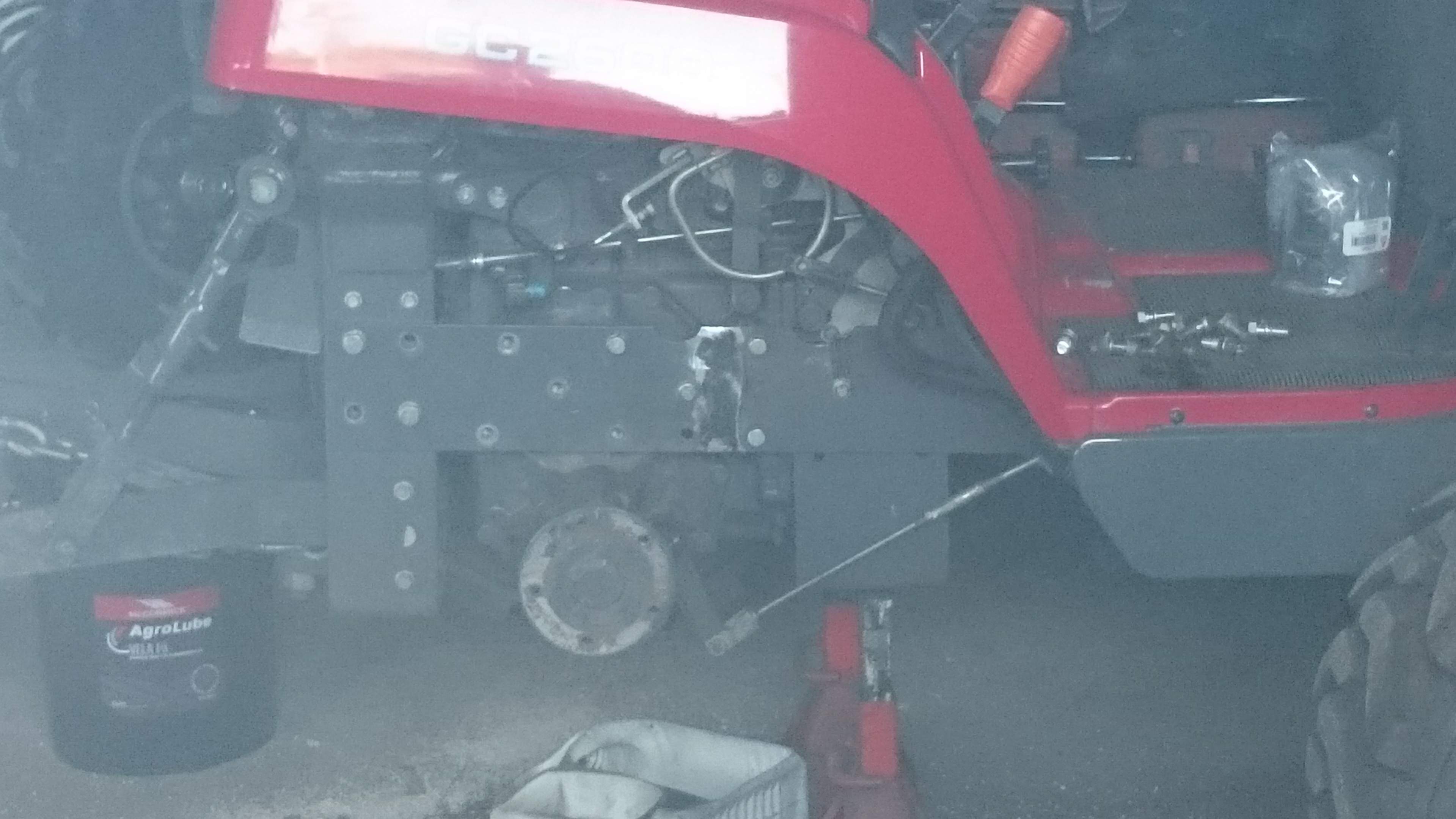

ive had the unit 2 years and have contemplated trading up, but was and still on the fence. i thought id go look at the massey 1734e they had on the lot to get a feel for the size , it was after hours so i figured i could take my time and really look it over,
but when i showed up i noticed a lot of tractors missing off the lot, so i peeked in the bay door window to see if it was inside , but it wasn't, in this process i seen my little gc tractor and what looks like a frame repair , which i found odd, it was grind-ed smooth , right away i knew they cut the last section out of the frame to drop the tranny down with out removing tank fenders etc etc , and than welded it back up after the repair was done..... that is when i posted my original post
so the next day i went it first thing in the morning to ask about the job and why they did it that way , i was told he had a welder do it and its as good as knew, i expressed how i wasnt satisfied , he didnt try to hide anything or lie but offered to make a new side ,change that side of the frame which would leave the tractor back at the shop for weeks, so he offered to fab a plate up to connect also,it would go on with the bolt holes to add support .while stressing the fact he doesnt think its needed but would if i wanted it , which i said yes too,
but after spending a few days really thinking and talking to people im still very unsure about this, and no matter who i talk to, i get the same reply "i would be pissed, if it was mine" well im not much of the yelling cursing type so im trying to think of the right approach to finding a solution , i also believe they think this is a good job and nothing wrong was done, he didn't try to lie to me or cover it up once asked, but i feel that if i didn't stumble on to it, i wouldn't of been told either ..
ive added a picture i took through the window, its not clear but maybe its enough for you guys to tell me if i am over reacting or i have a right to get this resolved tractor welds.jpgtractor welds.jpgtractor welds.jpg

Has it been welded up on the INSIDE as well? Was weld primed on BOTH sides or just the out side? Ask MF directly (not the dealer)what the official repair procedure is. Personally I don't like it - at all.
   / gc2600 repair options #6
I would not worry if it's a good weld or anything to do with that work. I wouldn't let it come home. I would call MF ask them to get in to this. I don't like this also.
   / gc2600 repair options #7
I'm more concermed now than when I replied before:
1. In part of your post you said the dealer didn't even know if it was cocered under warranry or not . . But I didn't hear you say you got a definite "yes it is" type of answer. So is it covered oor is he going to be presenting you with a big bill?
2. I have a gc1715. But I understand the warranty on a gc2600 series (any of the pre gc1700 series) is shorter than mine is (Agco changed warranty lengths). And I know the warranty lengths are different for drivetrains vs. Ither items. So what dies ir mean when you cut the frame . . That isn't drive train.
3. The pictures of your frame look similar to my frame . . Lots of bolts holding the frame and items together. So why did it need to be cut and then welded when there are bolts . . Would be a question.
4. I don't think either you or I can determine how apprpriate this process is/was. So I'm back to the idea you need an informed procedural opinion. The 2 ways you get it are talking to another dealer or talking to a field rep for Massey.
5. Lastly . . a dealer gets paid to do warranty work by Massey . . So I get nervous when he tells you he can't afford to lose money on doing the work . . . its like as if he'll do the work and then find out who he will collect from.
I don't like sounding pessimistic . . but I'm not getting a warm and fuzzy feeling about any part of the situation. I'd be doing some question and answer from other sources. Remember . . It doesn't take yelling snd swearing to be convincing and get results.
