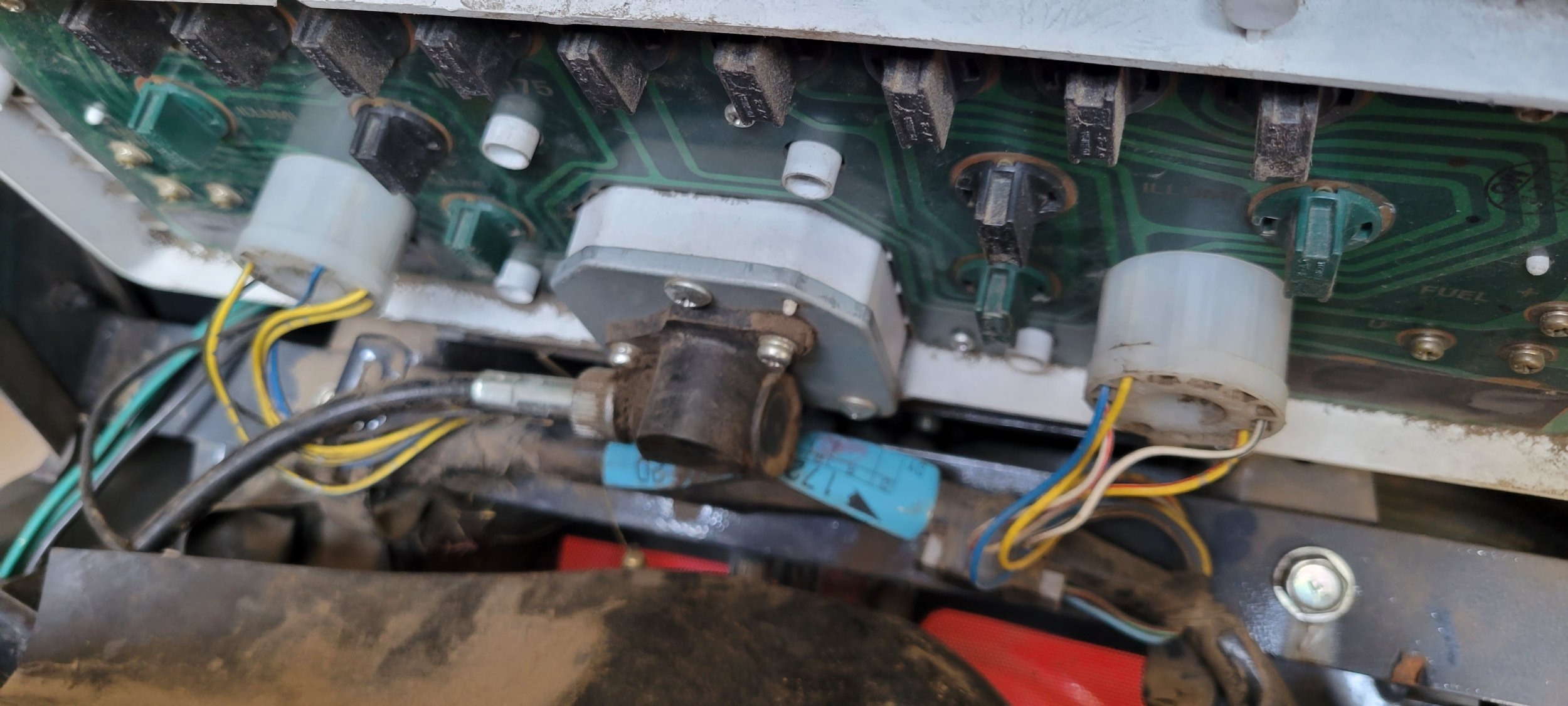

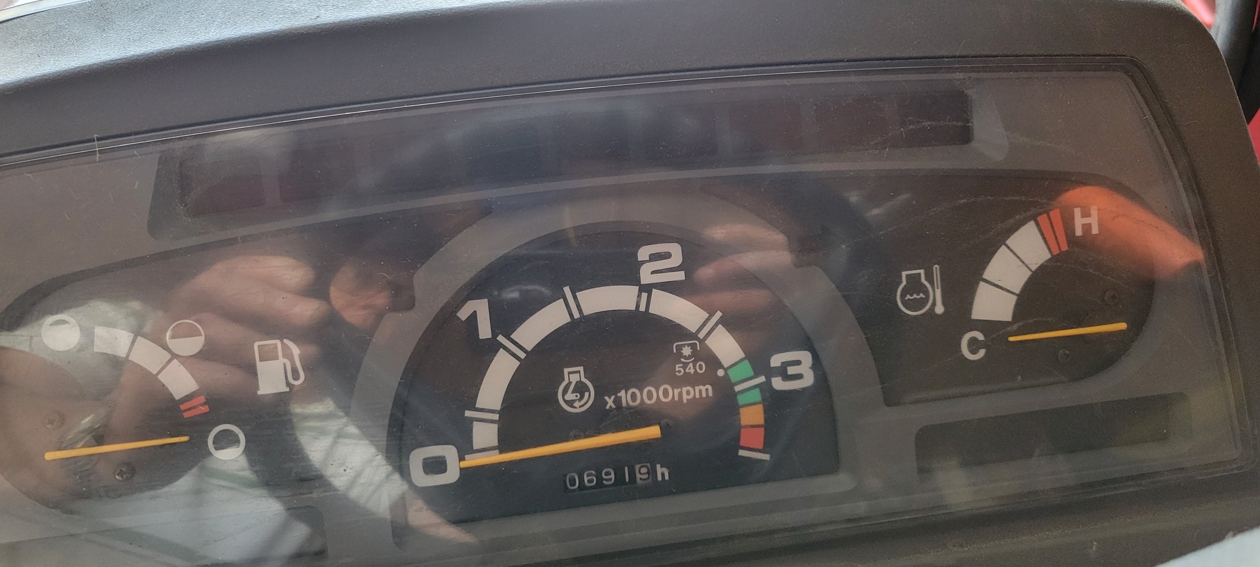

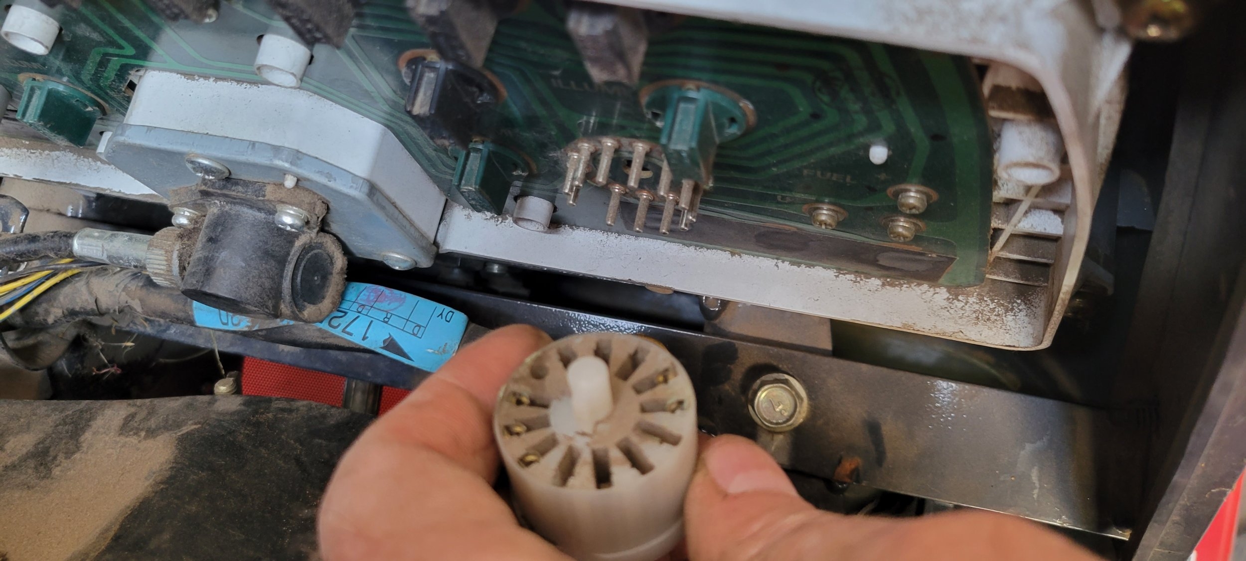

Massey GC600
Tractor runs tractor starts no issues operating at all just my entire instrument cluster, tachometer, fuel gauge, temperature sensor Etc all were dead. Lights work at all fuses worked and checked out okay. Resolution? Remove the dashboard connectors blow them out and reconnect them. Fixed! 11 years of dust finally caught up to . Photos attached
