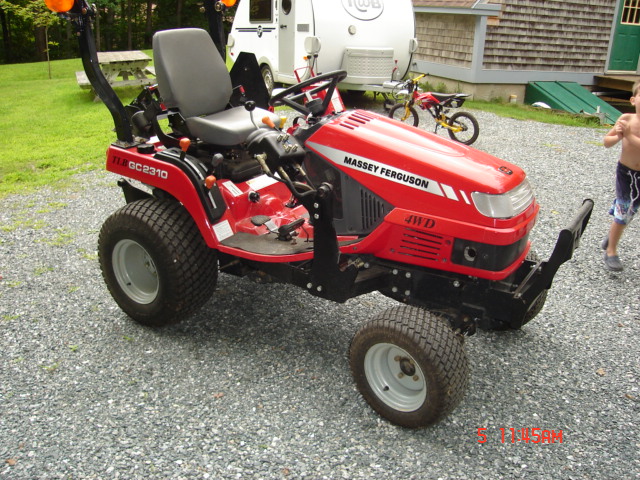

Ray- I sent a PM to you. In looking throught the MMM manual, it doesn't specifically say so, but I do believe (see tx2310's first post above) the 3PH has to be free to move up & down with the mower deck, regardless of whether anything's hooked up to it or not. (BH off, of course.)
Again, if the lower speed control knob isn't open, the hydraulics won't operate for lifting. In the pic below (experimenting last summer), you can see the knob on the right side of my tractor, poking out from the transmission area between the two white safety stickers under the seat.
Please post some pics of your set-up-- I'd like to see your bagger system!

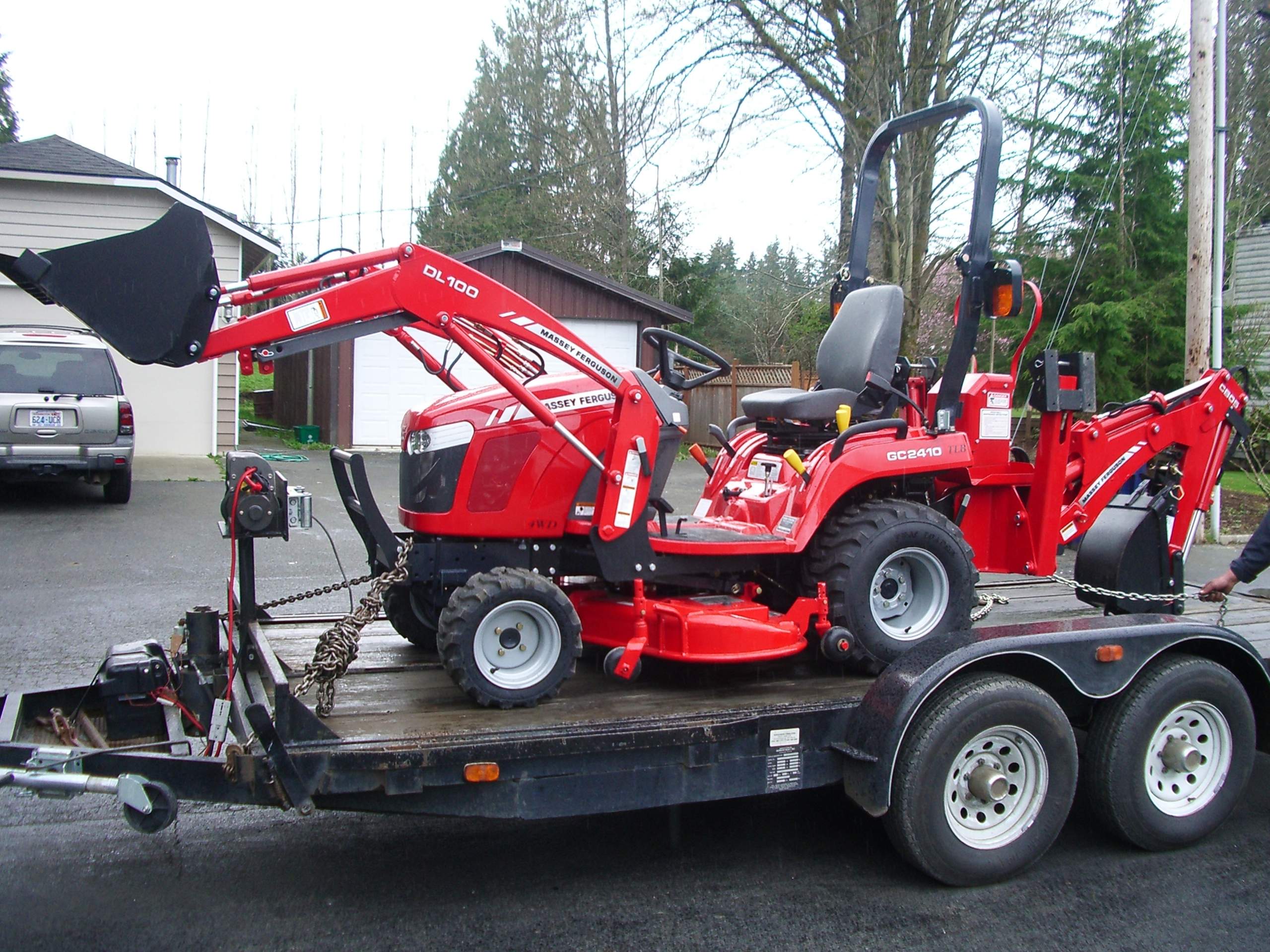

I sort of figured out my problem with raising and lower my mower deck. Your 3 point arms have to be able to go up and down . With nothing attached to my 3 point the mower deck raises and lowers with the hydraulic lever. When I attach my humbolt bagger system the 3 point arms hold the frame of the bagger system and it held in place by bracket and pin. This stops the 3 point from being able to go up and down, that causes the mower deck also not to be able to go up and down, so the only way to raise and lower with the bagger on is to use the mower cut height adjustment knob the black one between your legs. You have to turn knob with one hand and pull and raise with the other, kind of a pain as you know the deck is not light. I was reading the manual on my mower deck and there is a linkage adjustment you have to do before you put on your mower. Dealer said they did it but I checked it and it was off. It says to to lift your linkage to the highest postion with your hyd lever. Turn off tractor, check the clearance between the stop pin. The clearance on the left side should be 5-7 mm (0.2-0.3 in) and on the right 0-2 mm (0-1 in) before the linkage bar hits the stop pin. You only have to make this adjustment once. One other thing I found out when I attach my power take off for the my bagger system. You have to rotate the pto cover, its held in place by four 10mm bolts. When I use my bagger system or any other rear pto implament you rotate horizantal and tighten all four bolts. But when I have the back hoe on the 3 point arms won't go far enough back to leave room for the back hoe. So you remove the 2 outside bolts rotate the pto cover slighlty vertical. This gives you room to store the arms and secure with bungee cord. I just screw and tighten the 2 bolts I removed back in the hole so there i don't loose them. Live and learn. Also I had to loosen and rotate my red hydraulic line to the back hoe. When I would rotate the pto cover it would cut the line and stop the cover from rotating. The dealer is sending me a new red hydraulic line. I pointed hyd line down at the connection on the tractor, it was coming strait out and in a very bad poistion, I would check yours.....Thanks for reading Ray........

Nice an' shiny! I could have told you about the PTO cover thing... don't know about yours, but mine is REALLY tight- have to use a pry bar to swing it down, even with bolts loosened. May have to do a bit of creative bending...:rolleyes:
Tried my mower for the first time today-- I'll start a thread on it, but nothing short of amazing, in my opinion!
Glad to see you got it figured out; it's unfortunate that the bagger prevents proper lift & drop of 3PH for mower use. Do you see any way around the bagger's (current) mounting set-up?
   / Gc2410tlb mmm raise and lower #8
Very nice machine!:cool: That trailer makes a perfect pair.
