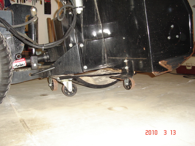

If you have a smooth, hard floor... I use a few of those steel 4-wheel car dollies for use under the tires. Works very well for me, both for the blower and other heavy things. I keep the quick-hitch sub-frame business on a separate dolly.
Those dollies --a set of 4-- can be had from Northern Tool pretty reasonably when they're on sale.
  • dolly:wood.JPG
