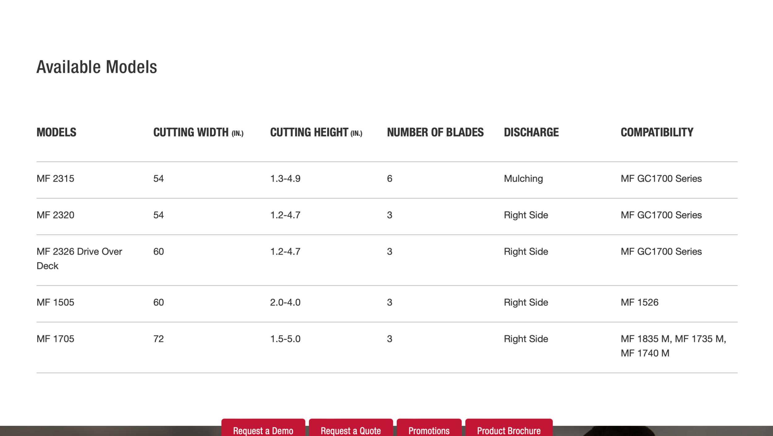

Update -- just looked on the M-F site -- Nope, looks like they've superseded the 2325 with newer models -- but just Googling "2325 Mower" turned up a number of them available at several places (I assume used).

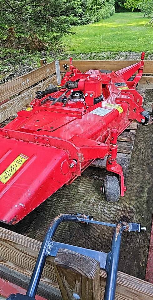

   / GC2410 Is There a Mid Mount Mower Option Still? #7
Wow, prices...! I think I paid $1500 for mine, used, but with only about 6 hrs of use on it -- still looked shiny & new. But that was back in 2009.....
