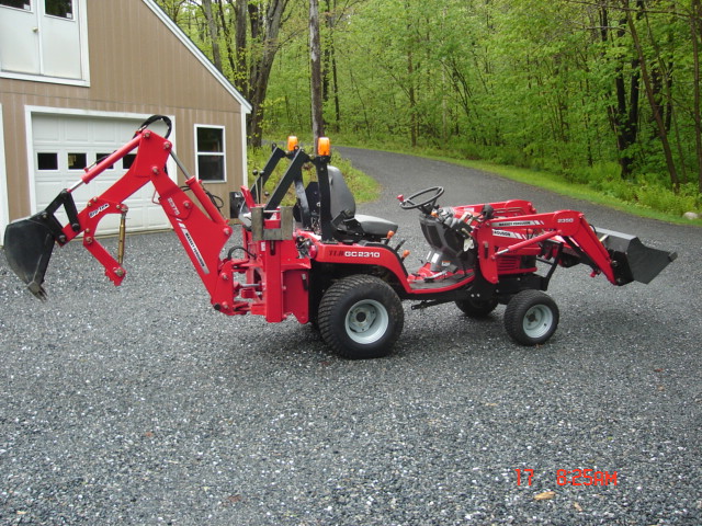

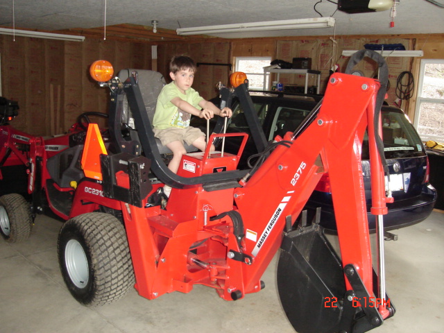

I guess I hadn't noticed the issue on the 2410-- you mean it's different than the 2310? On mine, I just leave the side stabilizers not quite all the way up, and the ROPS just folds down and rests against the BH controls "console." I just put some sort of padding between the two. When the ROPS doesn't need to be up, it just sits there....
Putting the ROPS up is a one-person job, only two hands required. How's the 2410 different?
