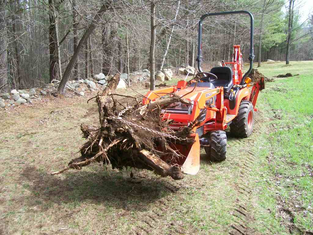

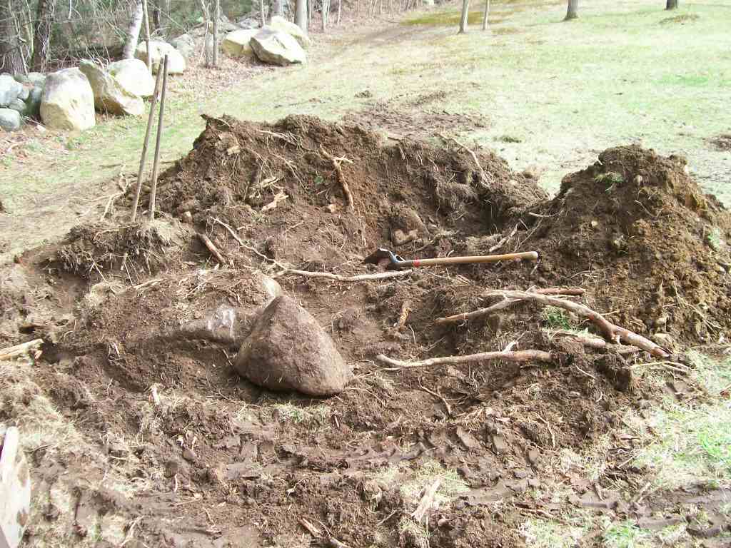

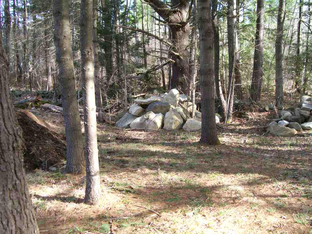

After my experience with the BX22 I think you might end up wanting a little more. That is hard to say without seeing your projects though. Attached are a couple of pictures that I feel represent the maximum capabilities (without stressing the machine too much) of tractors the size of a CG2310, BX, 2305, etc. The rocks in the pile were carried there in the BX loader, the rocks against the stone wall in the battlefield picture had to be rolled / pushed there, and couldn't be lifted with the loader. Hope this helps you get some idea about the capabilities of tractors this size.
A Mahindra 2015 with BH, or Kioti CK20 would perhaps not be too much more money, but would be perhaps better for your jobs.
