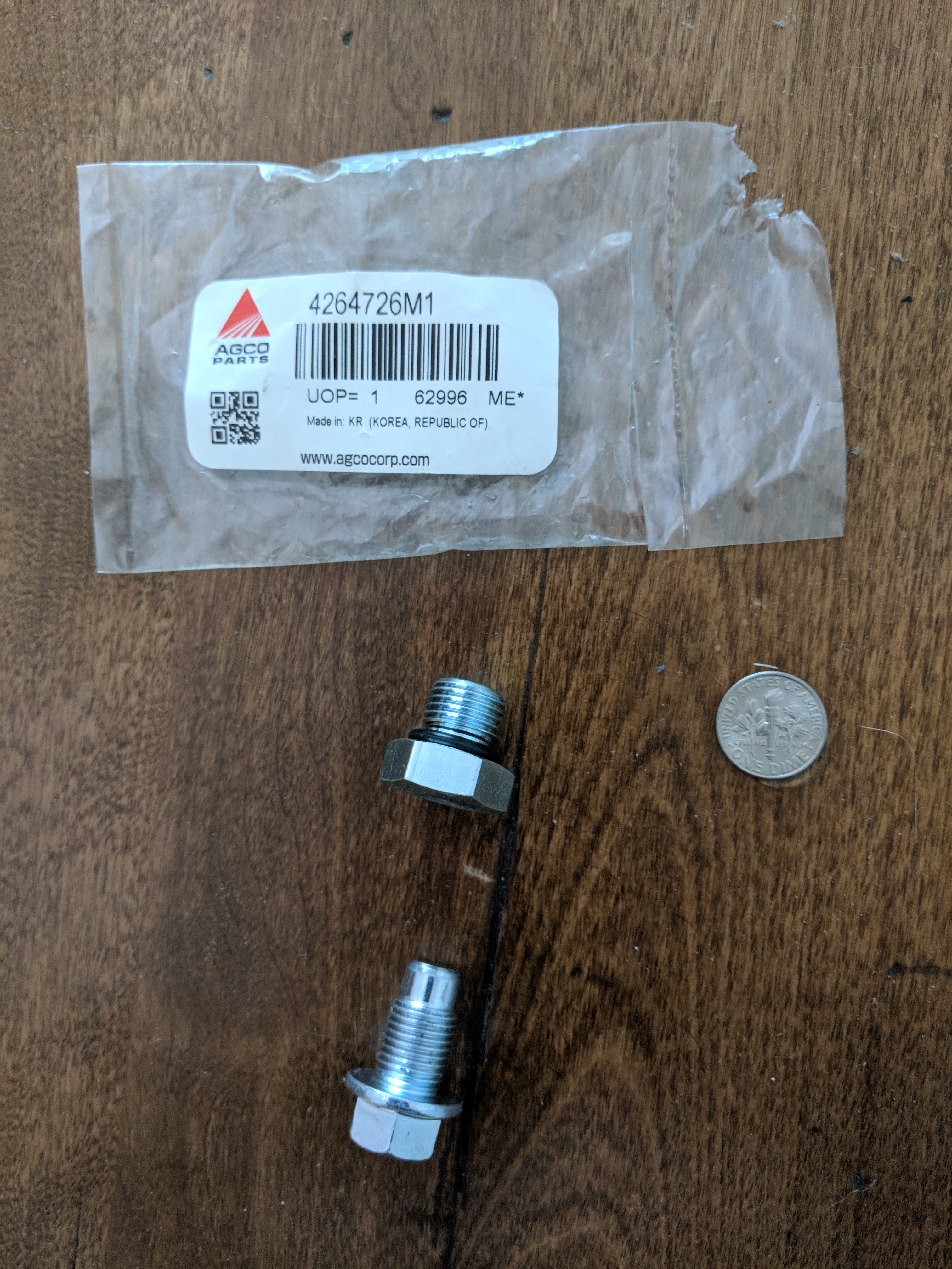

Could anyone please tell me what the thread is on the drain plug at the bottom of right rear axle housing?
I have decided it is size M12 but I have tried x1.0, x1.5, and x1.75 threads and none of them seem to snug up enough for a pressure seal. Four weeks wait at Jack's and none of my local dealers keep any stock. MF #4264726M1

Bummer! I see where the parts manual gives no specs, just says "Plug". Real helpful. I do see where it doesn't use a copper or aluminum washer, either. Have you tried US threads? That's horrible to have to wait FOUR weeks for a plug!!
   / GC2310 transaxle drain plug sizing #5
I had to clean my female drain threads up and took the plug somewhere. Gave me a tap that says G1/4 x 19. I lost the post it note that says the size of the plug threads but pretty sure it was British pipe threads- Tap fit perfect. GC2410

Thanks, Dale! Funny you should mention that ... if you do a Google search on 4264726M1 two of the very few hits are in the U.K. A British transaxle on Japanese tractor sold in the U.S.? Go figure!
In frustration, I started an expanding circle search, calling MF dealers further and further away. One fellow on the parts desk in Williamston, NC must have sensed a challenge because he kept me on the line and said he was checking on the parts locator. I did not know MF had such a thing. The fellow did not have any stock, but he said he found some inventory in Illinois, and one in Connecticut.
BIG THANK YOU to Big Boys Toys in Pomfret Center, CT!! Talked to them Tuesday, and Brown Santa supposed to deliver tomorrow. You can bet your bippy I am going to measure and spec that thing six ways from Sunday before I fill up with Rotella again.

Here is part which arrived today. Below is M12x1.25 plug from auto supply store which was closest I found. The MF part is definitely NOT M14, M12, or M10. When I returned the plug counter guy said "Looks like 1/2 x 20." Have not checked that yet but I'll be astonished if it turns out to be SAE and not Metric. Oh, well ... back in service now.
There is no crush washer for the axle housing. The threaded hole has a shoulder machined in to squish the O-ring.
