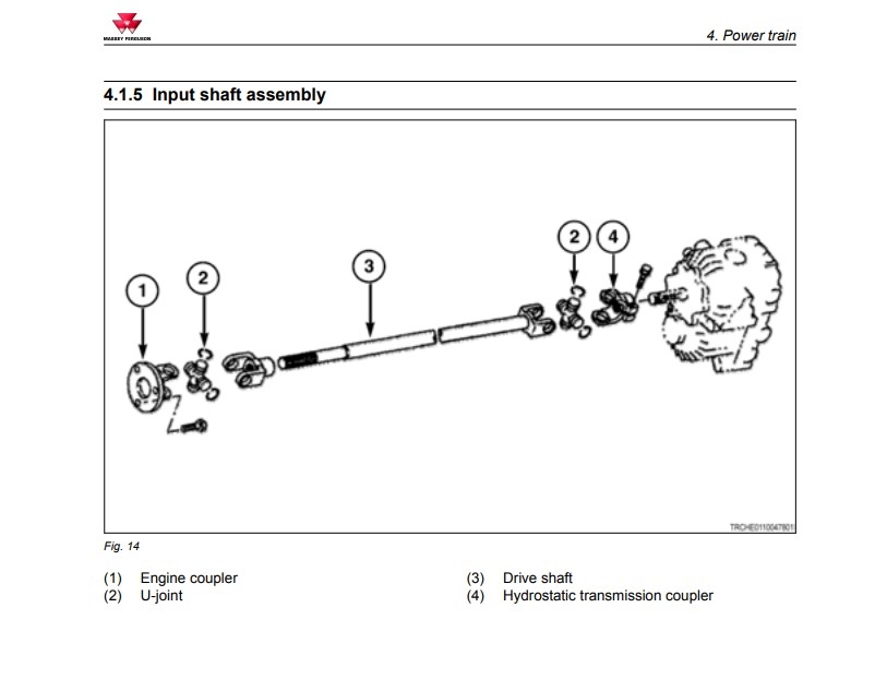

Quick and dirty test of hydraulics/pump would be to put a gauge into one of the quick connects for the FEL and dead head the control valve long enough to get gauge reading.... Think pressure should be about 1900PSI...
Scroll down to " Hydraulic Pressure Test Gauge"....
IF your 2310 is similar to the 1700 series....And as for replacing FAN, check to see if you have splines on drive shaft at engine connection, if so you should be able to unbolt driveline at engine and pull it off spline connection on HST....

"And as for replacing FAN, check to see if you have splines on drive shaft at engine connection"
Yes, the engine end of the drive shaft yoke has a spline. Unfortunately the spline is quite rusted together. I actually cut the drive shaft in half with a cut-off wheel to get it out. I've heated the yoke end of the spline with a torch, applied a LOT of PB blaster, beat on it with a brass hammer and it will not budge. At this point I'm going to probably try to get a replacement U-joint and get a shop with a powerful press to push the spline out of the yoke.
