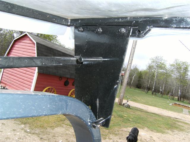

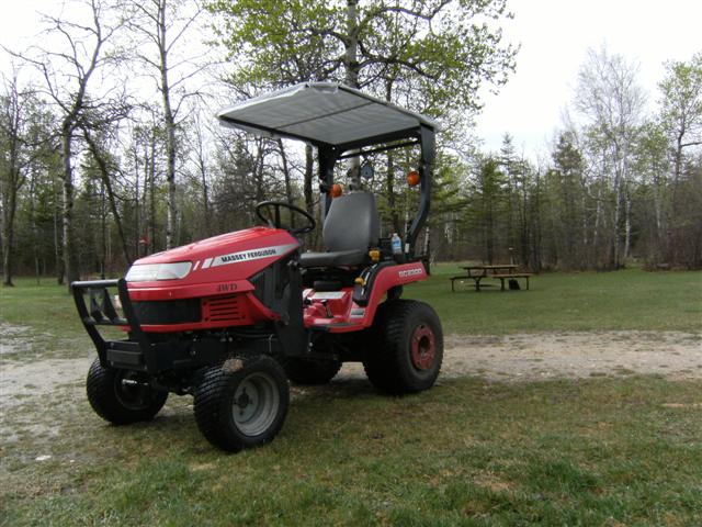

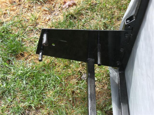

Built this easy on and off sunshade for my MF gc2300 last summer shortly after getting the tractor.Have always had a sunshade on my MF 1655 so built on for the gc2300.I made it out of 1"x1" square tubing and a bit of 1/8" plate and some short 1/2" round rod.Here's pictures of what it looks like and how it fits etc: Due to the way my rops is mine is 39" wide and 52" long with the front corners on a 45 degree angle just so it doesn't look so boxy.I used common grey/silver tarp for the cover.Its very easy to put on and take off no tools required,as it just slips onto the ROPS and the two lower pins sit on the hindge part of the ROPS.The pin higher up keeps it from tipping to the back and the 1"x1" sq tubing along the back keeps if from tipping forward.It sit's 3" back of the back of the ROPS.Due to my ROPS being the way it is this works for mine.Larry:thumbsup:
