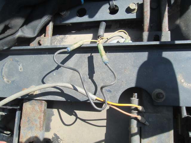

But..(b) anyone know exactly "how" to bypass the seat switch...which wires, etc to connect...relatively permanently...so I can bypass that part of the problem? (and I am aware of the safety issue involved).

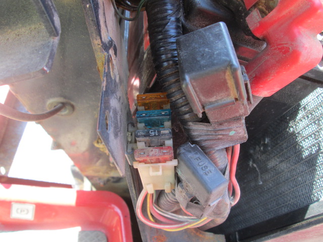

Check the 5 amp fuse in the fusebox. Should be the innermost of the 4 fuses. Mine blew a month ago, replaced the fuse, shuts down fine now.

The fuse box is easily accessed be removing the cover under the throttle on the right side. The 5amp (orange) fuse on the inside operates the fuel shutoff.

A piece of wire with crimped fittings on the end. Just disconnect the seat safety switch and insert. It renders the safety switch inoperable, but I have had to do it to run a woodchipper.

DMW, thanks for the great pics & explanation! I also have a seat switch by-pass (mine uses spade terminals), but I didn't know about the fuel shut-off "button." Thanks!! :thumbsup:
