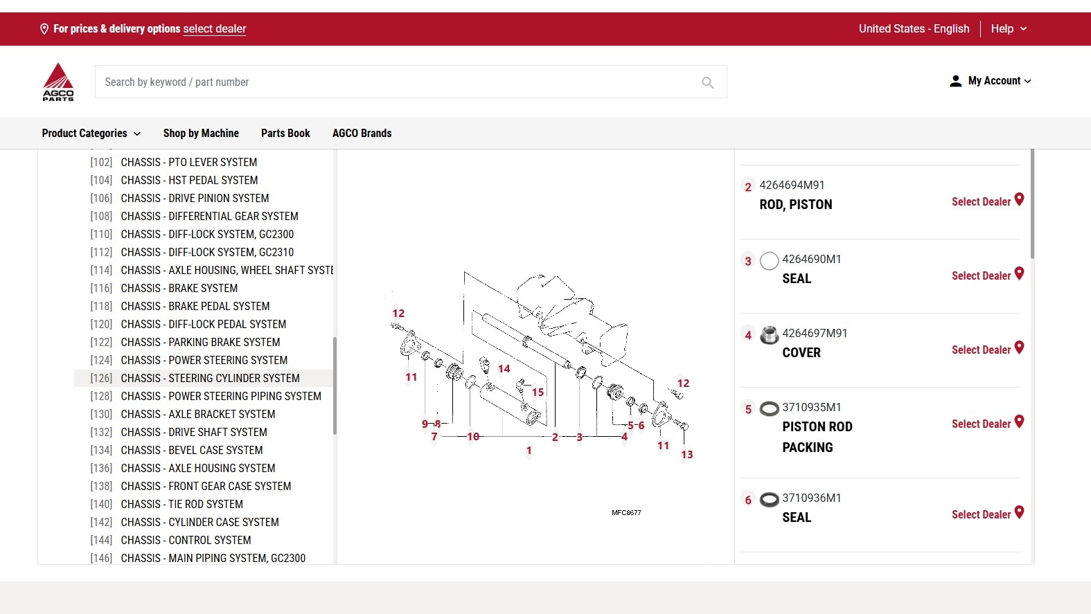

I have a GC2300 (Ser# JPA24542) that started spraying fluid out of the steering cylinder. I have removed the cylinder and disassembled it and was very happy to see the bore looks like a mirror ! So I'm going to rebuild it and need the end cap seals and the center piston seal. The numbers I got from a post here from "ronvera" says the seal numbers for the end caps are "four seals PN 3710935M1 and one one ring PN 4264755M1" Thanks ronvera ! But, why just one 4264755M1 ??
Can someone tell me the seal number for the center piston and where is best to order online from ?
   / GC2300 Steering Cylinder Seals #2
Per parts book (note section 126)......
Got it, thank you !
I'll print that schematic, highlight the numbers and call a dealer and ask for every seal listed for that cylinder.
