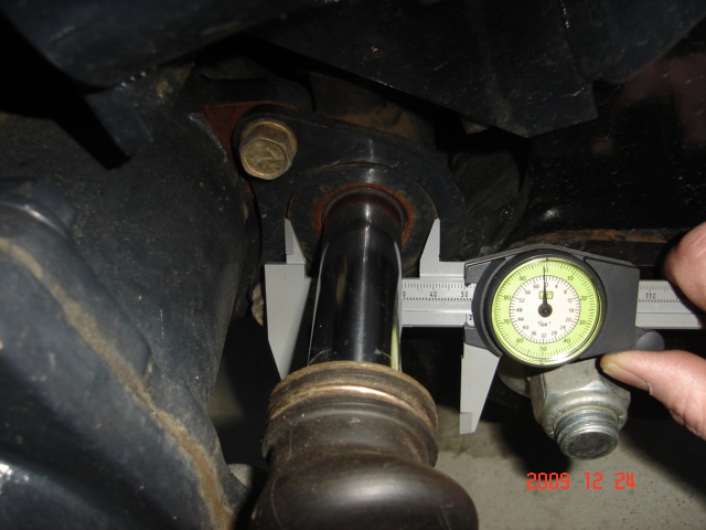

If this helps, Larry, I get just a tad less than 2" ID on the hole in the plate.
Sorry the flash didn't pick it up better.... but the tips of the calipers are centered on the hole.
I had to run out and measure mine and sure enough its just under 2" ID as well.So Next thing will be to take the plate off and measure the [nut] on the end of the cylinder.Right now its snowing and were supposed to be in for some rough weather so don't want to do anything except blow some snow this winter as this will be my first time using this tractor to do so.As always Larry .
