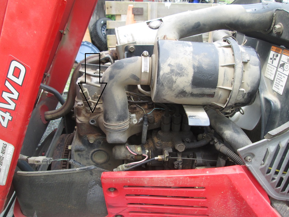

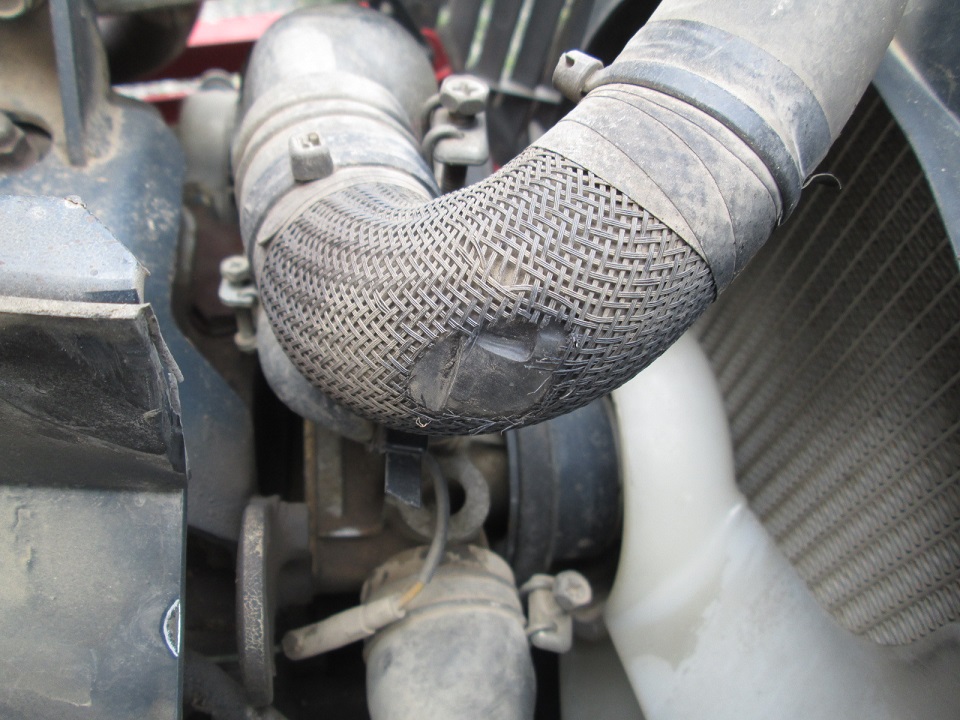

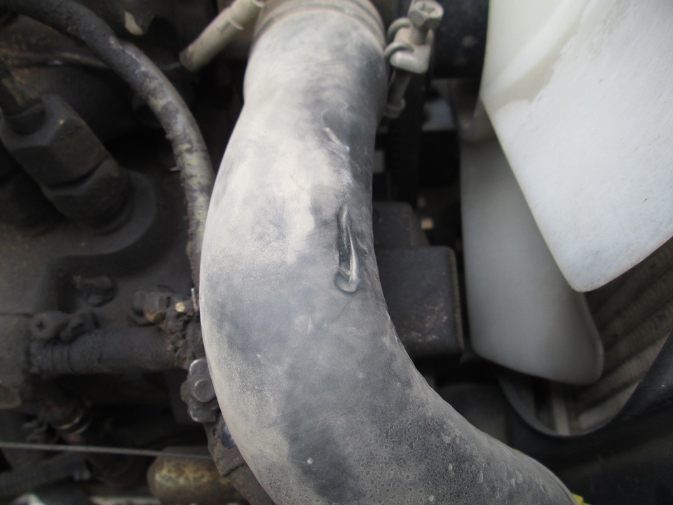

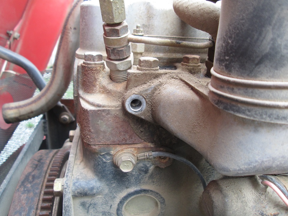

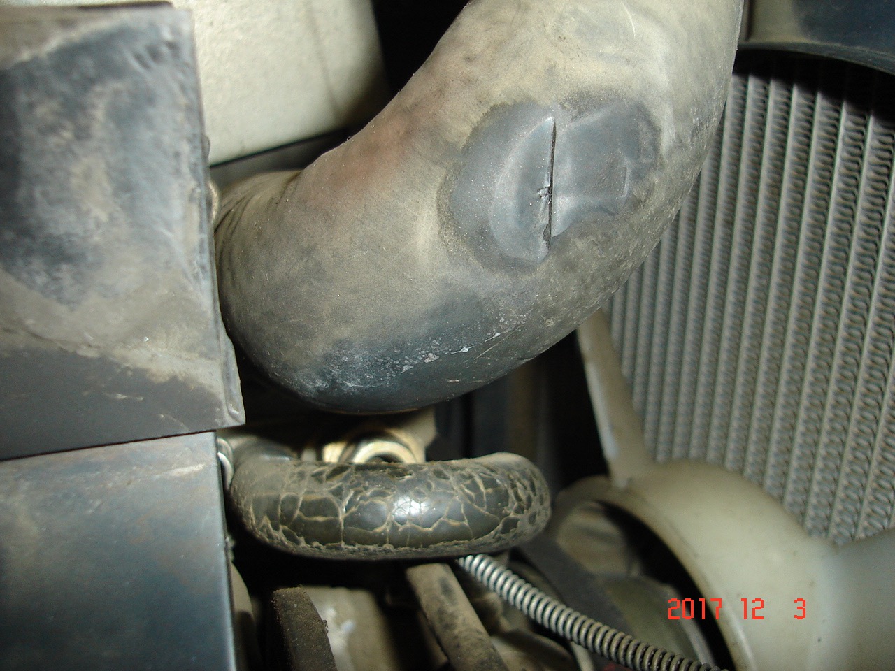

Had an issue with the tractor turning over, catching, then almost immediately stalling. Suspected the fuel filter, changed it out, still had the issue. Found that it was the ignition key switch. If the key was jiggled in the ignition, it would shut it down, without being moved from the "ON" postilion. It was changed out last year due to corrosion on the original. Tightened up the dash nut a little, seemed to help.

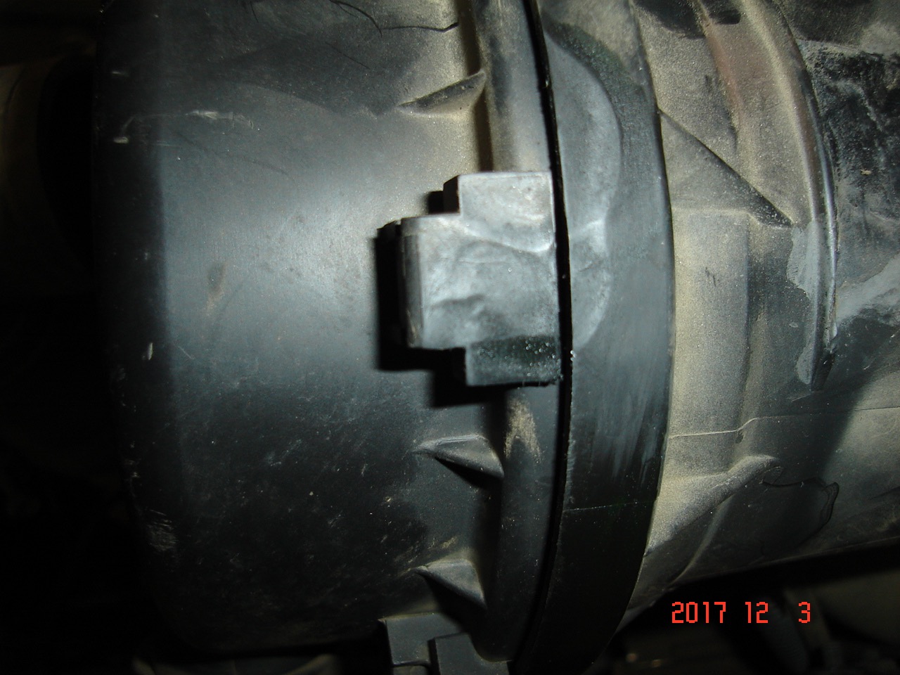

Unrelated but still interesting. Looked over the engine for rodent damage, found an intake manifold bolt missing, and the air filter housing has bee cutting grooves into the radiator hoses.
On your first picture, the air filter housing metal clamp looks like it is against the radiator hose.
I would loosen the hose clamp at the other end of the air filter housing and rotate it so it's not touching the hose.
You could also add apiece of slit hose over the radiator hose for protection.

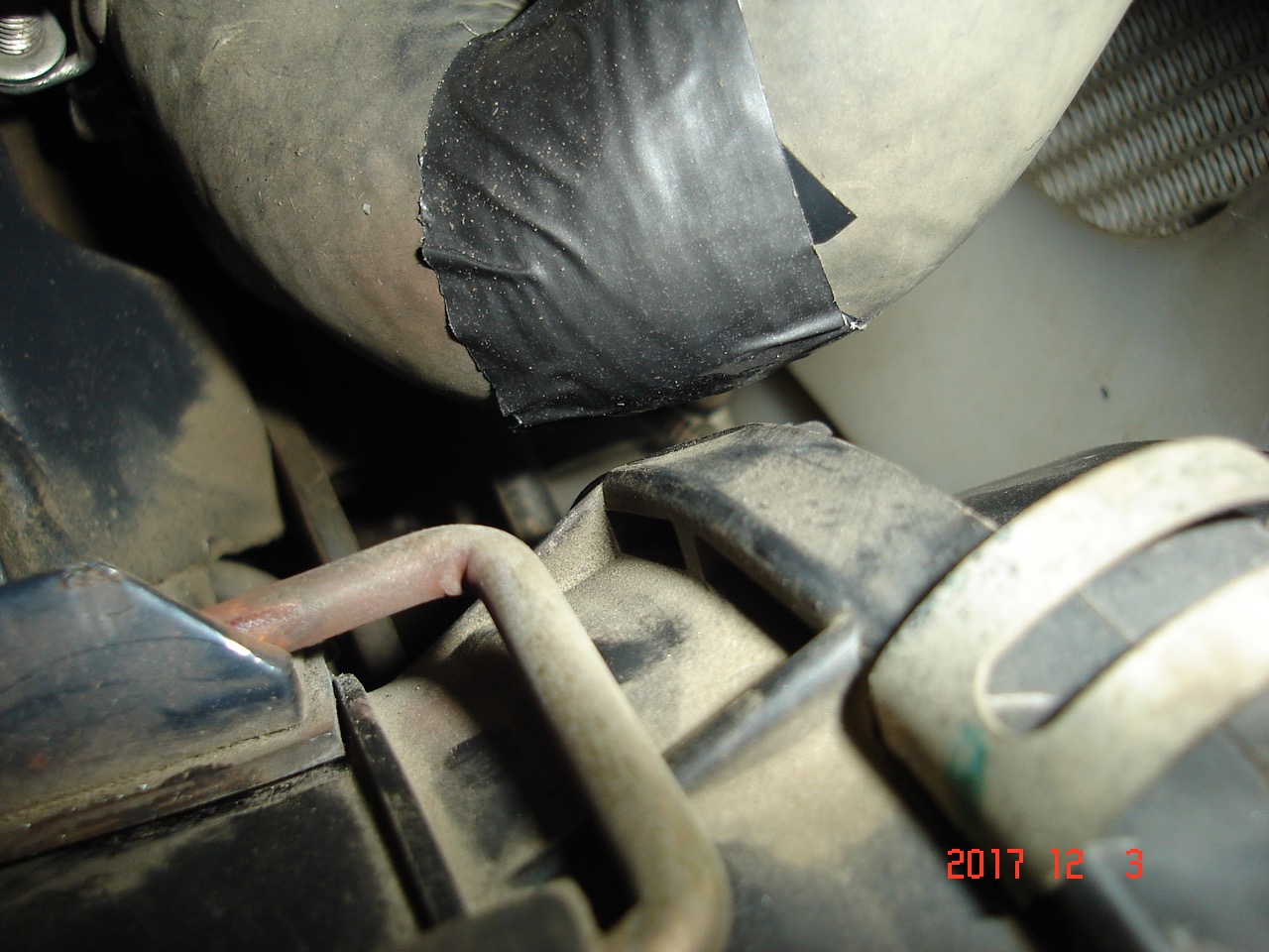

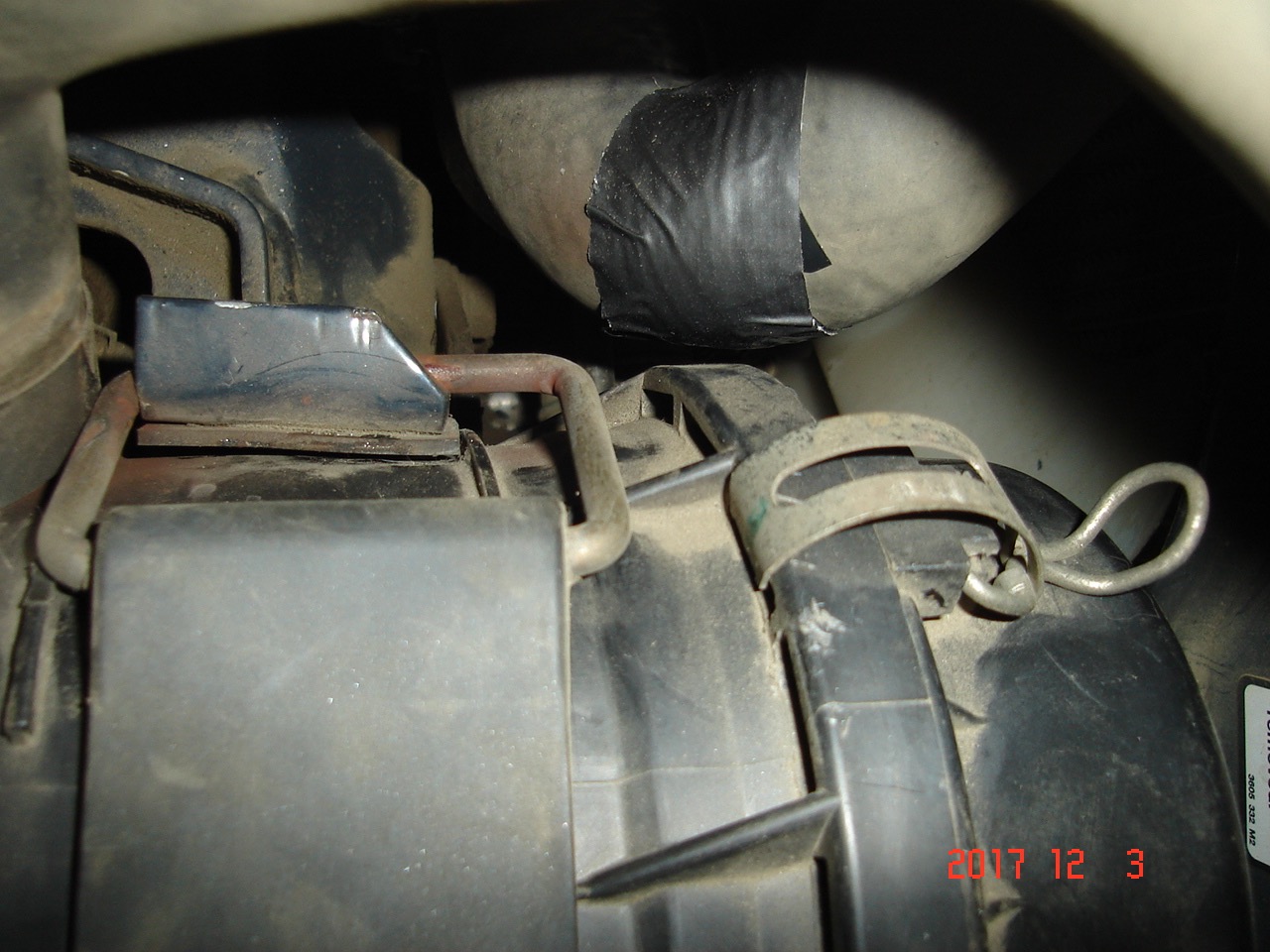

Had the same issue with my 2310. Initially moved stuff around (esp. air cleaner housing), reinforced with tape, eventually replaced the upper hose. This was relatively recently, within the last 2 years, at around 850 hrs.
