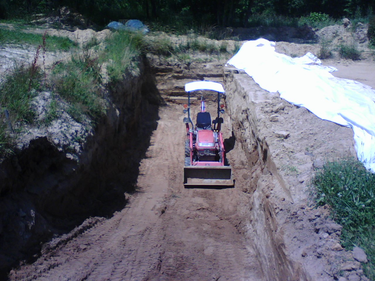

I have dug a basement with my 2310 most of the loads where done in reverse with full buckets and no problems. There is something wrong still. here are some pics showing the angle I has climbing. The bucket is not full in the one picture because the brakes would not hold with the bucket any fuller.
Doug

wow if your able to backout of that hole with a full bucket full and with the backhoe on as well then there's still something wrong with mine.After posting this morning I called the hydro guy that did my hydro unit and explained to him what it was doing and he sugested that I swap the springs on the poppet valves to see if it makes any diff.I guess like he was saying if its weak in reverse then by swapping the springs it should be weak in forward.Anyway I didn't have a chance to do that today so hopefully I'll try that tommoro if I get some free time. Sure hope thats all it could be its easy to do that compared to pulling the hydro out again.Once I do that spring swap I'll post again letting everyone know how things went.As always Larry.
