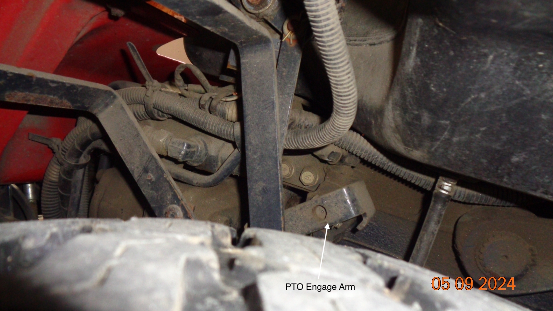

I don't think the filter being "very warm" is a problem -- that's normal, IMO.
When engaging the mower, I always follow this sequence (disengage reverse):
1) slow to idle
2) Slide forward PTO lever to "2000"
3) Slide main PTO lever to "engage."
Sometimes the gears will grind when I try to slide the "2000" lever in; I back that off, then briefly slide the "engage" lever in, then back out. After that, I can slide the 2000 lever in with no problem.
There is a rudimentary clutch in that PTO mechanism, but that's internal, I believe -- hope that's not your problem.
You may wish to look over carefully the mechanical parts --levers & arms, beneath the floor/left rear wheel well-- connected to the "engage" lever -- perhaps something is worn or loose there so it's not going completely into position.

worn/sticking linkage could also explain the mower not fully stopping when main pto lever slid to off position
edit: pto is a wet clutch that can be partially engaged.

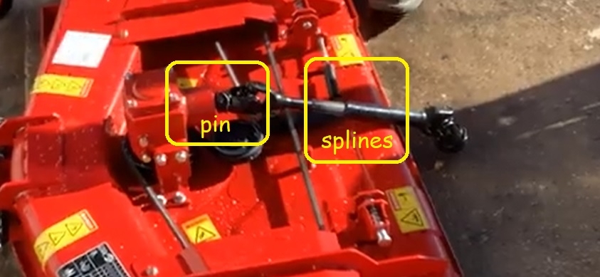

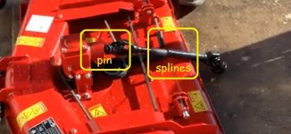

As all the above have mentioned, check for sticking linkages. My GC2300 has started to bind a bit when selecting the PTO. The Mid and Rear selection levers are starting to stick under the fender, will move together, not independently. The deck slow down may be a belt slipping. Check tensioner/spring, even the condition of the splines of the mower deck driveshaft.
Also check the pin connecting the pto shaft to the gearbox. There is also a key on the gearbox output shaft on the center blade. Sometimes friction is enough to get it spinning.

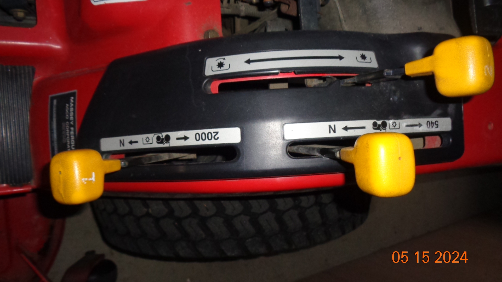

First observation/situation: it may be that the PTO shaft will turn just due to hydraulic fluid swirling around in there. Yes, it would be slow, and I bet you could stop it easily with any resistance applied to it.
Second observation/situation: Is this also with the "Engage" lever -- not the "2000," not the "540," but the inboard one -- (is this the one you call the "PTO On/Off" lever?) pushed forward to the engage position?
I don't think there's a mechanical connection unless and until two levers (front/rear -- 540 or 2000 -- and the engage lever) are both pushed forward.
