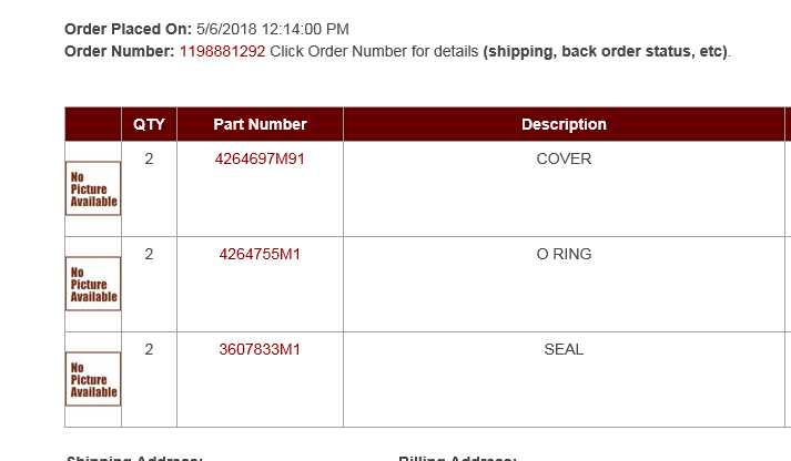

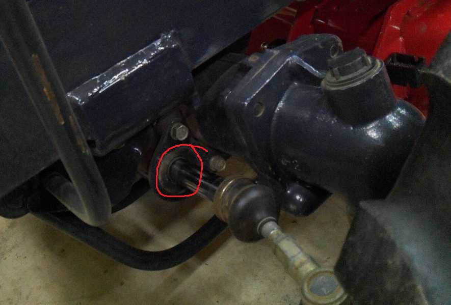

HI, I have my 2005 MF GC2300
is leaking from one side of cylinder.

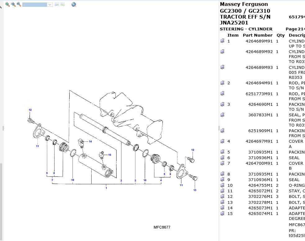

I already order and received all replace parts to do the job.
my question is:
as that only have 2 tubes that connect the bottom cylinder to power steering box at top, where to add oil? as most of the oil already coming out?
and what oil to use?
I will appreciate your answer, before I start fix.

That uses the same hydraulic fluid as the rest of the tractor. It will automatically take fluid from the main fluid reservoir in the hydrostatic transmission.
