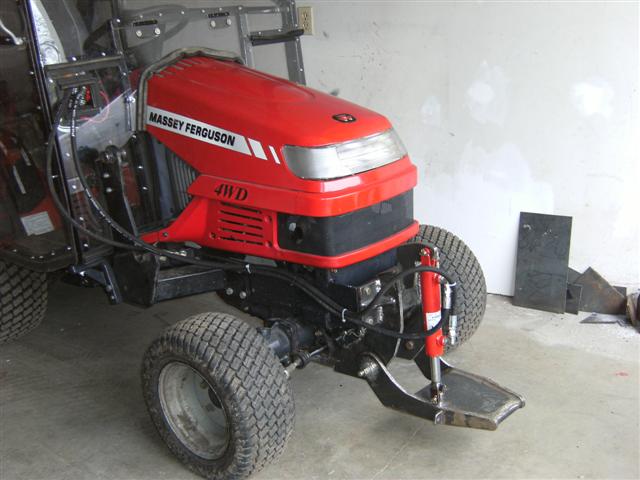

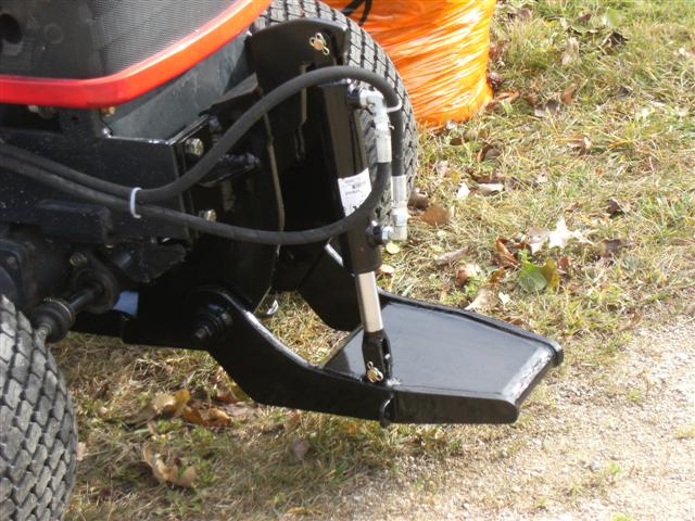

i read a thread some where a guy built is own front quick hitch but can not find it
i do not know what forum it was on and i lost his email
i do have pics of it though. can any body help
i was going to get demintions when winter was over so i could build one

That's simpler than the factory spec version for the snow blower. Do you have the blower? That's from where the specs should be taken, or are you trying to do something different?

i am wanting to build other things where i live you don't need a snow blower

I think that was on this forum, I believe I remember seeing that as well. Have you done a search here?
   / gc2300 front lift #5
If you know anyone with a BX series Kubota, with the front quick hitch..........they are the same as the Massey. I remember reading that thread, he used the BX hitch for a pattern. After that I did some investigating and found that the blowers for the Kubota BX and the Massey are both made by RAD, and are identical except for paint and model numbers.
