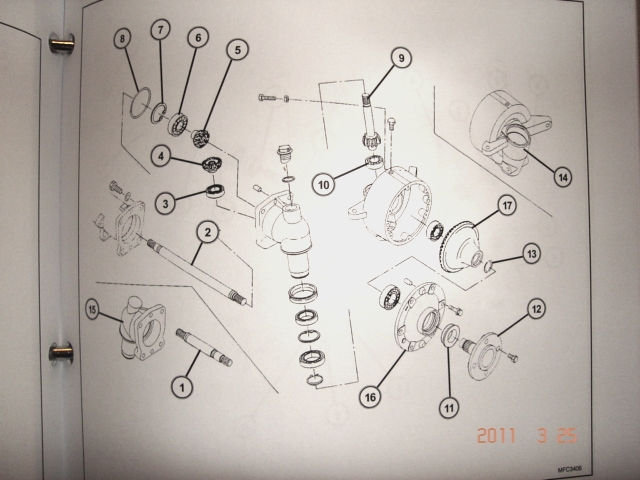

Hi guys and Happy Thanksgiving !
The front left axle seal has been leaking badly, I just pulled the casting apart, pulled the bearings and big bevel gear and see the front axle seal. It reads AE2074F. This is actually the axle seal, not the steering pivot seal I've read several threads about here.
When I search AE2074"e" comes up. Do any of you know if there's another part number for this seal ? And/or an exploded diagram showing these parts ? Looks like Kubota front axles use this seal but I can't find anything relating to MF tractors ??

   / GC2300 Front Axle Seal ?? #3
Agco lists it as 4265163M91 if that helps.
That helps a lot ! Thanks very much !!
