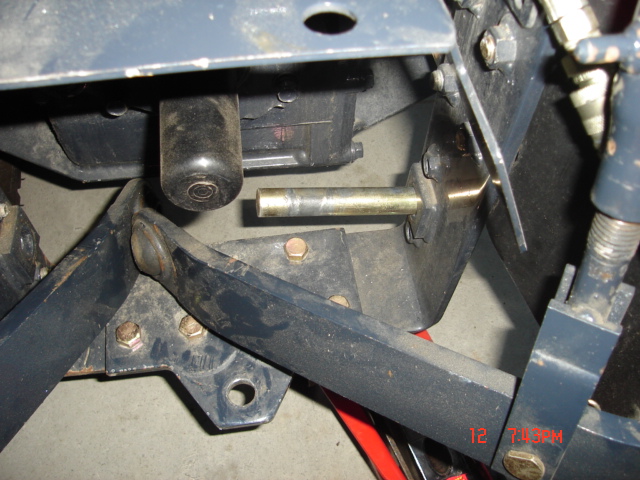

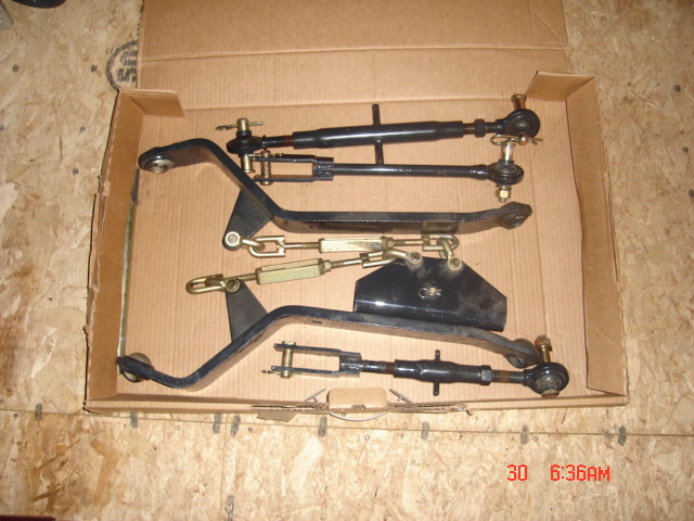

Because my three-point arms would dig into the ground at the base of my steep slopes (when the mower was lowered), I just removed it. Not that hard to do. Remove a few bolts, slide the shaft out.... Found a box that the parts fit in, stored it safely away.

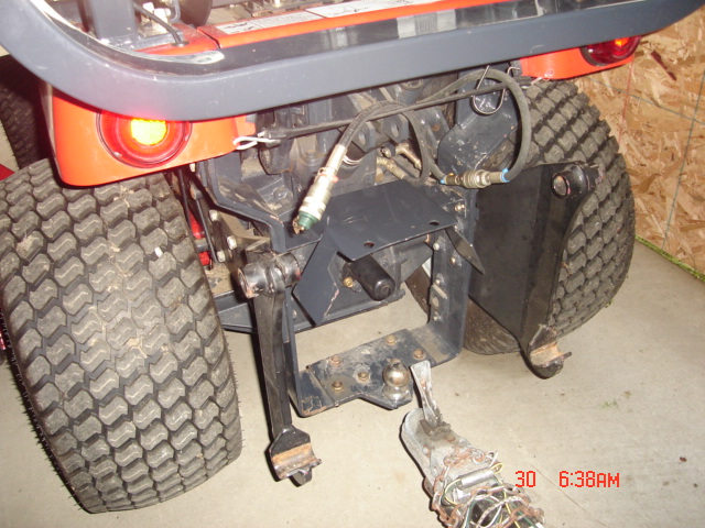

   / GC2300 - Creep & Towing while Mowing
I have attached my solution to the towing problem. I was inspired when mustangsallysdad told me he had a hitch as part of his quick hitch.
I cut four acres and it seems to work well. The Swisher mower is not very sentive to the tow bar's height.
I also tightened up the spring in the foot pedals linkage to limit the "creep". I think it helped, but I may just be deceiving myself. It certainly didn't solve the problem altogether. When the tractor is off, the pedal always seems to return to neutral. But when it's running, it's another story. I wonder if there isn't hydraulic force applied inside the hydrostatic that impacts the ability of the foot pedal to return to neutral?
