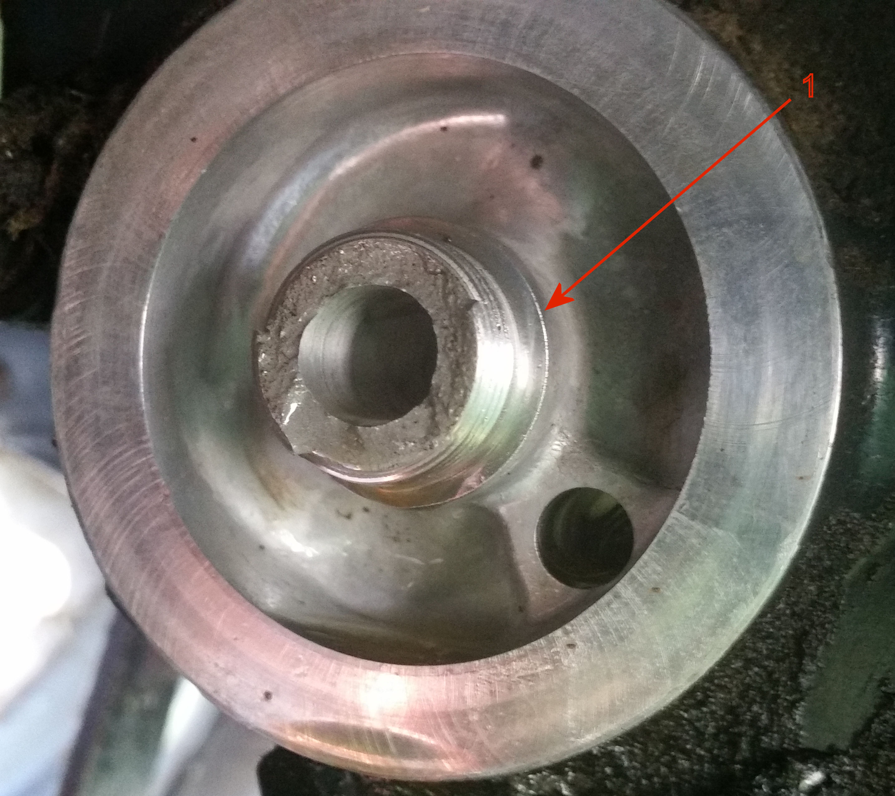

I removed the belly mower from my tractor and attached the tiller for some garden work.
I don't normally remove the short shaft from the mid pto unless I am doing something serious since it is not really in the way.
So I get in position, move the mid pto to inactive position (or so I thought) and put the rear pto lever in active position and engaged the system,
but since the mid pto wasn't fully inactive I heard a load bang and quickly disengaged the pto and heard fluid running.
After shutting the tractor down I crawled underneath and saw the filter laying on the ground and fluid running out.
I came to realize that the threaded flange broke off in the filter leaving about 1/2" of thread on the case end.
So now I am investigating my best approach to fix this. I refuse to replace the whole case front. I purchased a NAPA filter that should fit because the threads aren't as
indented from the top as the OEM filter but it was still too much. I have the service manual but it doesn't show this as a separate item (like on many car engines) and it does look like it is part of the case.
I am currently considering cleaning up the end of what I have left on the case and machining an adapter but I am thinking I will need to double up on the gasket because
the adapter won't let me screw the filter on as far. In this case I will probably go back to the OEM filter or maybe the WIX filter since they both appear to have the
threads set back further than the NAPA filter.
So if anyone has any ideas, other than not leaving the short shaft on the pto, I would appreciate your input.
TIA,
Lou L.

   / GC2300 broken hydraulic oil filter flange
Oh what fun I have been having.
Here's where I started:
Not as bad as some others I have seen but since it broke off right at the filter it was too short. I thought about doing the drilling and tapping as suggested by Ray66v but I decided to attempt something different.

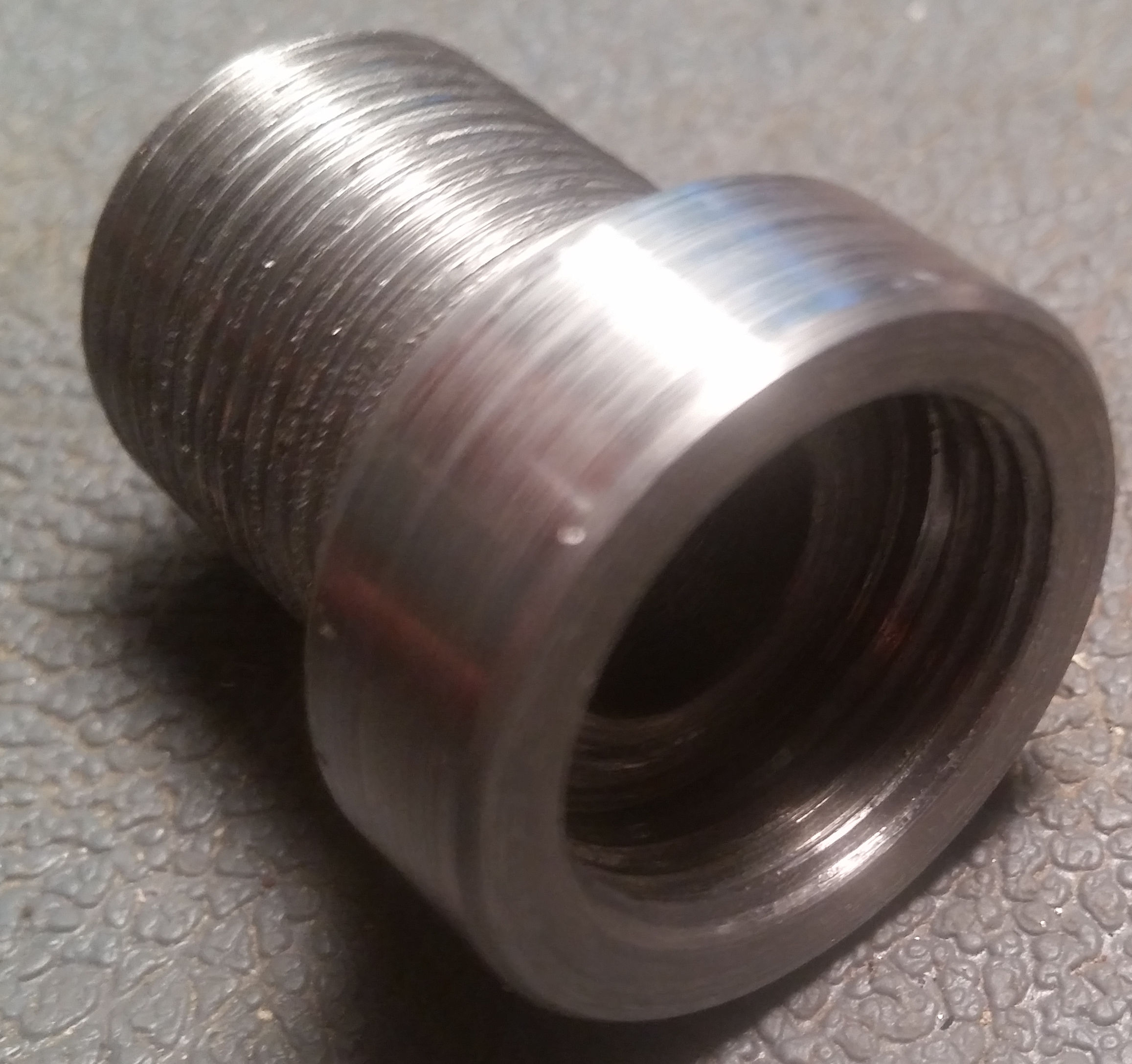

I had this made in our shop:
We made it out of steel so the female end could be made shorter but it was still too long for either of the filters I was looking at.

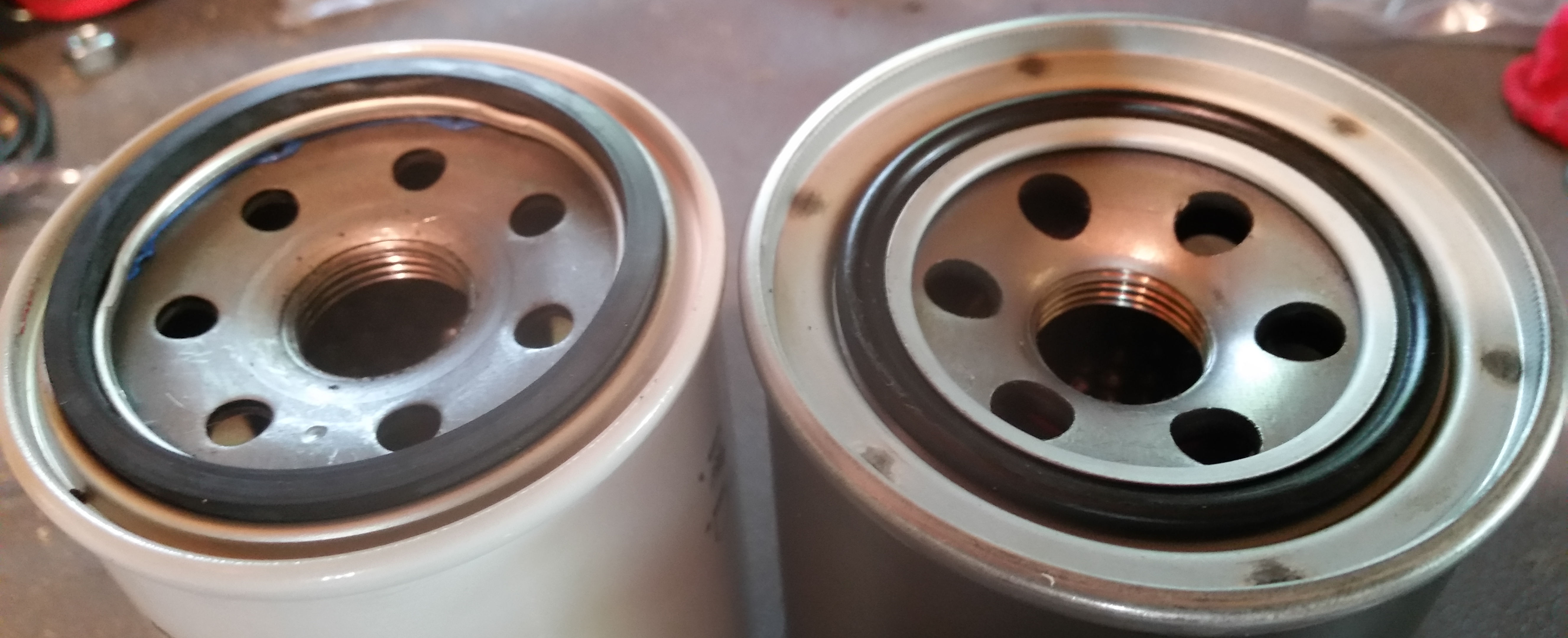

Here are the two filters:
On the left is the NAPA FIL 7089 (or Wix 57089) and the right is the Agco filter. The NAPA/Wix filter has the gasket sticking up slightly higher and since I needed all I could get I choose it.
I was unable to find that this filter is an official replacement for the Agco but looking at its' specs and the Kubota tractors' specs it fits, it seemed like it would do the job (If anyone knows differently please let know).

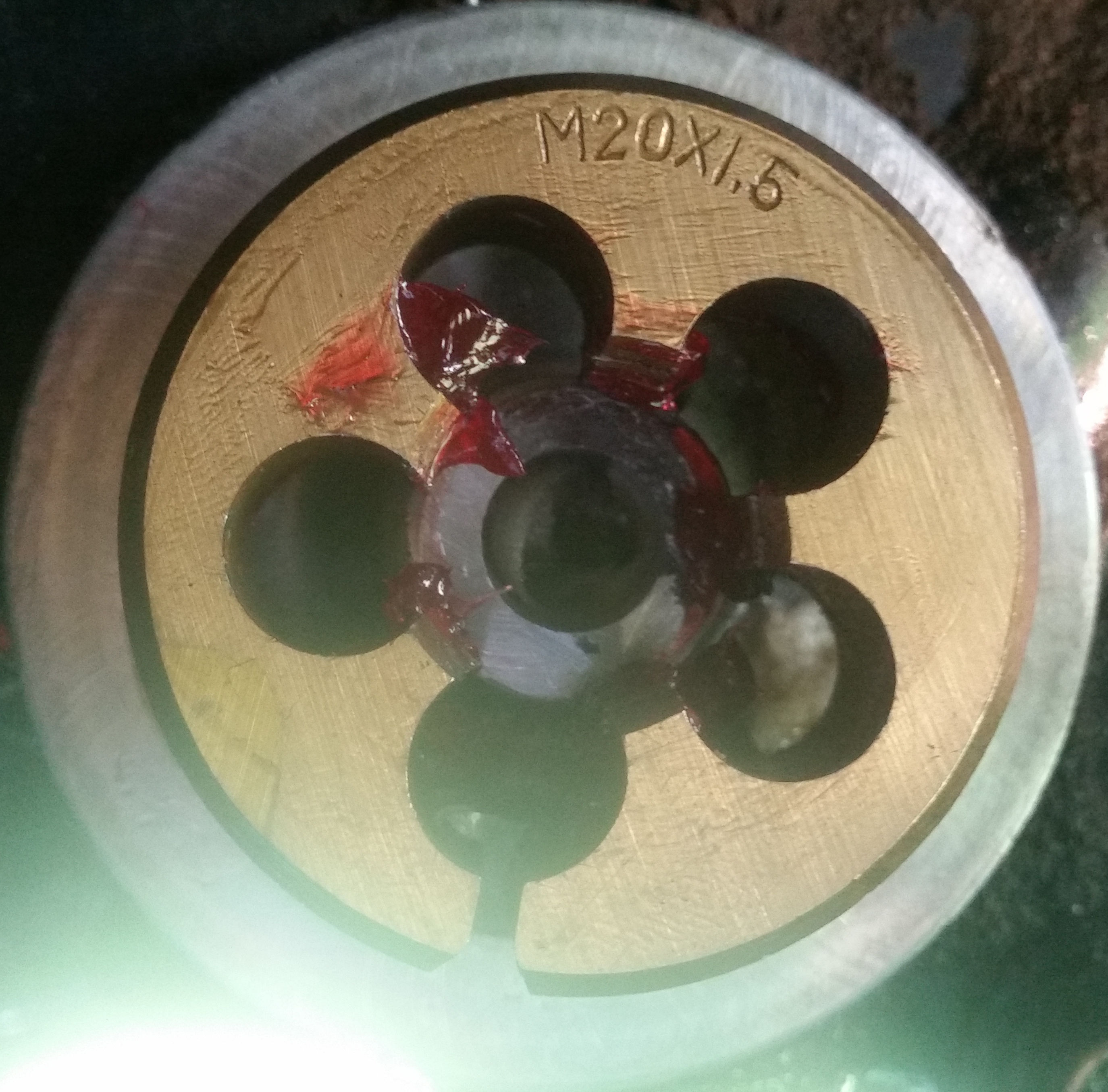

So to get my adapter to go in deep enough I needed to remove as much of the shoulder on the nipple as possible (see 1 in the first image).
I did this by using a 15/16" hole saw then run the 20mmx1.5 die on it. Luckily the die "almost" fit into the gasket seat.

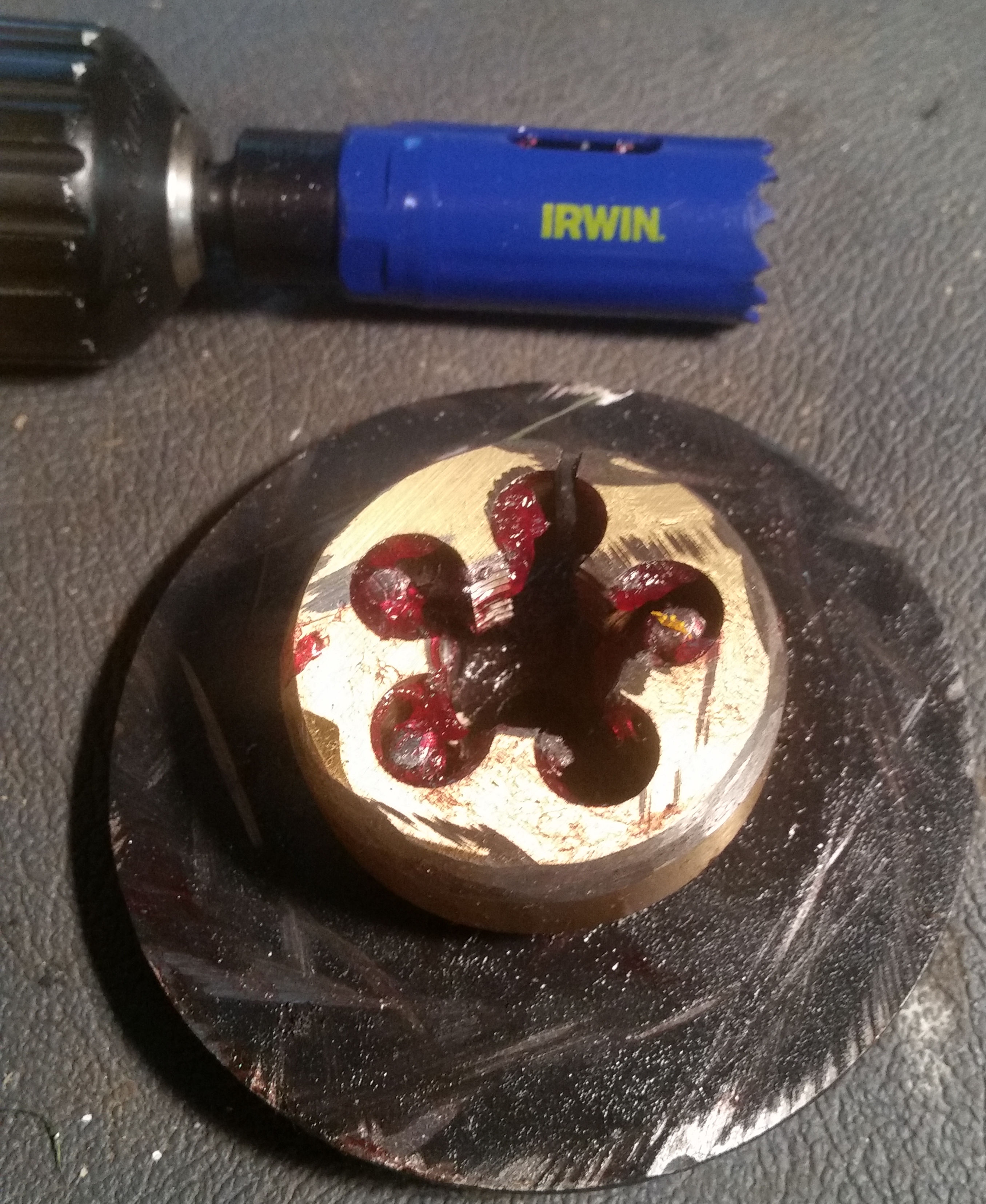

At first I was a little perplexed on how I would run the die in when I didn't have room to use the handle on it.
I took a steel disc I found in my junk pile, drilled 3 1/4" holes and put 1/4" bolts through with a nut. Then I welded a nut on the side with the bolt heads so I could use a ratchet and socket.
The following is a picture of the hole saw and the tool I made to run the die in:
As can be seen I did need to grind off the die a little. After threading I did have to cut the nipple on the filter mount down some.
I used some red Loctite on the female end of the adapter so hopefully I will not need to take that part off in the future.
