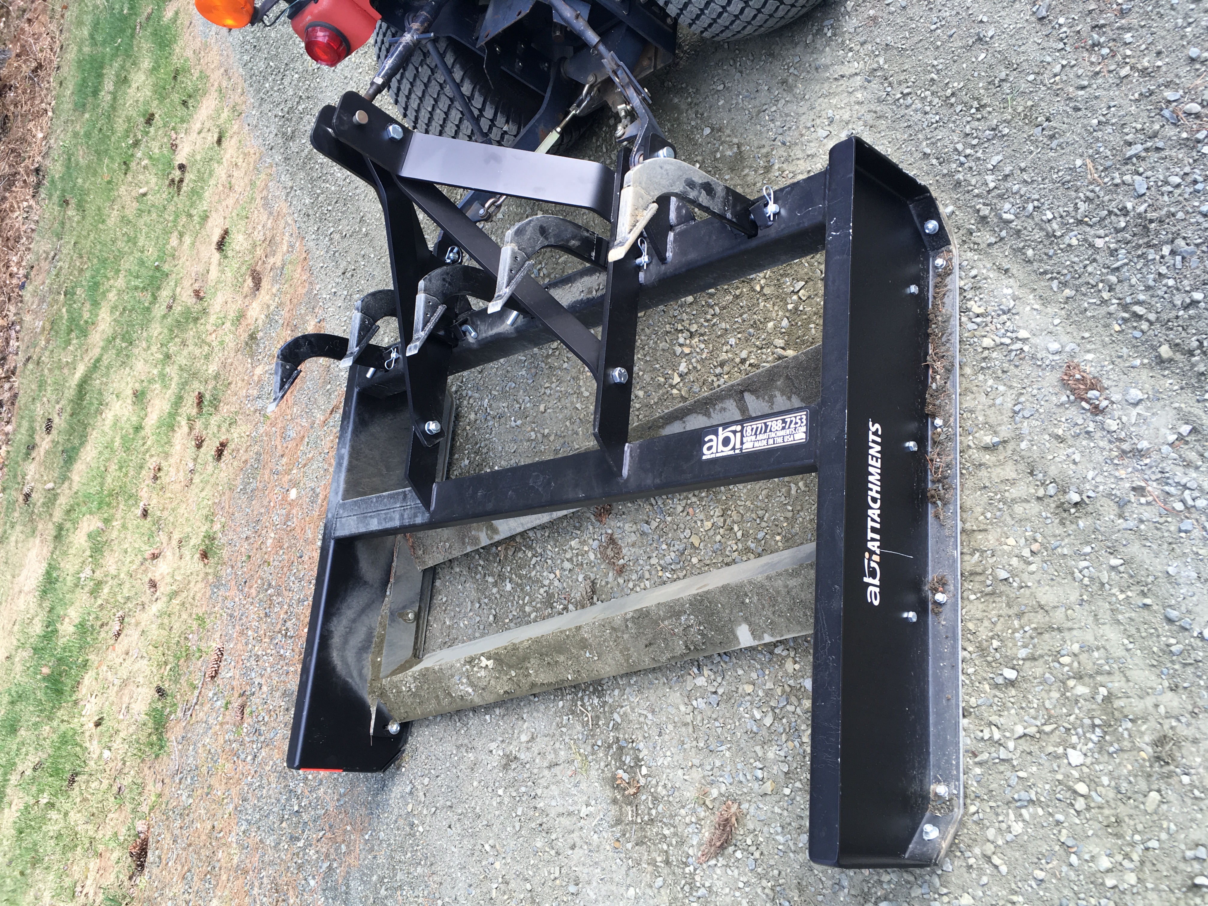

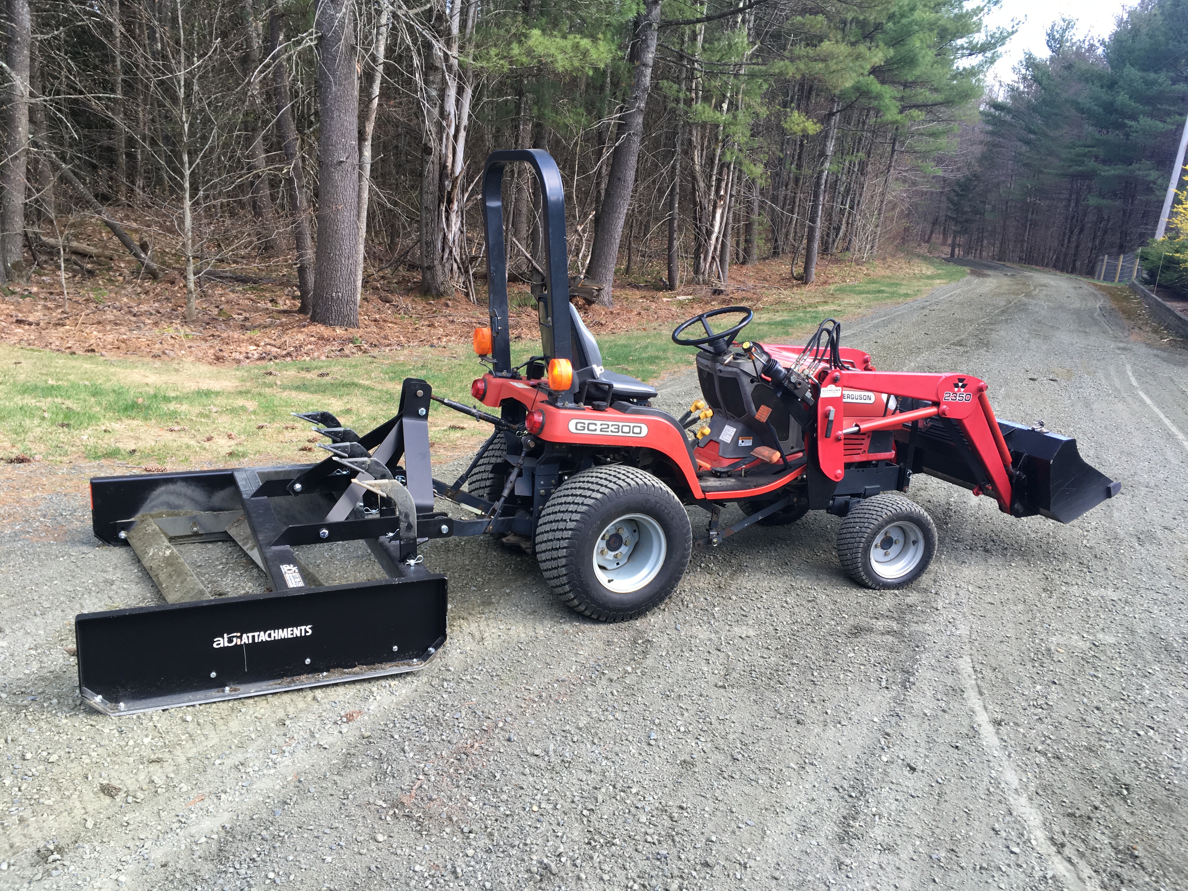

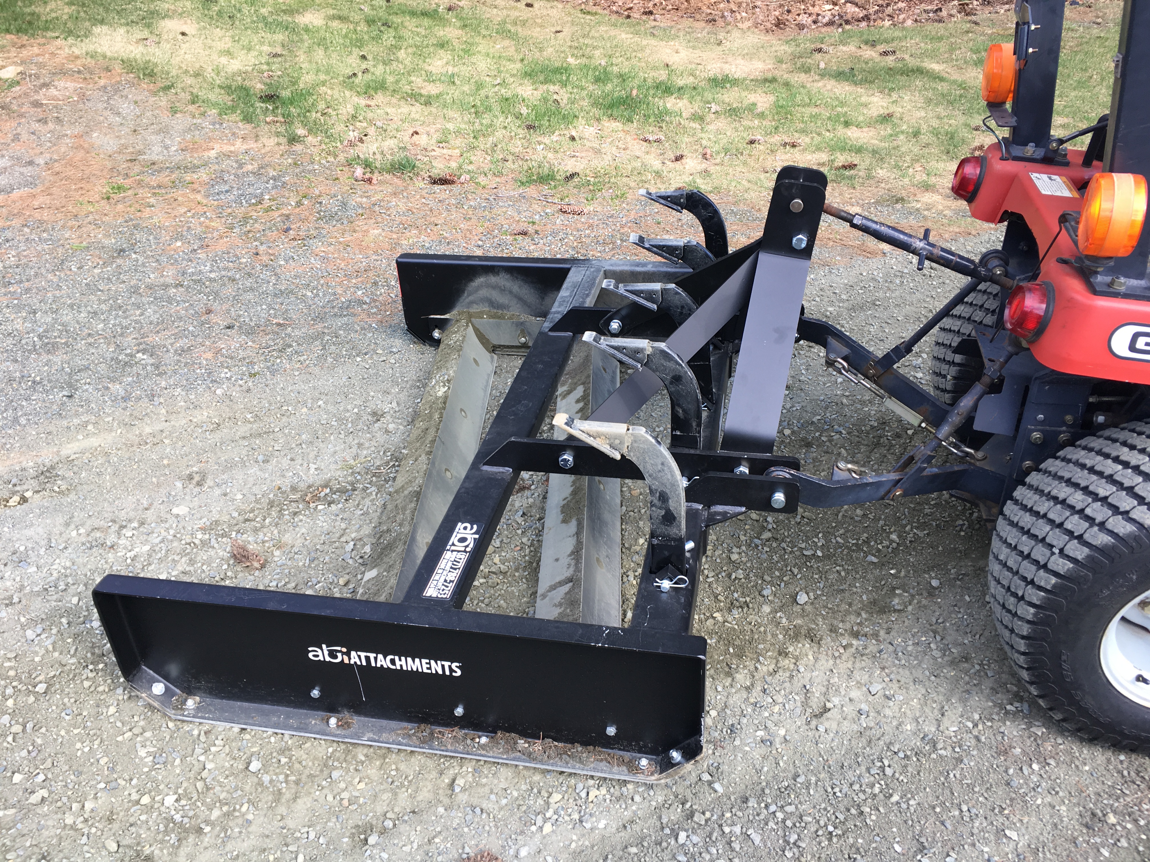

Been using the ABI AILP60 Land Plane for a few months now on my GC2300. Thing works awesome. Have a gravel driveway ~1800ft long. You can get this thing to scarify, fill in washouts or do light grading really just by adjusting the top link. The only real issue for me is when the box is completely full my turf tires have trouble pulling that much weight and I can loose traction. Recommend to anyone looking for a grader.
BTW this thing is heavy :eek: and built to last !

scarifiers work great to loosen and provide material for filling in washouts. the way the blades are positioned you can shorted the top link and run just the front edge to really cut with full weight of the implement and the down force (more like a box blade with small footprint this way). never used a boxblade but can imagine anything easier or better suited for this type of work.
