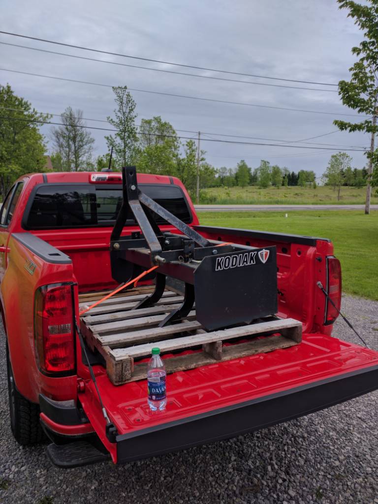

I was fortunate enough to score a 48" Kodiak SD Cat1 box blade (now ownee by Paladin) from an auction for a local dealership that sold Cub cadet and Mahindra tractors. It doesn't appear used much if at all but looks like it's obviously been weathered and sitting outside.

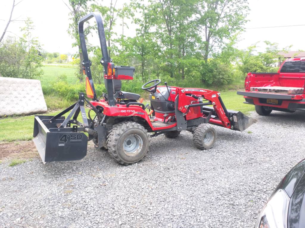

I tossed it on my GC1710 and took a could passes on my gravel driveway while set at level between front and back cutting edges. What really stuck out to me wasn't that I didn't have the power to drag it...it was that I didn't have the traction once the box was full of gravel. I ran at about 1400rpm, low gear and then was forced to use 4wd to have the grip to pull. I have R4 tires for reference. I originally was going to buy an Everything Attachments 54" land shark subcompact box blade and I'm glad I didn't. Not only did I pay a fraction for a blade with similar construction (cat 1 pins instead of clevis hookup, and 3 rippers vs 4 being the difference) but I fell into what I feel was the right size for this unit. Just wanted to share for those of you who might be considering similar circumstances. IMG_20190604_140411.jpgIMG_20190604_160913.jpg

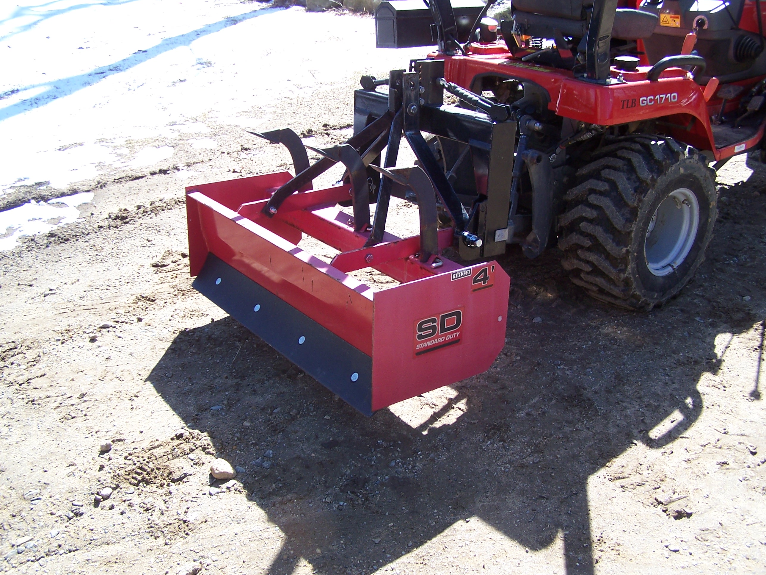

Back in March I purchased a 4 ft. Box Blade.
Got several prices from local dealers, anywhere from 700 to over 1000.
For the heck of it I called an Agway dealer, said he had 3 of them he had been sitting on and would give me a "deal" on it because it was weathered.
I drove down and he said 500 plus tax...so I took it.
I'm happy with it, seems well made and is a good size for my GC1710

Yours is the same as mine!! That's a Kodiak/Paladin 4' SD Box blade. I agree that it's a good fit for the GC tractor. Mine was new/unused but very weathered from sitting at the dealership outside as well. Picked it up for $350 at auction.

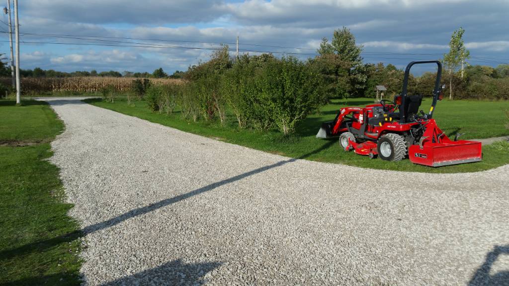

I've got a 5'er for my GC1715. This attachment is one of my favorites. I get some good washouts from heavy rains in my gravel driveway, and the box blade gets it back into shape in a hurry. I use 4X4 low gear, and it rarely gets bogged down. Cuts and fills the gravel to like new condition in a short time.

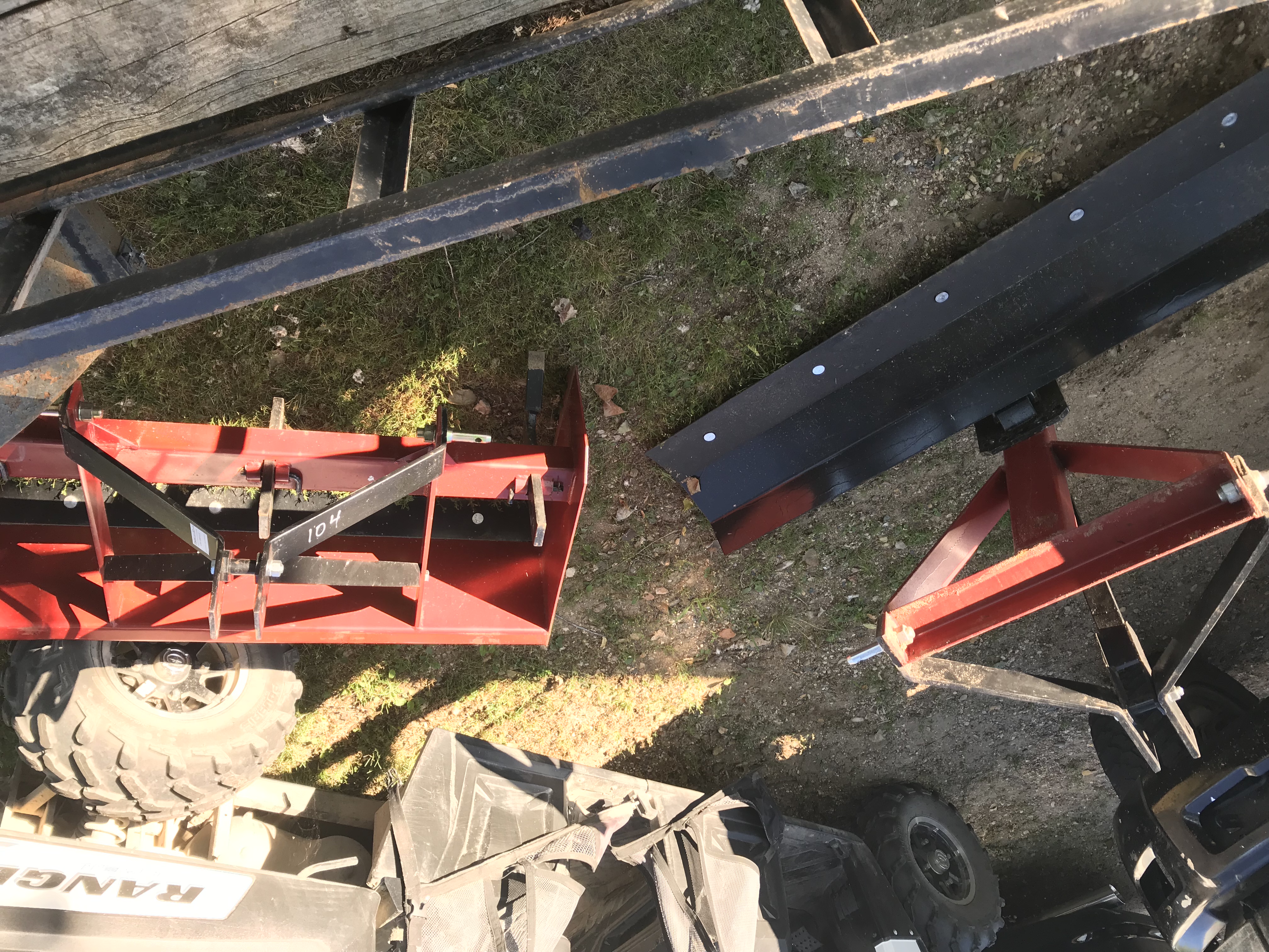

I just wish my rippers were height adjustable. They only have one bolt and no adjustment holes. They rip well enough, though. I've only used it on gravel so far. It ripped some hard packed 304 stone on my other driveway that was solid like cement. 20181011_170113.jpg
