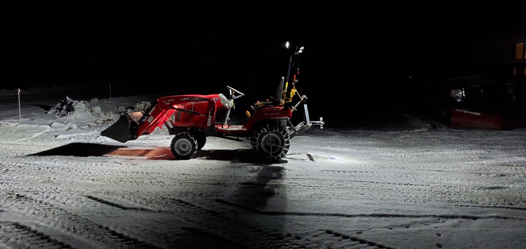

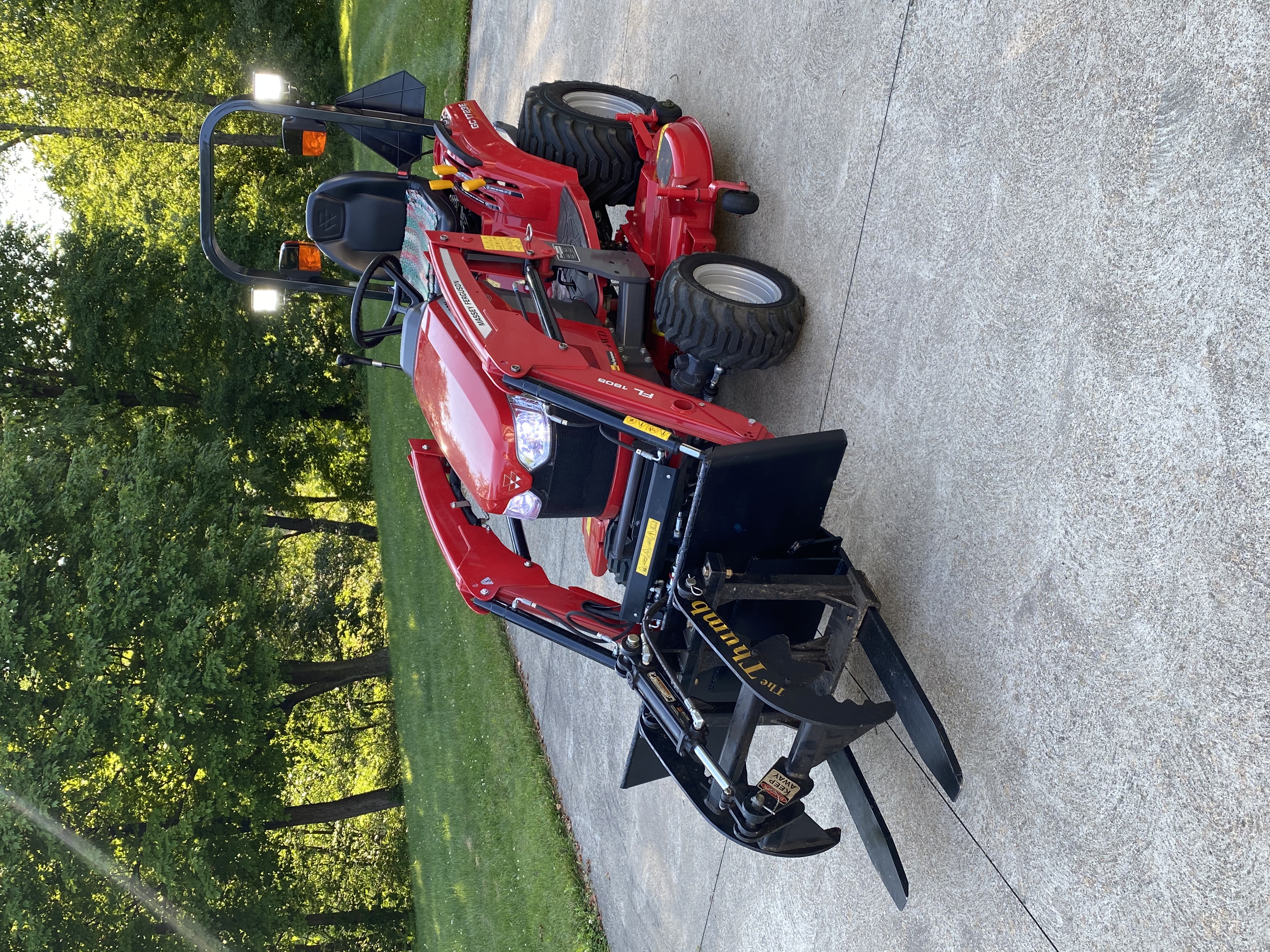

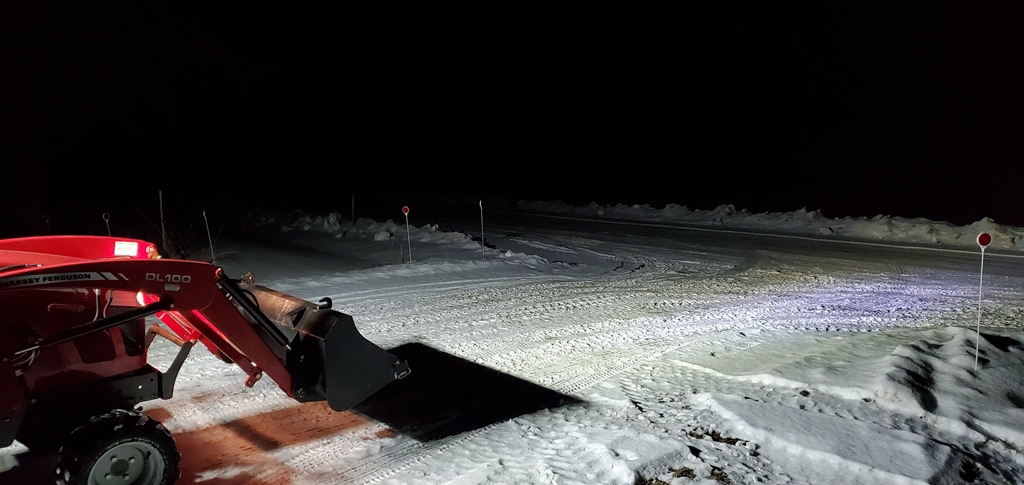

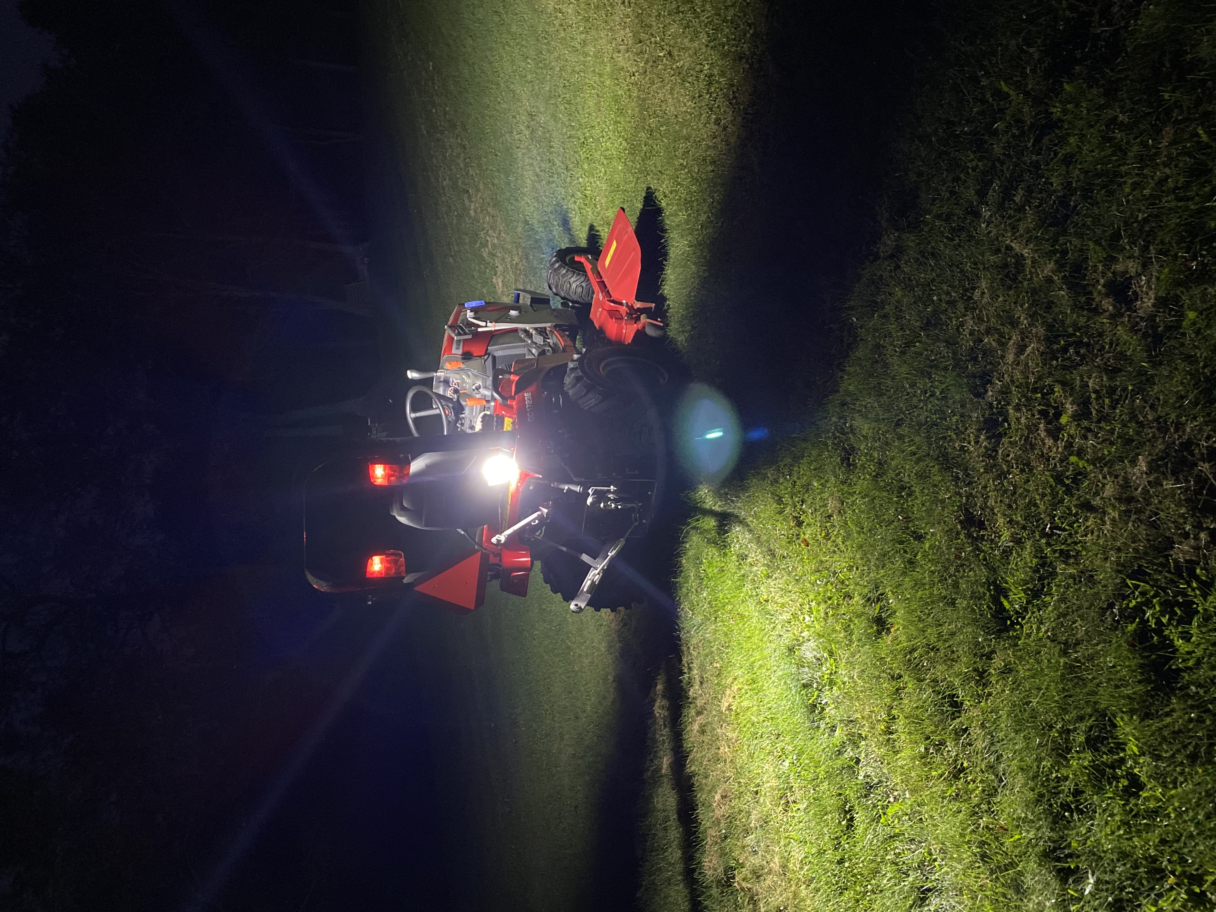

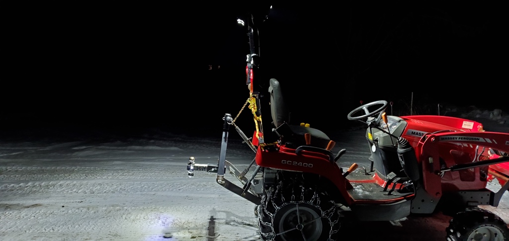

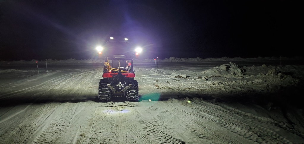

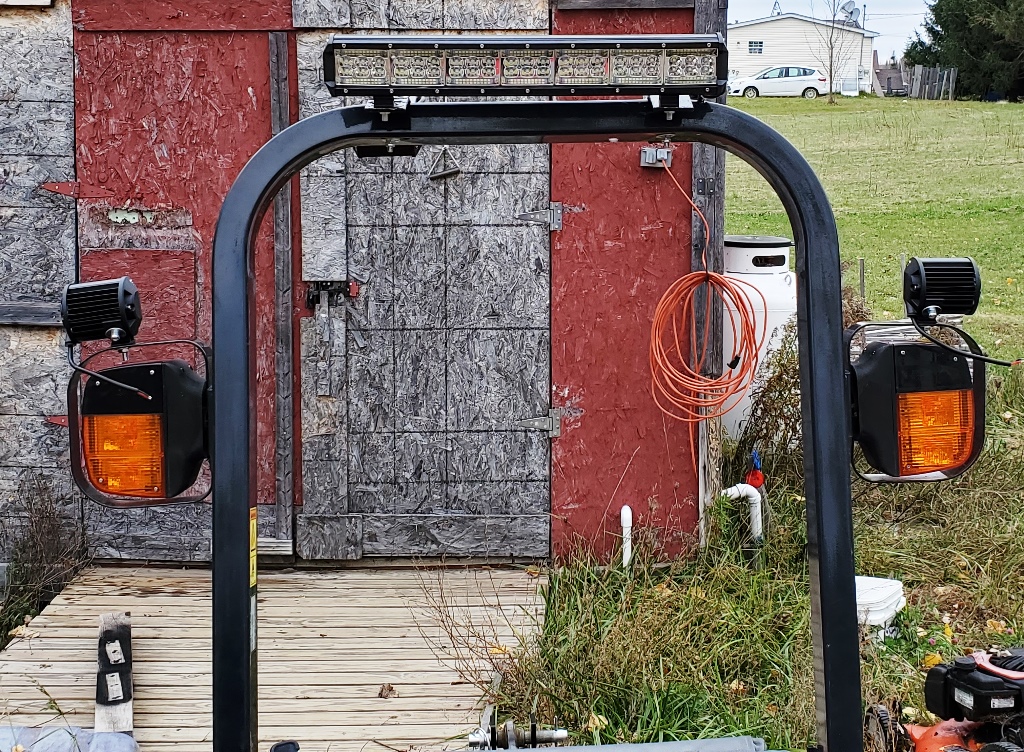

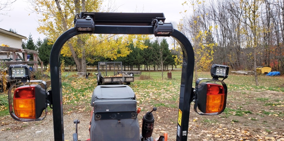

didn't do amp draw with them on but there is zero noticeable effect. also left on for 30 minutes with old battery and tractor started just fine even cold.
View attachment 683158 View attachment 683159 View attachment 683160 View attachment 683161 View attachment 683162 View attachment 683163

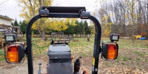

Not to be rude but how tall are you people or your roll bar? That light as it’s mounted would give the back of my head a nice sunburn. The road ahead of me wouldn’t get any light past my fat head. I moved my turn signals to the inside and mounted some really bright LEDs in their place on the outside of the roll bar.
