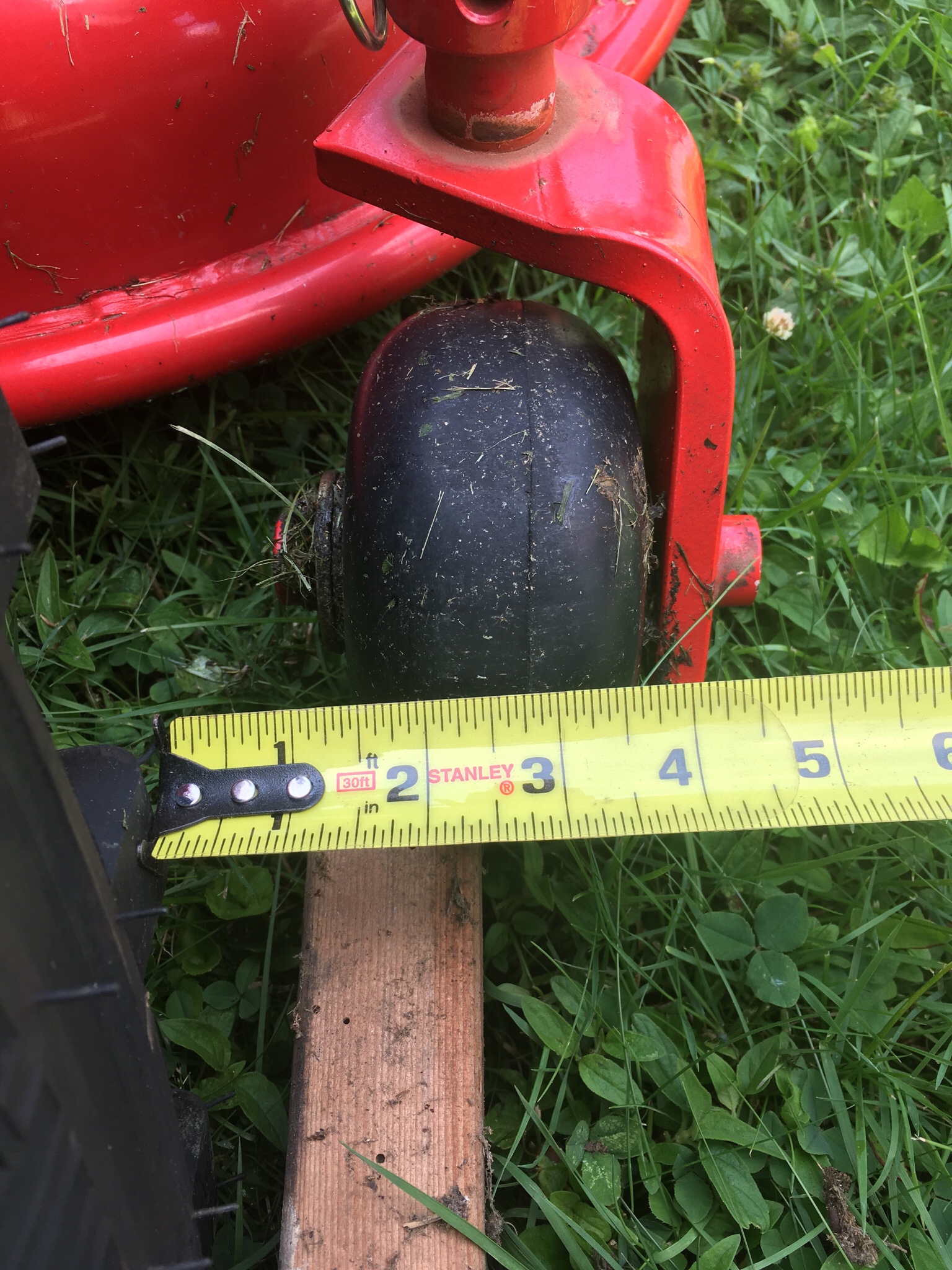

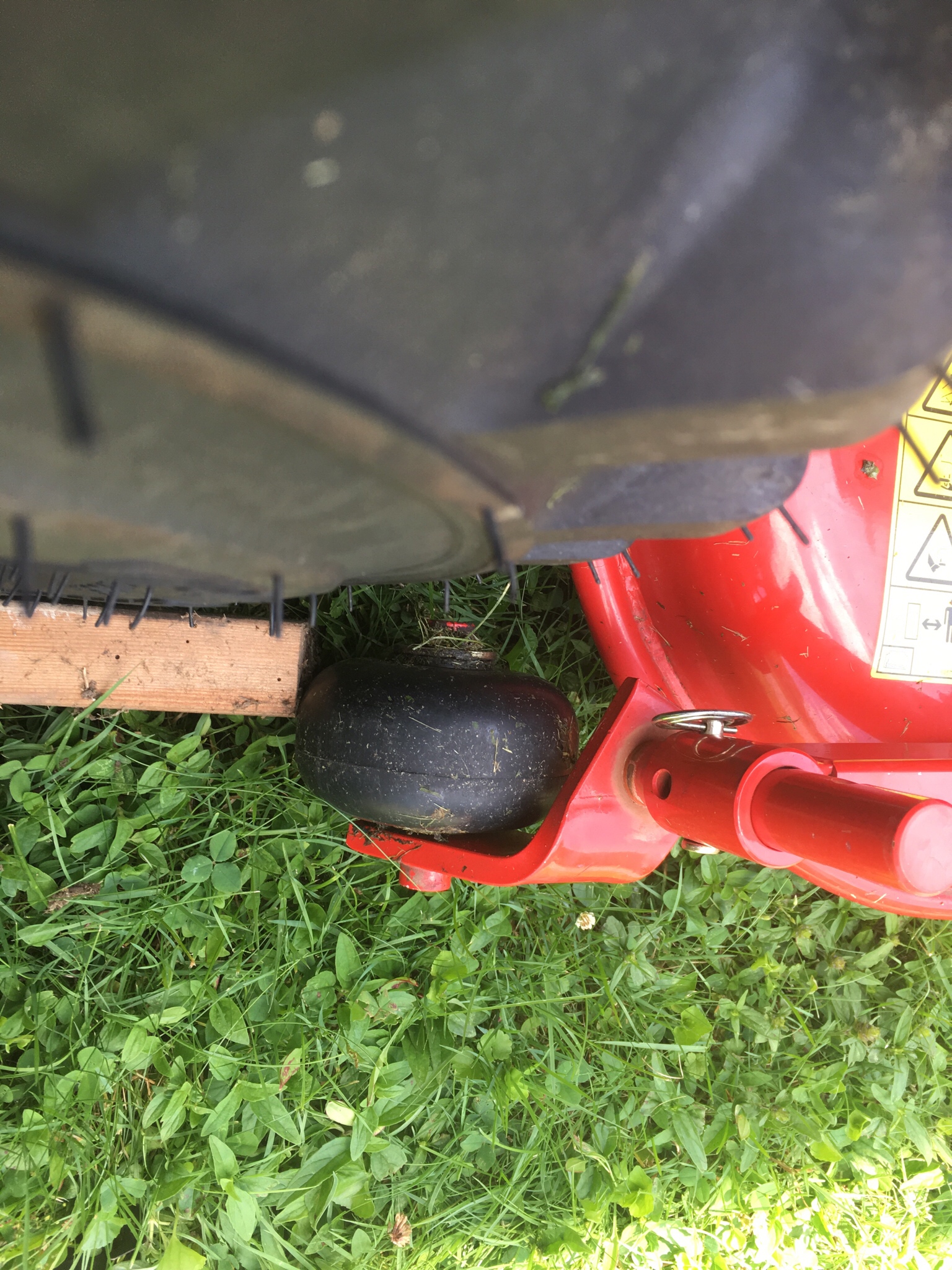

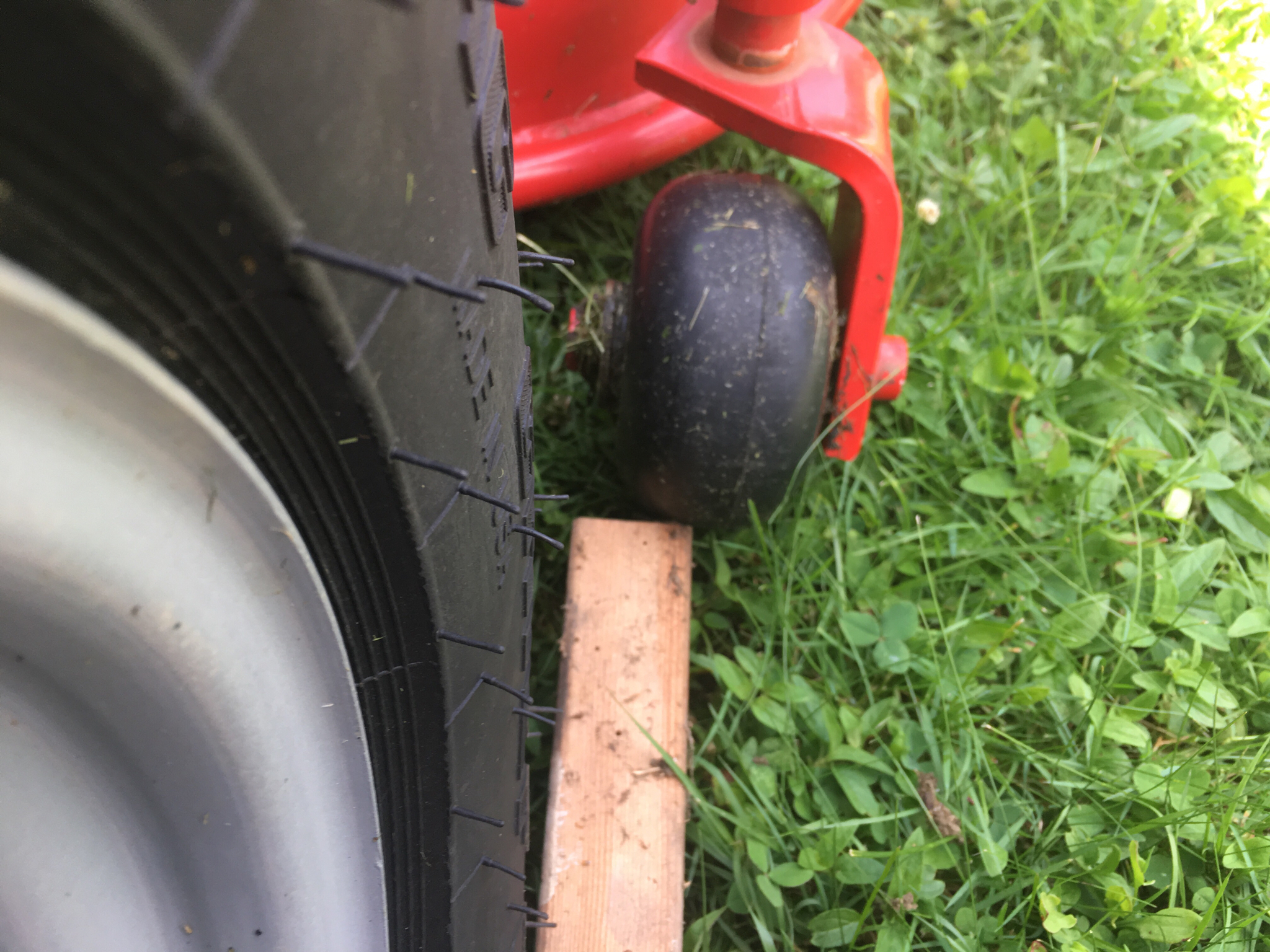

4. I'd like to have 2 inch spacers - but because I haven't been ready to order them yet I haven't actually measured to verify the size I can get by with. Now if I had the standard 54 inch Massey deck, I'd tend to take Bro Tek's recommendation automatically - because I can assume the 54 inch Massey and 54 inch Kubota decks are similar sized and roller wheels positioned. However the Massey 2315 deck is unique to Massey - and it is likely Bro Tek may never have seen one - that may mean it's ability to take a bit larger spacer is possible. The rear guide wheels are fixed in direction but can be set higher or lower - so if you use a 1 x 4 board you should be able to physically measure when your rears would hit the rollers or roller brackets with the deck up and with it down. Obviously you want some clearance. If 2 inch spacers give you clearance - then I'd go with 2 inch. If not then I'd go with 1.5 inch spacers. At no point do you want any part of your deck to be hitting the rears during operation - but big gaps doesn't help you very much. Also - you've probably noticed that there isn't much difference in price between sizes.

I went and grabbed a piece of 2x4 and took some pictures and measurements. Here is what I came up with, if I did this wrong let me know.
