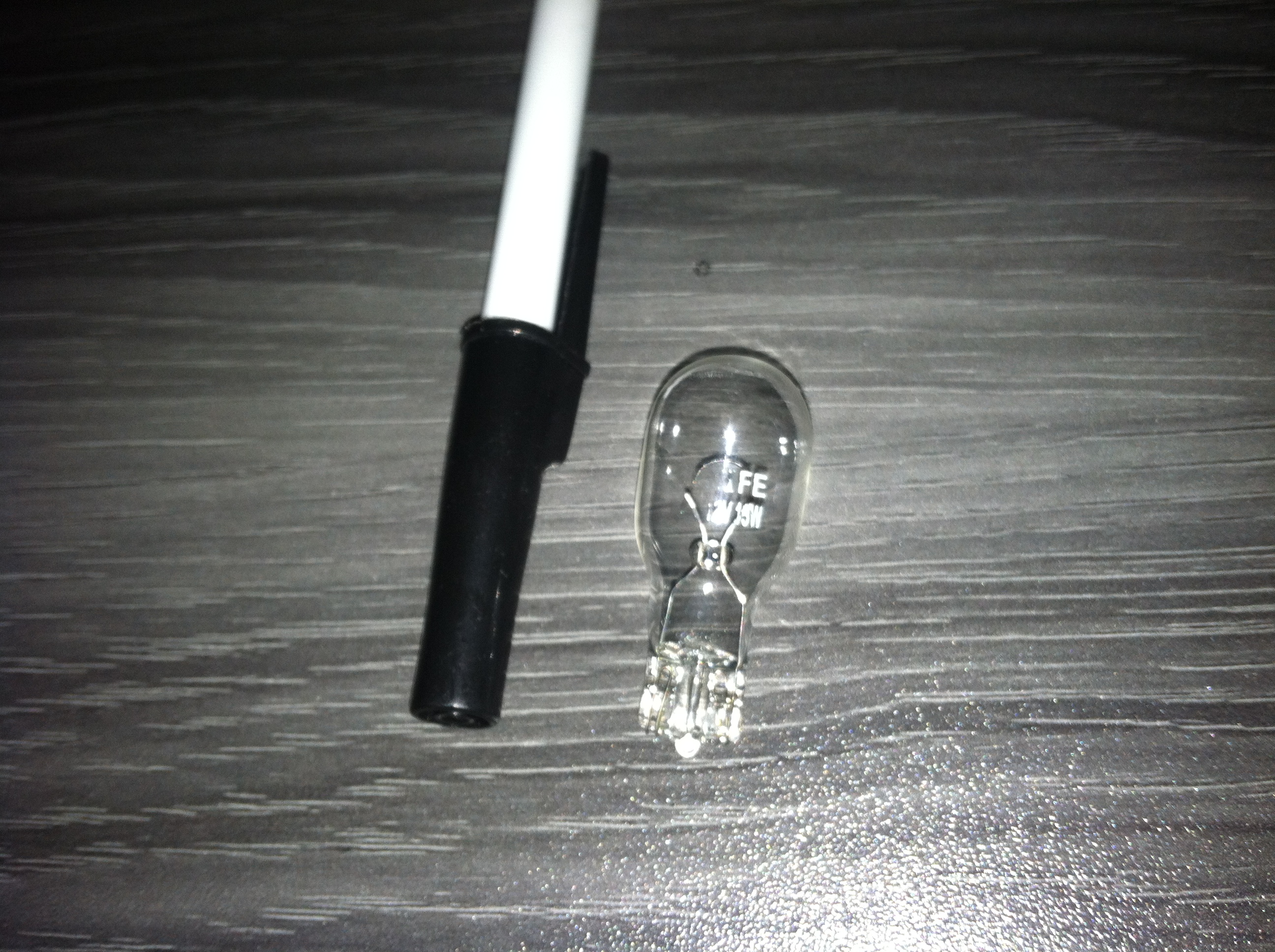

anyone know what type of headlight is used? I'm looking on our operator manual and I cannot find anything for replacement.

Well i took one of the lights out and they are a 904 style bulb.
   / gc1720 headlight replacement #3
Are you saying it's a glass, bayonet base bulb?
That doesn't sound like a headlight bulb.
I dont know what a bayonet is. But it is a small glass bulb, i brought it to autozone and compared it to the small bulbs i found thier. It looked exactly like a 904 bulb found on automotive cars, like for turn signals, brake lights etc.
Ill take a picture of it when i get gome from work if its not pouring rain again. The only writing on the bulb i found when i took it off said "life" on it.
the picture of the headlights
   / gc1720 headlight replacement #6
The bulb you have, is indeed a glass bayonet base. And, it's only 15 watts.
I have never seen a 15 watt headlight, or one with a glass bayonet base.
Is it possible there are other bulbs in there? And, this is not the actual headlight bulb?
   / gc1720 headlight replacement #7
A 921 bulb, is the closest to it I see. It's 18 watts.
my manual says 13 watts a bulb. We have 4 headlights on the gc series all. You can also compre it to a 194.

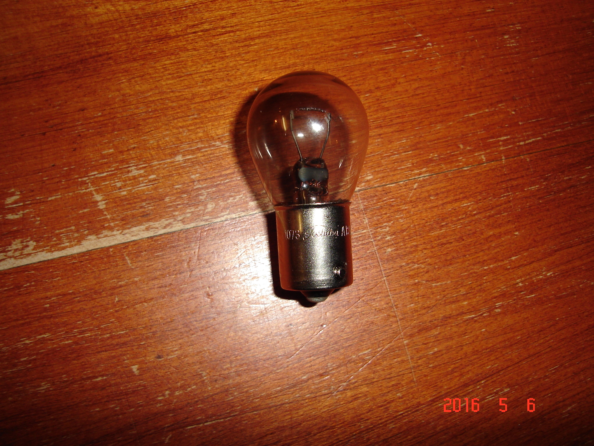

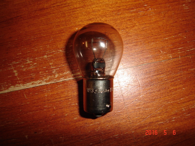

Interesting. My GC2310 uses a metal-base bayonet (push in, twist to lock) Toshiba 1073 bulb, 23 watts. (Oops..big file. Sorry. I'll do a second smaller one.)
