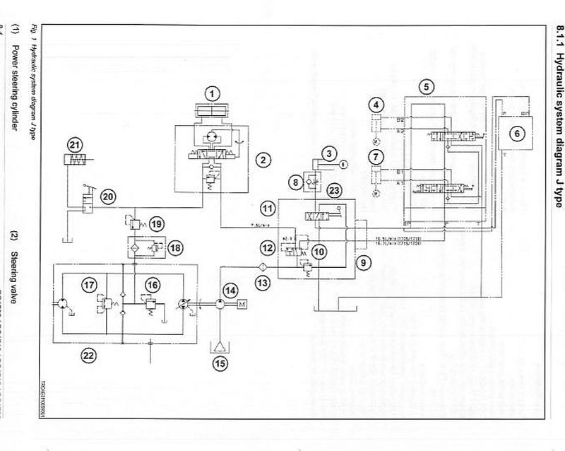

Just to confuse the issue or take it off track, does anybody have good diagram (or pictures) of how the hydraulics for the back hoe portion of hydraulics on the 1710 and 1720 and how they are connected.... I have a 1715 (no back hoe) and the funky MF sales brochure says "power beyond" is available on small 1700 series BUT the part number draws a blank and corporate and local dealer are no help....... I have schematic in shop manual for basic machine, but its pretty crude and not to informative when it comes to actual connections to hardware (tractor side)......
One of the reason for buying the 1715 was it the size I wanted the the advertised "power beyond" which seems to be non existent.......
Dale

Thank you for the link but I have been there and studied it a lot, and yes it gives a lot of part numbers and basic sketches but can not seem to find anything related to hydraulics of how backhoe is connected.... Is it connected between control valve and FEL valve assembly or does it go from PB port of FEL valve assembly back to BH and then to tank?.......... Seems to could possible be either of the two ways....In another thread (TBN if I remember correctly) a remark was made on 2300 series there was a manufacturing change to put BH power directly off control valve and then to FEL control valve .... IT give me a clue on how it "could" operate but I don't want to blindly have a couple of hoses made up and tear apart tractor to cobble something together and find I have cause major problem the will be very expensive to fix.... So far a lot of hours looking and no clear pictures of actual parts or routing or any diagram on how its done other than one from shop manual....
6 is to backhoe controls. (or could be PB)
5 is FEL body
9 is control valve...
Just wish resolution was a little better... IT really looks as if power (P) comes from control valve to power (P) port on backhoe valve body, out of power beyond (PB) of BH body to power (p) of FEL valve body.... Will deal with tank (T) depending on what valve body may be use in PB circuit.... And need some really good picture on how control valve is plumbed....
Dale
   / GC1720 Backhoe Hydraulic Lines for 3pt Splitter #9
I have the GC1720 and I believe it is Tank -> PB -> FEL -> PB -> BH (which also relieves to Tank) -> PB ->3PH ->Tank
