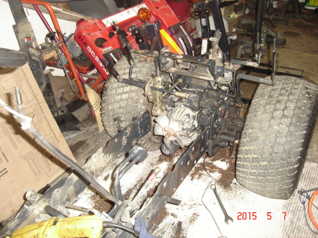

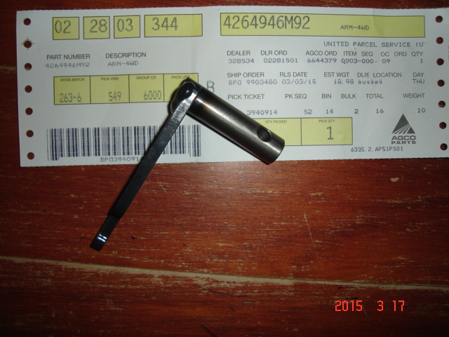

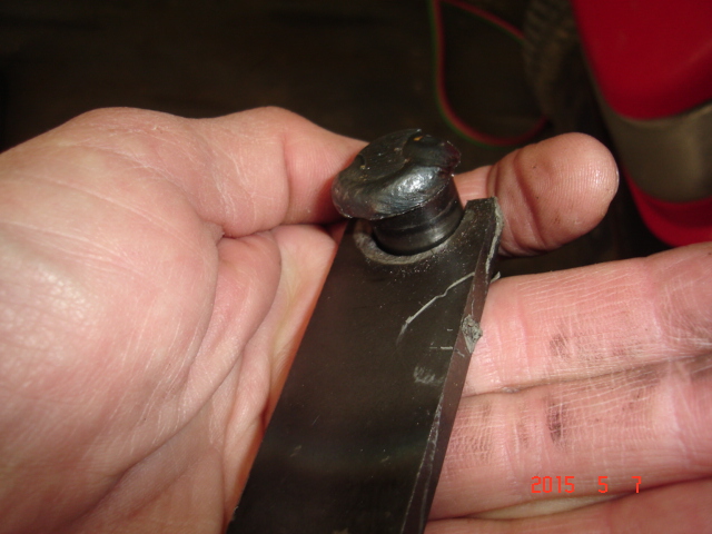

Hope it isn't, but... on my 2310, the 4WD shift fork (inside transmission) broke, from what certainly appeared to be a crappy weld. Part was about $35, labor around $1200. Way out of warranty, of course. 4WD selector lever moved, but there was no tension on it at all, no tactile "click" as it passed into & out of 4WD, if that helps.
If you need more details, send me a PM. Sure hope your problem's simpler.

FastDaddy, very glad you didn't have the same issue I did! It was a nightmare; the whole tractor had to be disassembled, separating the transmission from the front engine section, to get at that stupid little 4WD shift arm located in the transmission rear cover. My tractor was down for 2-3 weeks, IIRC.
And yes, do let us know what you find!
