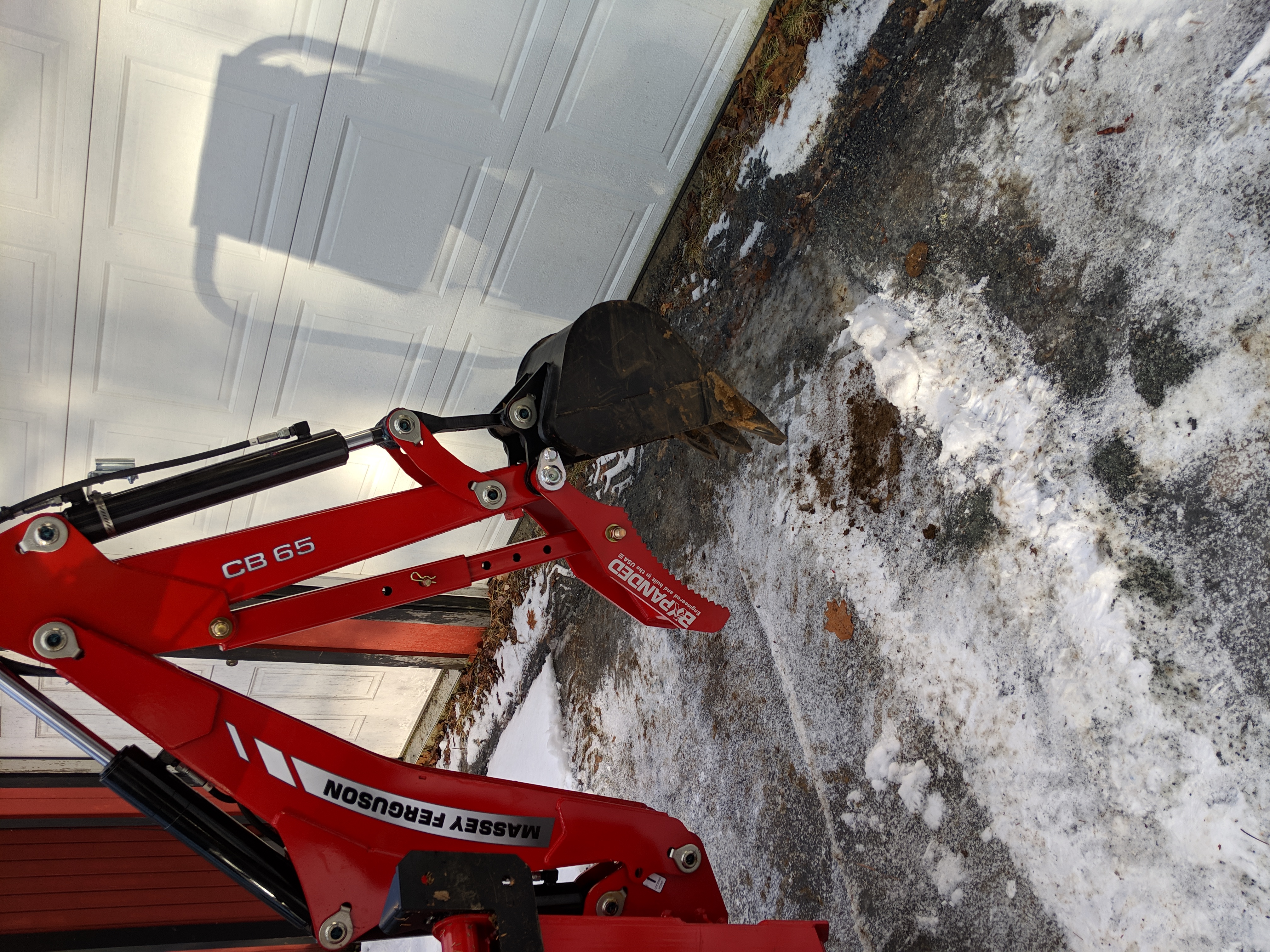

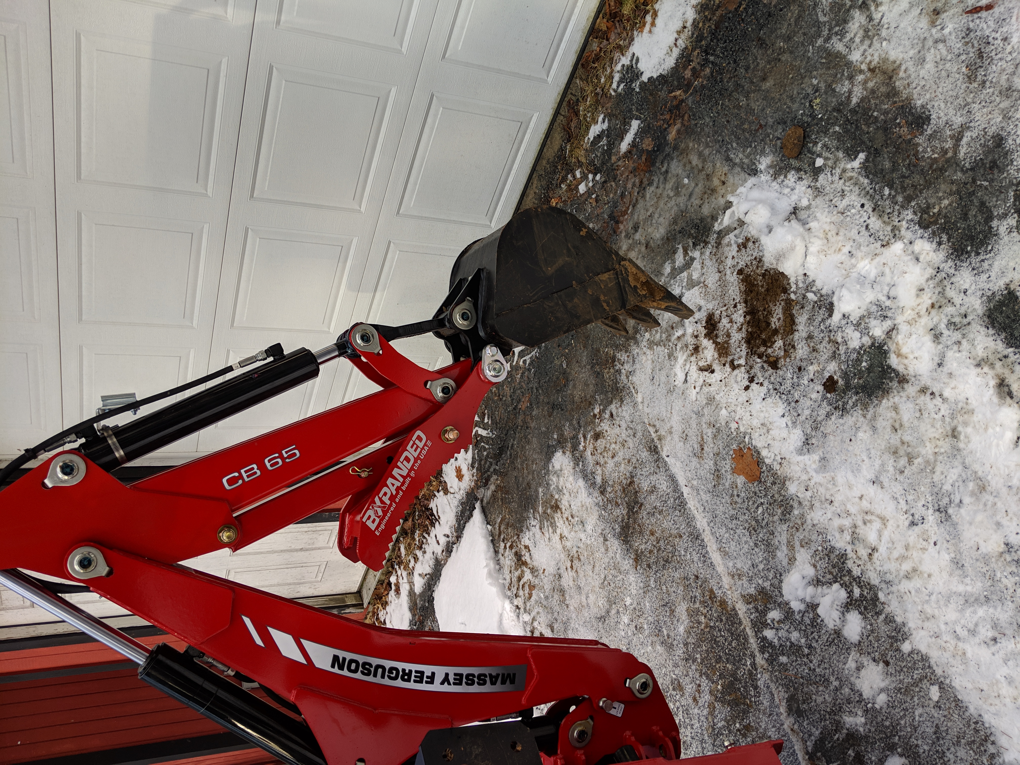

Not sure how long this has been available but it looks like a better design than the agco accessory to me...and it was $200 less than I was quoted for the agco thumb.
It came so well packed I think I could of ordered a dozen eggs with it and they would have arrived okay.
Pic of fully extended and stored positions...if this will work on my phone.
   / Gc1710 bxpanded thumb gets a thumbs up from me #2
Looks good! Your cell phone photos worked fine except there is some sort of white stuff in the pictures.

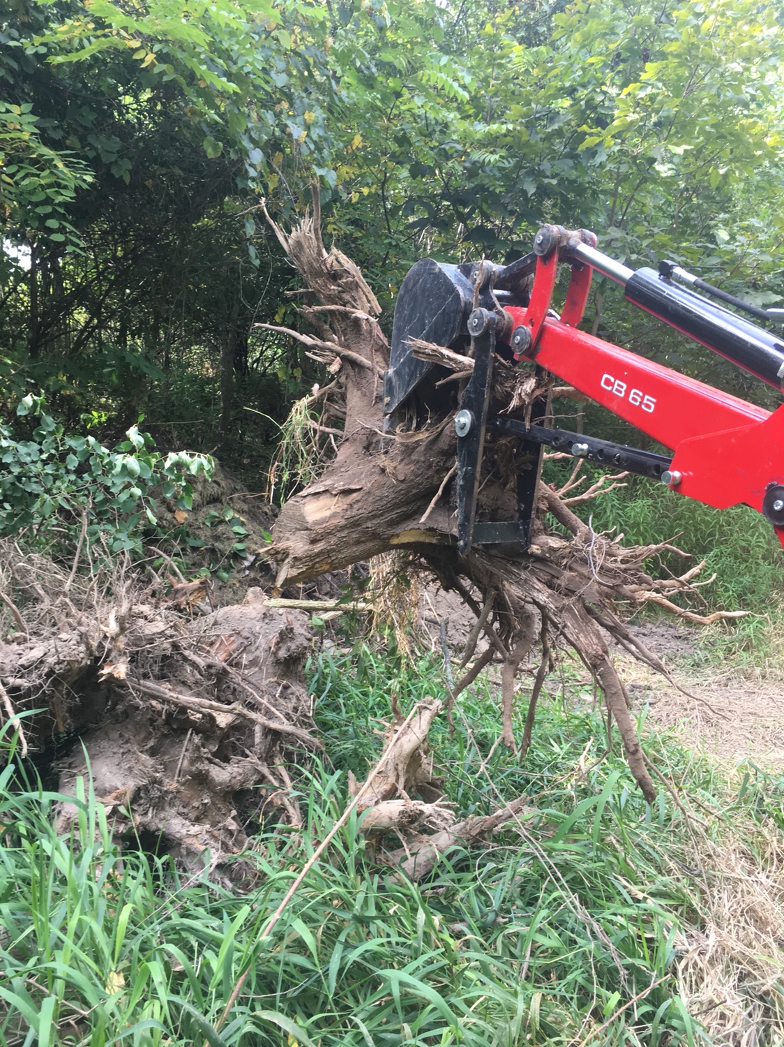

I worked the stock thumb into my deal....but it was designed horrible, had to cut the end and curve it in so it would grab stuff....if I didn’t have it I would go your route for sure, looks great! Don’t be afraid to put it to work! (Picture before modification) IMG_2825.JPG

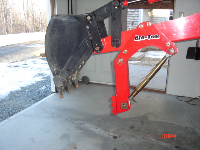

Well-- that's the first time I noticed that improvement on the CB65 BH-- the boom doubler plate hangs down a bit and has a bolt hole already in place for a thumb; great idea! My ol' 2310 doesn't have that, so the thumb I got (Bro-Tek) used a pair of plates that clamp onto the BH boom to make the attachment point. That CB65 is a much better idea!
You'll find that thumb is a great addition!
