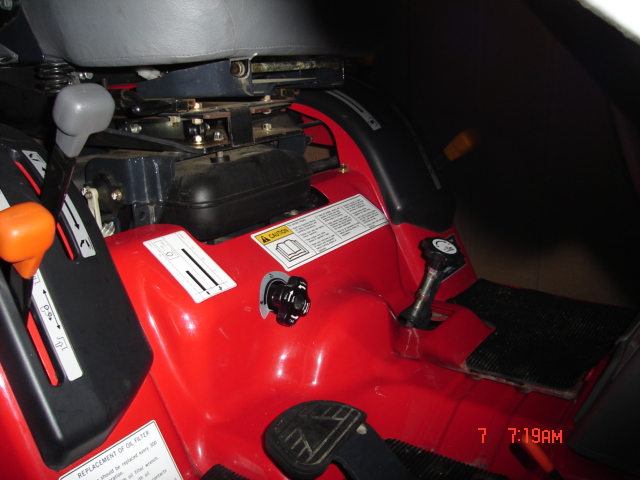

With or without the mower, when the mower arms are raised to full up, if I adjust the knob to lock they still go down if I try to lower the 3pt arms.
Dropped it at the dealer today and they said they've never seen one that worked - they are looking into it - but anyone that owns one - does yours work?

Chris, which knob are you referring to?
The knob to lock the mower deck arms up (at least on my 2310) is simply a threaded rod and a captive nut, beneath the floor. It's marked as "mower deck height." Turning the mower deck height adjustment knob fully clockwise (zero height) will hold the MMM arms up, but still allow the 3PH arms to drop when the 3PH control lever is moved to the down position.
The other knob goes to a hydraulic valve and prevents back flow to hold the 3PH in the UP position (which will also prevent the MMM arms from dropping, too). They are two separate controls.
In the pic, the 3PH hydraulic closing valve is on the left, mounted more or less horizontally, and the MMM height adjustment knob is to the right, coming up out of the floor, with the "+/-" symbols on it.
I guess it depends on what you're trying to do, but on my tractor it's possible to lower the 3PH arms without the mower arms dropping, but NOT possible to lower the MMM without the 3PH arms ALSO dropping. Does this help? ijk

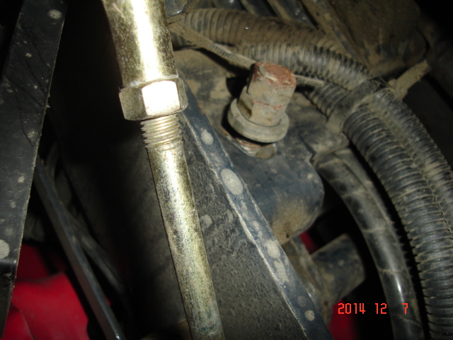

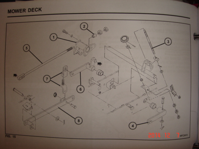

On my tractor, that threaded rod passes through the floor, then through a hole in a bracket-type piece on the forward most of the arms that connect the left side with the right side during raise/drop (it has no grease fitting). In the service manual pic, you can also see a short cylinder that the threaded rod passes through, which is inside a slotted section of that bracket. Very much like the adjustment rod on the rear mechanical brakes of a motorcycle.
At the bottom, it's held by a washer, a nut, and followed by a jamb nut. In the photo, it's kinda upside down, looking up at it from beneath the tractor. It's just inboard of the left side of the frame. In the shot from the service manual, it's #3, on the far right.
Any possibility yours has somehow become detached? As far as I know, the "hold up" feature is strictly mechanical. Almost sounds as if the nut(s) or that short cylinder aren't there.

Thanks for the time - the dealer called and said that the deck will drop some, not all the way, but a few inches in lock mode - does yours do that?
Thanks for the pic of the FSM page!
