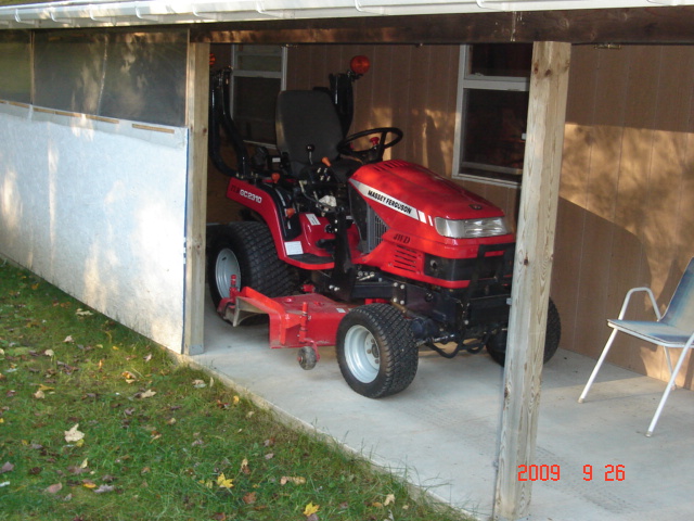

"...the grass deflector won't fold up more than 45 degrees, makes it tough to load and store with 6' door and trailer." (Assuming you're talking about the MMM) Solution: just take it off. I also have a narrow space to park the tractor, and it wouldn't fit with the deflector on so I took it off. No problems: it shoots clippings out far enough that they disperse well.
parked w: MMM.JPG
