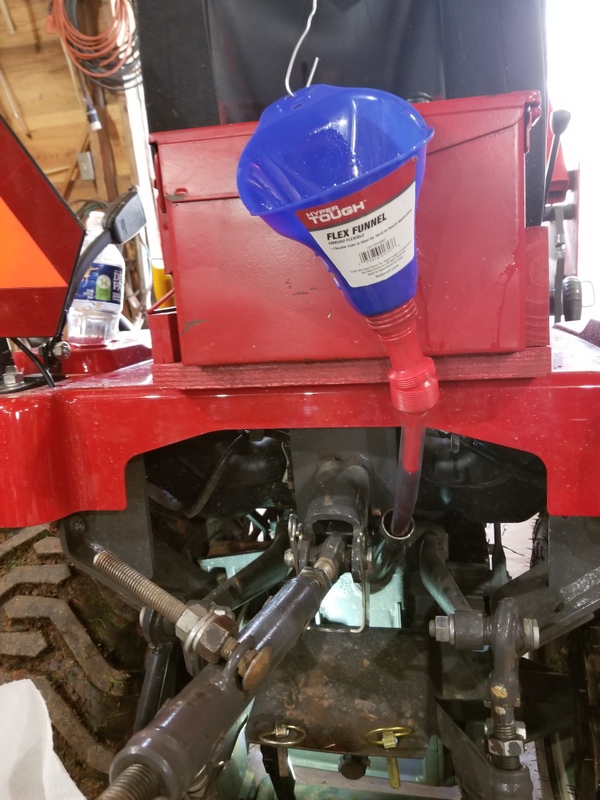

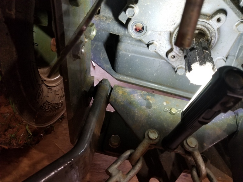

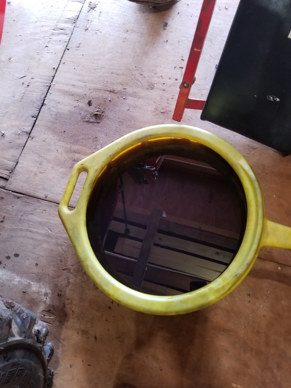

I thought I'd post about my 1st 50hr maintenance. I purchased my trans fluid from Amazon it was Triax Agra UTTO XL SYNBLEND Premium Tractor Hydraulic & Transmission Oil 23.19 a gal and a wix filter 23.58. If I had it to do again I'll go with a different filter. It took about 3 gals to refill the trans and when I did my test drive I was surprised at nearly no whine and it is much easier to shift from low to high speed. I changed to oil earlier and all I need to do still is clean the screen behind the tire. I still have a problem getting it to lock the rear differential but it will go in if I screw around with it enough. I thinking it is gonna have to go back for some warranty work.
20200320_103502.jpg The fluid was really dirty
20200320_105416.jpg This was my jury rig filler tube. I purchased a pump but it was real slow. So I broke down and poured it in.
20200320_110958.jpg I would fill the window and then it would drain down tried 4 or 5 times then it finally stayed up at the top of the window.
