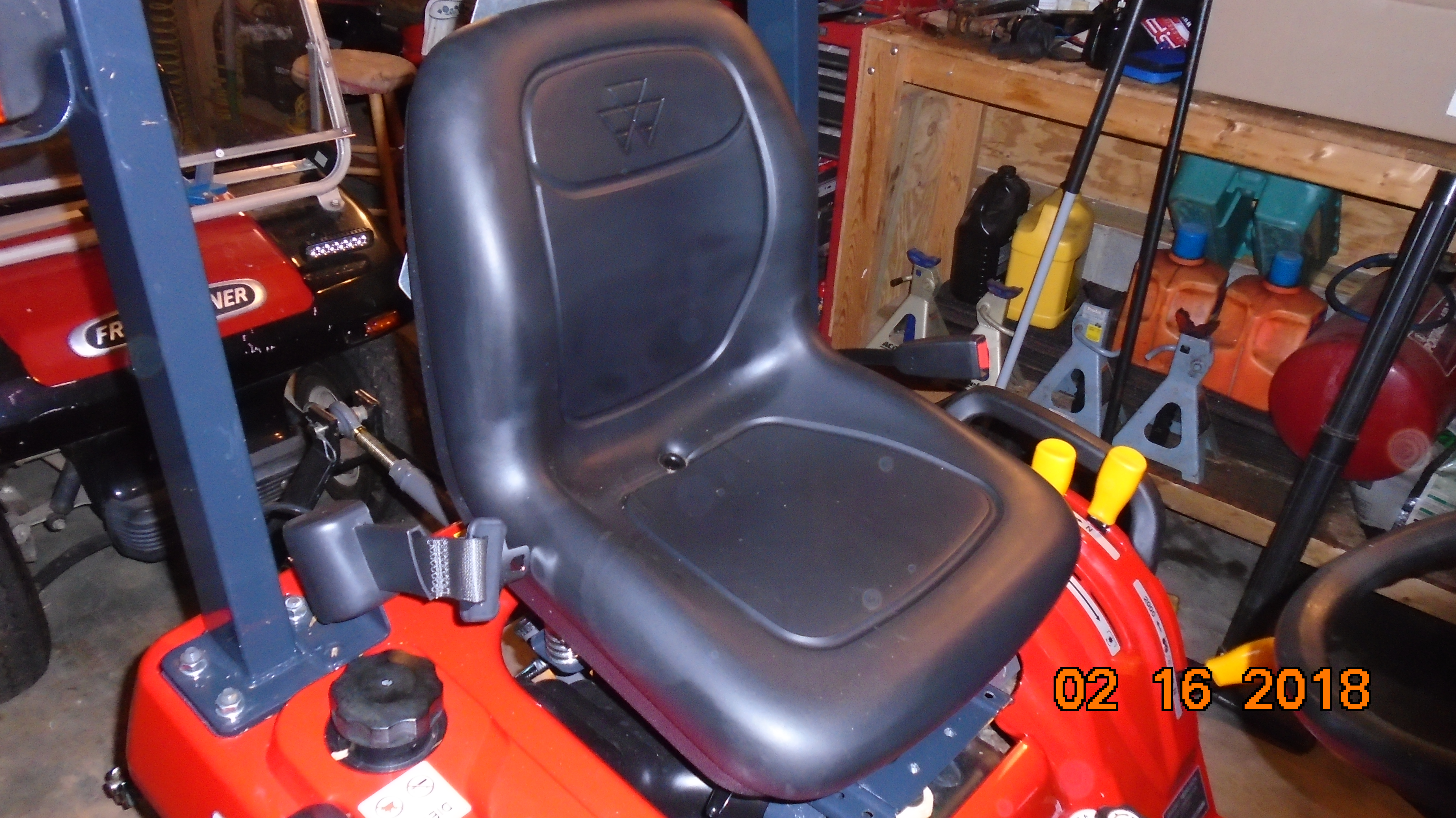

I found out that mine was pre Sept of 2017 so it had the 2 piece seat that was upgraded. Called my dealer and he said "no problem, just take the seat off and we will trade for the new seat".

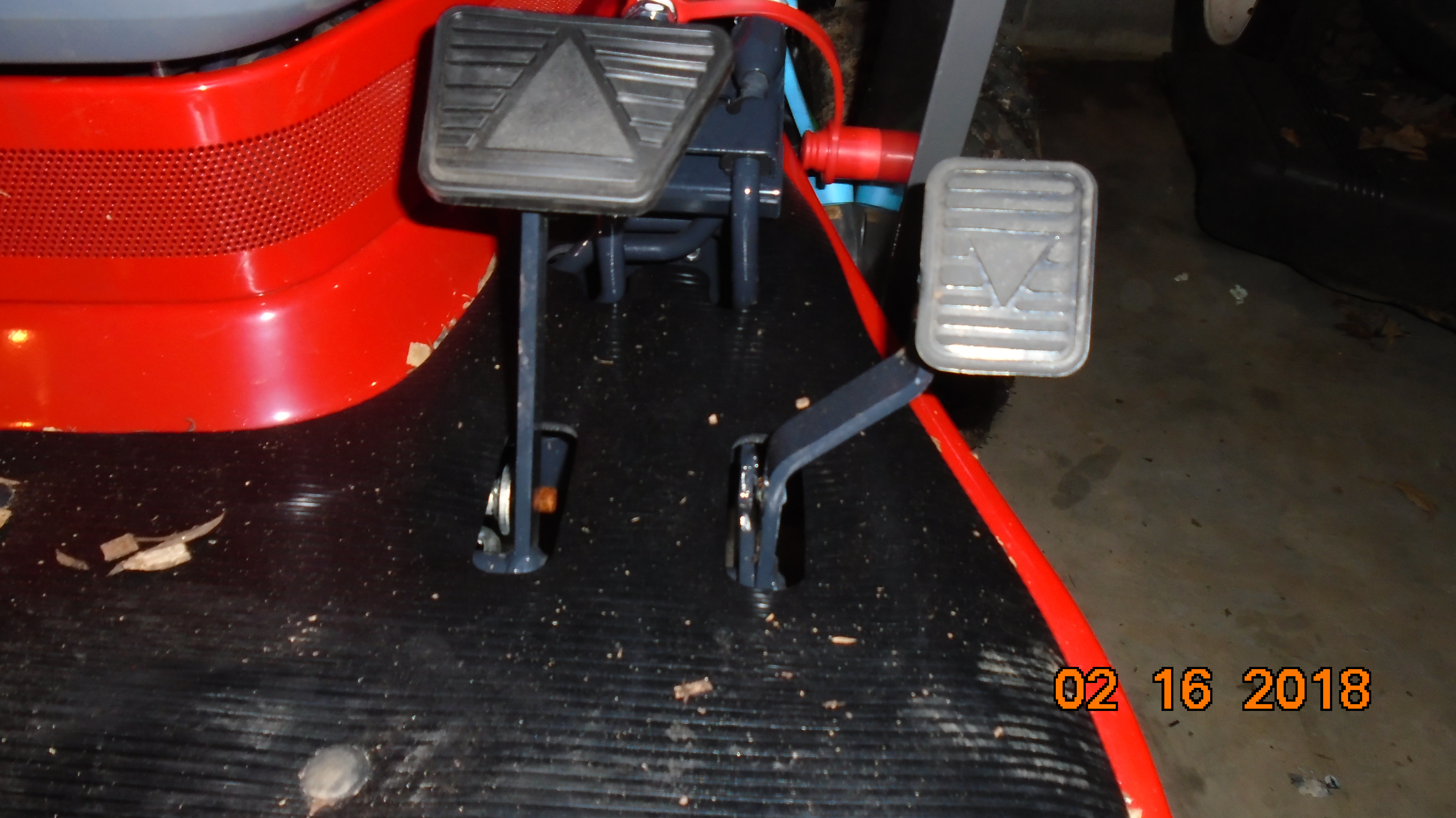

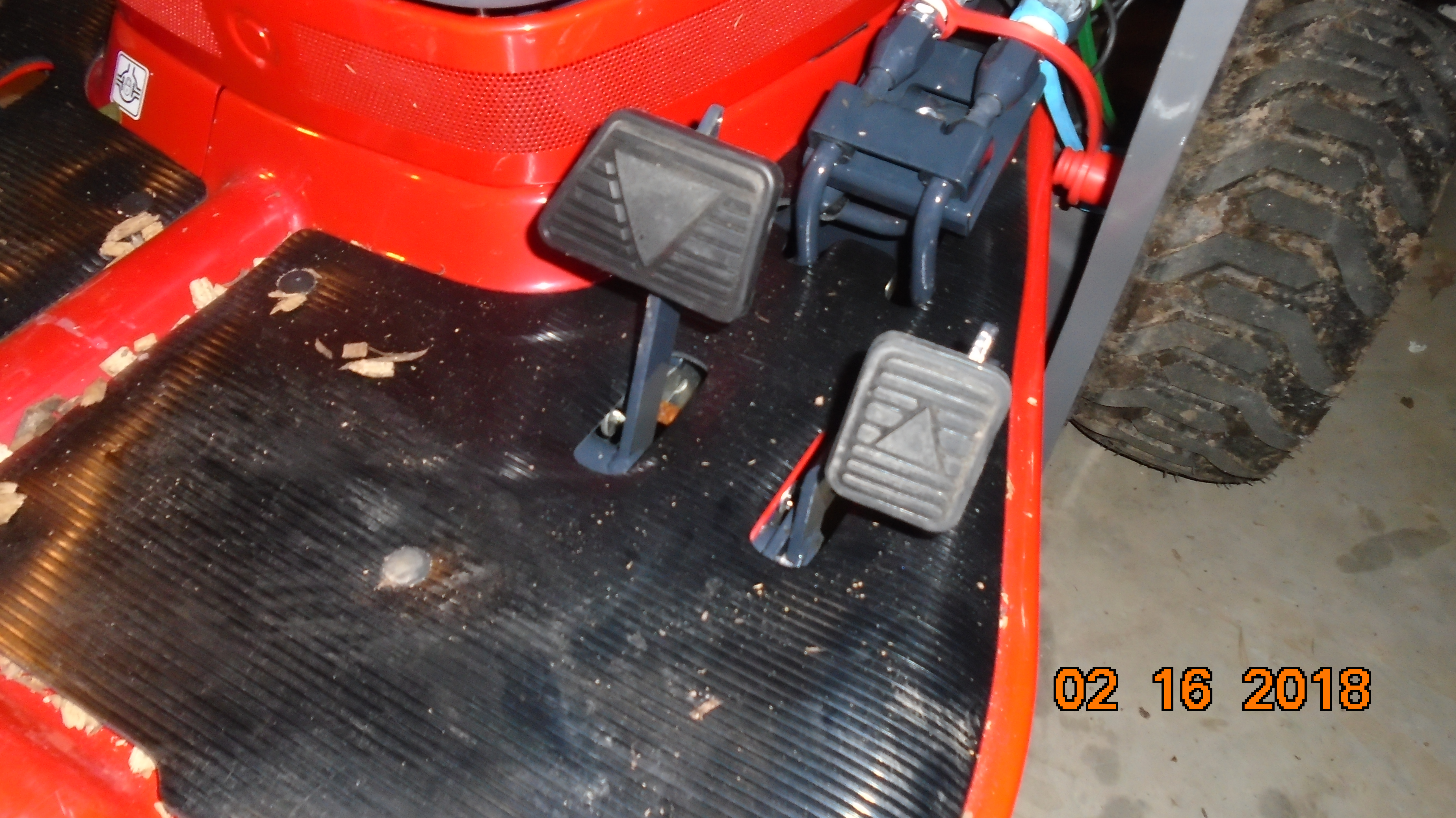

The brake, fwd & rev pedals are a little to far off the floor requiring lifting your foot off the floor and looking down to reach them. The fwd & rev were an easy fix, I reversed the pedal pads that are bolted on with one bolt

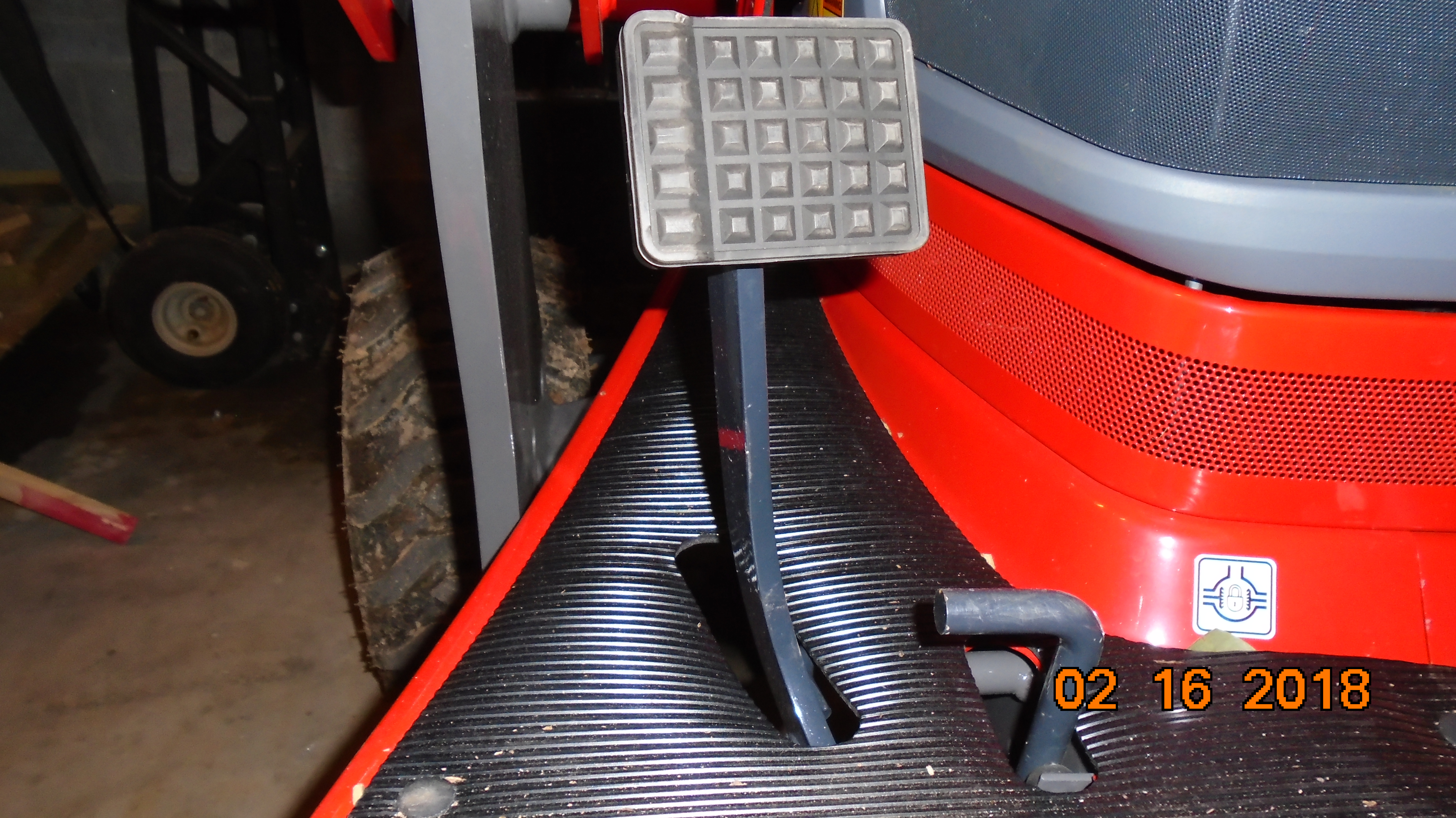

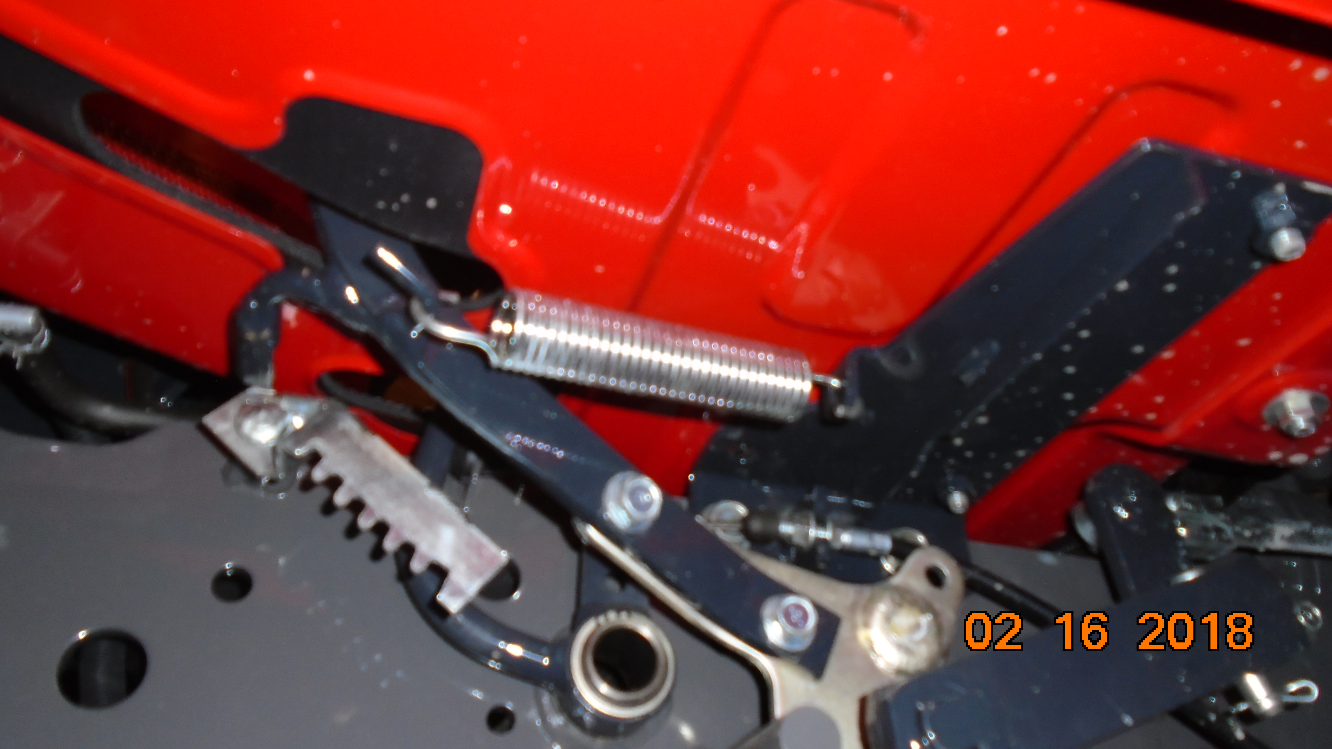

The brake pedal has a welded pad but it looks easy to remove and I am going to get my local repair shop to cut and re-weld it lower or I may just cut if off and drill a couple holes to re mount it lower.

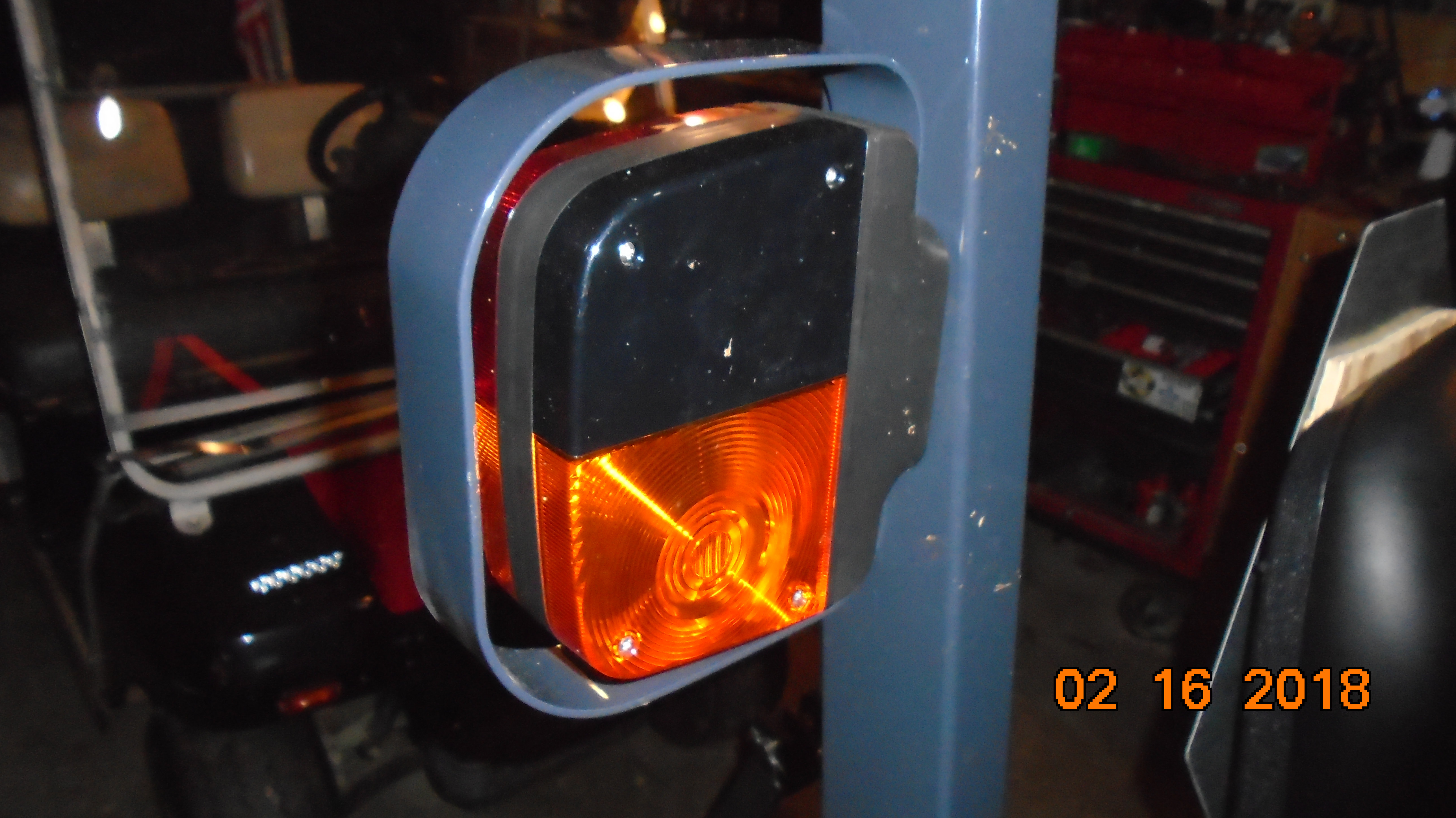

I also added the brush guards to the rear lights for $50, MF Part#6253545M1. They fit almost all the present MF models. thought it was easier than moving them inboard.

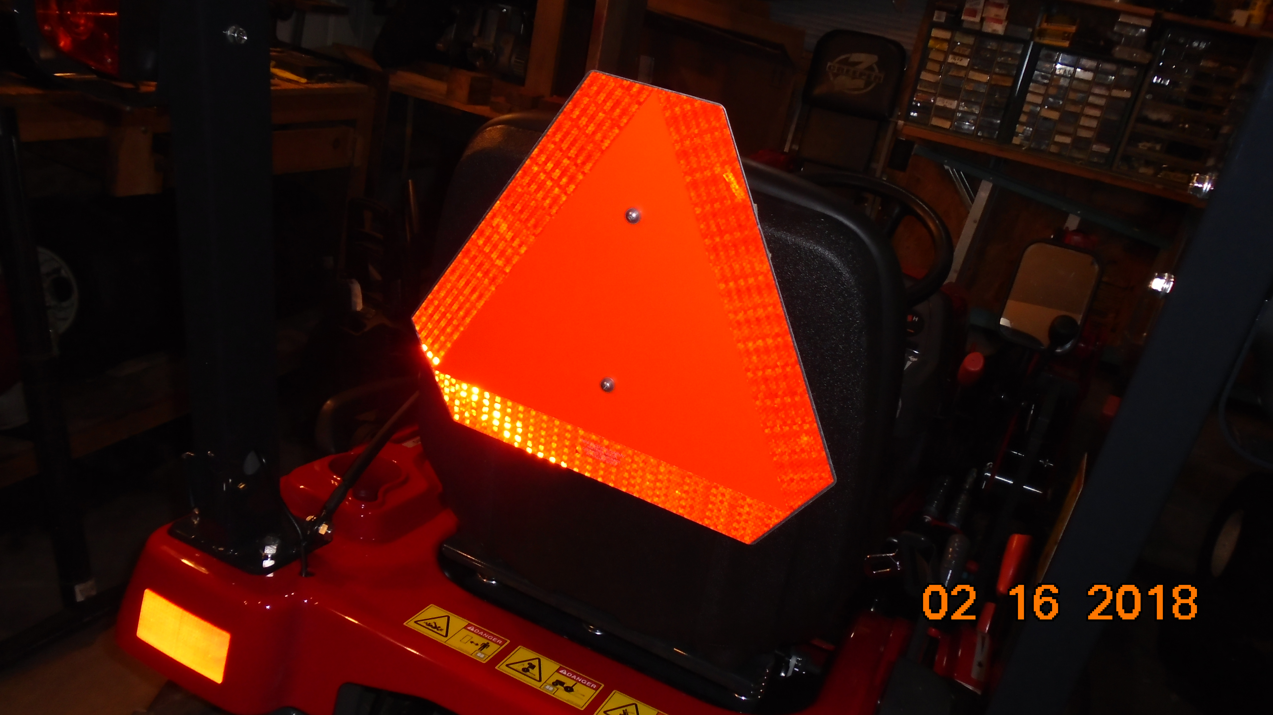

I also took the pouch off the new seat, 4 plastic push pins, replaced it with a piece of 1/4" plywood and moved my SMV triangle to the seat.

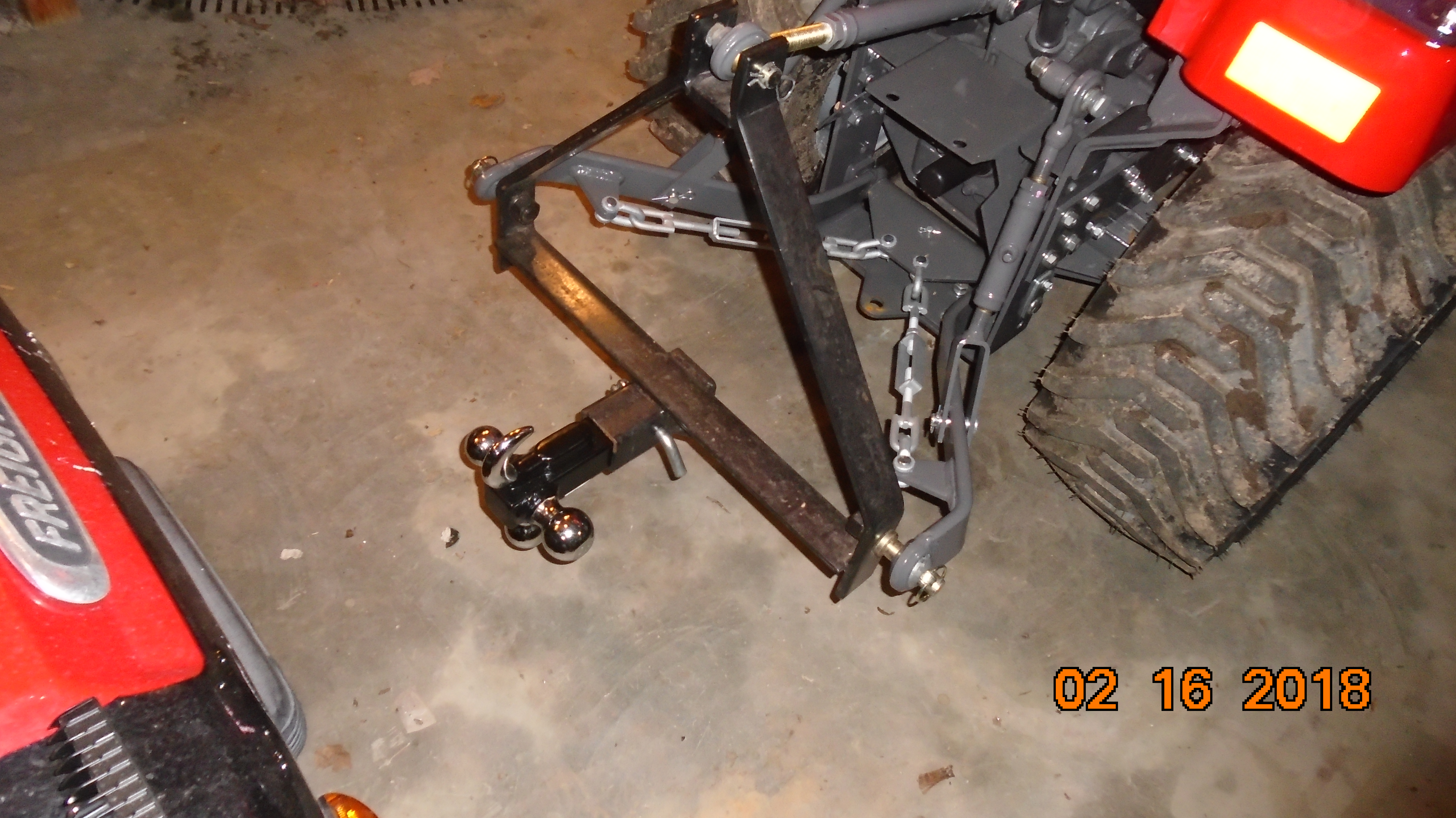

Also mounted my hitch bar from Titan Products and got me a new multi ball hitch so I can move my trailers around.

I can't believe they gave you a seat they want four hundred bucks from me for a seat I'm looking at the trading instead
