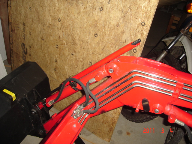

What can you tell me about this fel level indicator kit ?
   / GC1700 (and others) subcompact FILTER choices and needs. #4
You are correct that there are some other zerks I need to hit that I didn't so far . . Especially pedals related. I did to tie shafts for the pto to mmm but I'd also like to get the whole tractor elevated a foot and a half so I could really look the underneath over really well too.
I'll take a pic of the kit tomorow along with all my new Massey toys.. I am expecing a loop with grommet that is stationary, along with a bracket and rod that move as the bucket tilts. When the cutting edge is level the inside/crotch of the bend in the rod will be resting in the loop/grommet. I have also seen setups where the rod slides through a tube/pipe instead of a loop & grommet. When the rod is flush with the end of the pipe - the cutting edge is level.
I like em....
   / GC1700 (and others) subcompact FILTER choices and needs. #5
Here's what the M-F level indicator looks like; mounted on FEL arm, very simple. Black inside rod is flush when level.

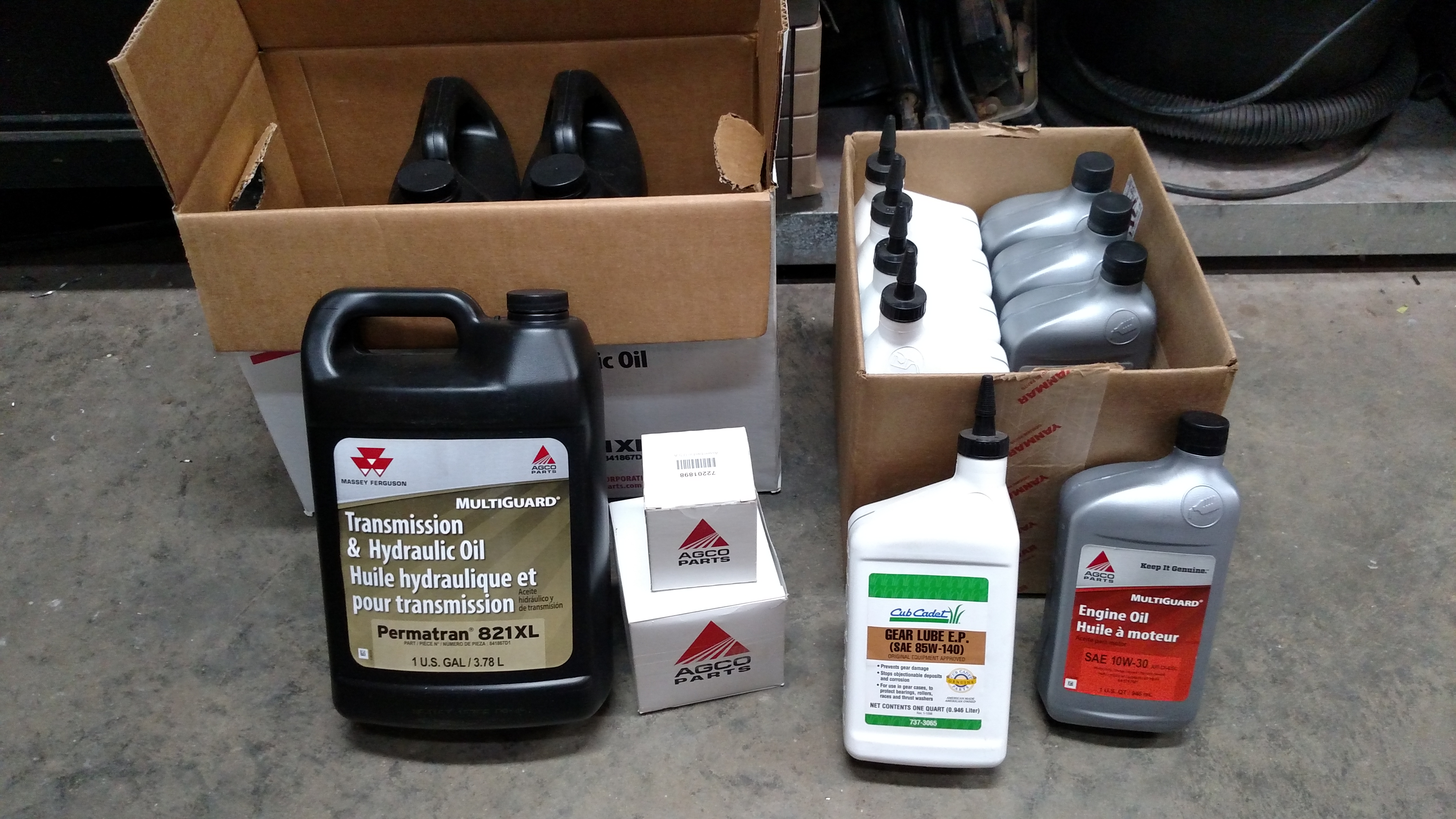

Here is what the dealer sent over for my 50 hr. Approx $160
Fxdb, your location says sebago. What part of the country is sebago? Why I'm asking is I notice they brought gear oil enough to fill the front axle (4.2 quarts) and I understand that is a good thing. But I asdume you are in an area that doesn't have much cold wrather, as regular gear oil thickens some as temperatures decline unless its synthetic which has better pourability.. I also noticed because they gave you 3 gallons of permatran 821xl which is the right amount for the rear-end. About the only thing I don't see is a fuel filter which may not be required for the 50 hour.
Looks like you are all set for tractor renewal :) will you be examining the fluids for any shinys :)
