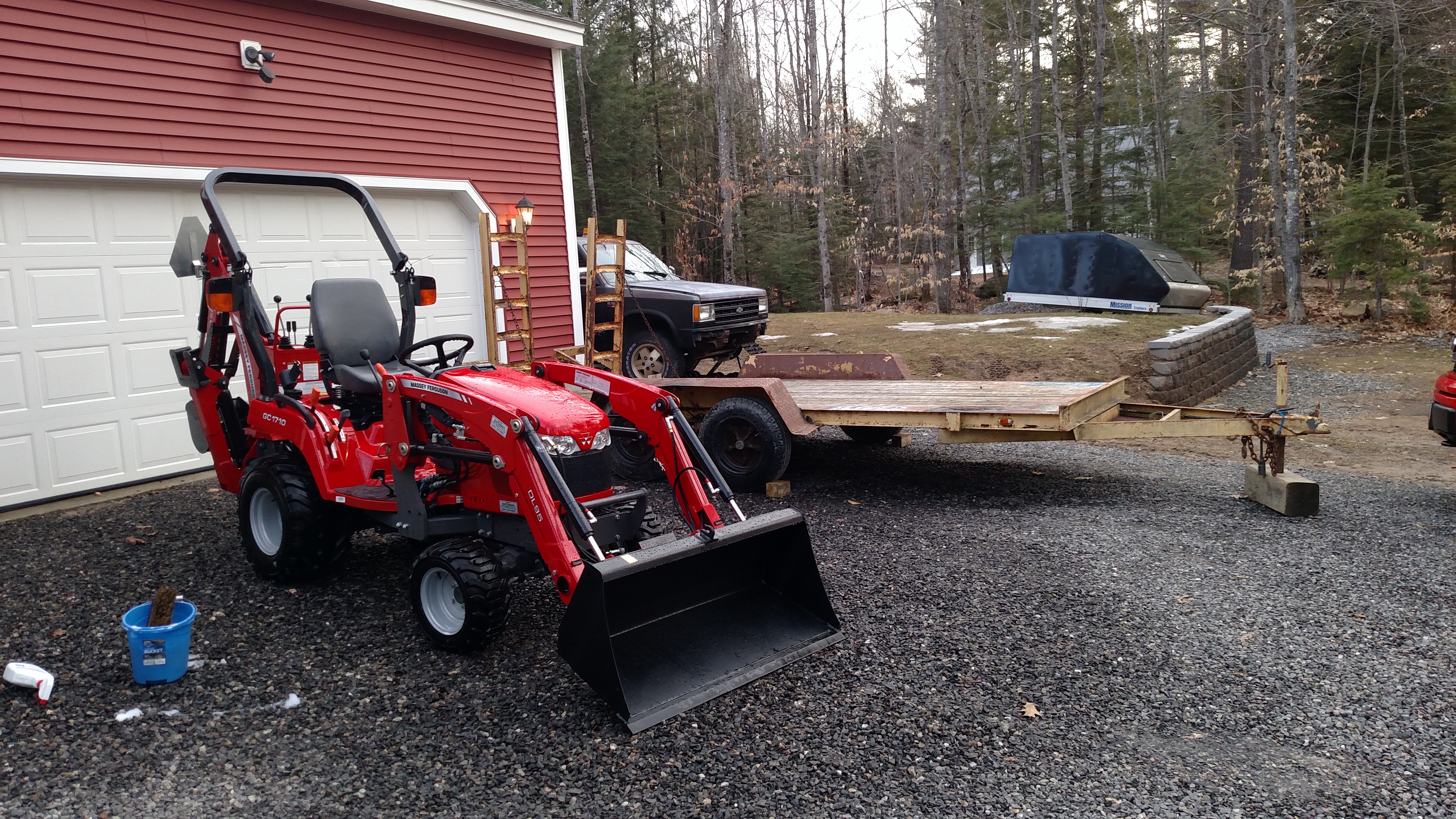

Owners manual states to run it at full throttle for the first 50 hours. Have you all broken in your Masseys like this? IMG_20160316_175510361.jpg

Huh? You sure there isn't a NOT in there? Bought mine used but that would the first anything new that I have heard of that wants you to break it in like that.
Operate at full speed. Prevent excessive load... If engine speed decreases too far operate in lower gear to keep higher engine speed.

I have operated mine at full throttle, since I got it.
The only exceptions are, warm up, and cool down.

running a new engine at full rpm without a load on it prevents the rings from fully seating, I think that's why most lincoln dealers will load bank a new diesel welding machine before the customer takes delivery. I know the cummins warranty info suggests heavy towing for the first 10,000 kilometers (6000 miles)
I usually run mine at lower rpm unless it starts lugging. there is a spot somewhere between 1500-1700 where the engine seems to run smoother. i can tell because the rattles seem to quiet down... not that they are very bad, but it seems to me that a quiet machine is a happy machine. :)
if i'm pulling a snow plow or heavy work and the going gets tough, then it's full throttle.
