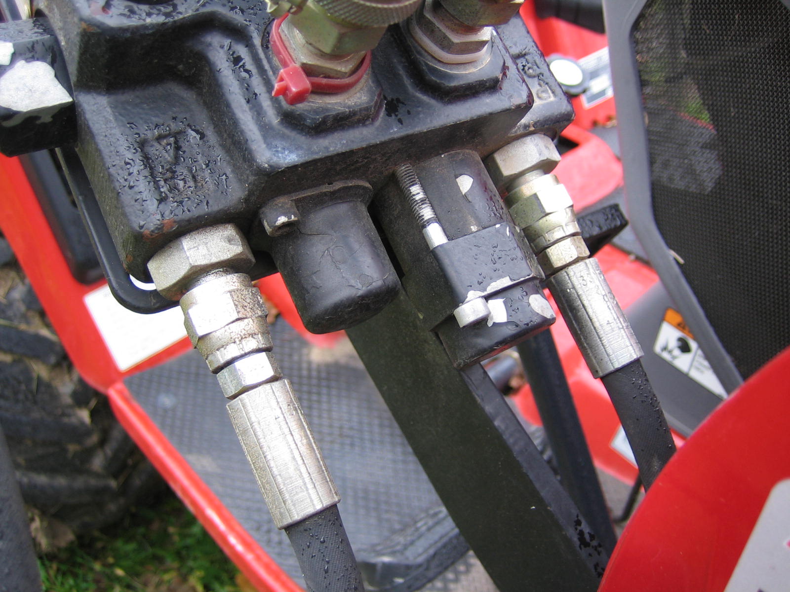

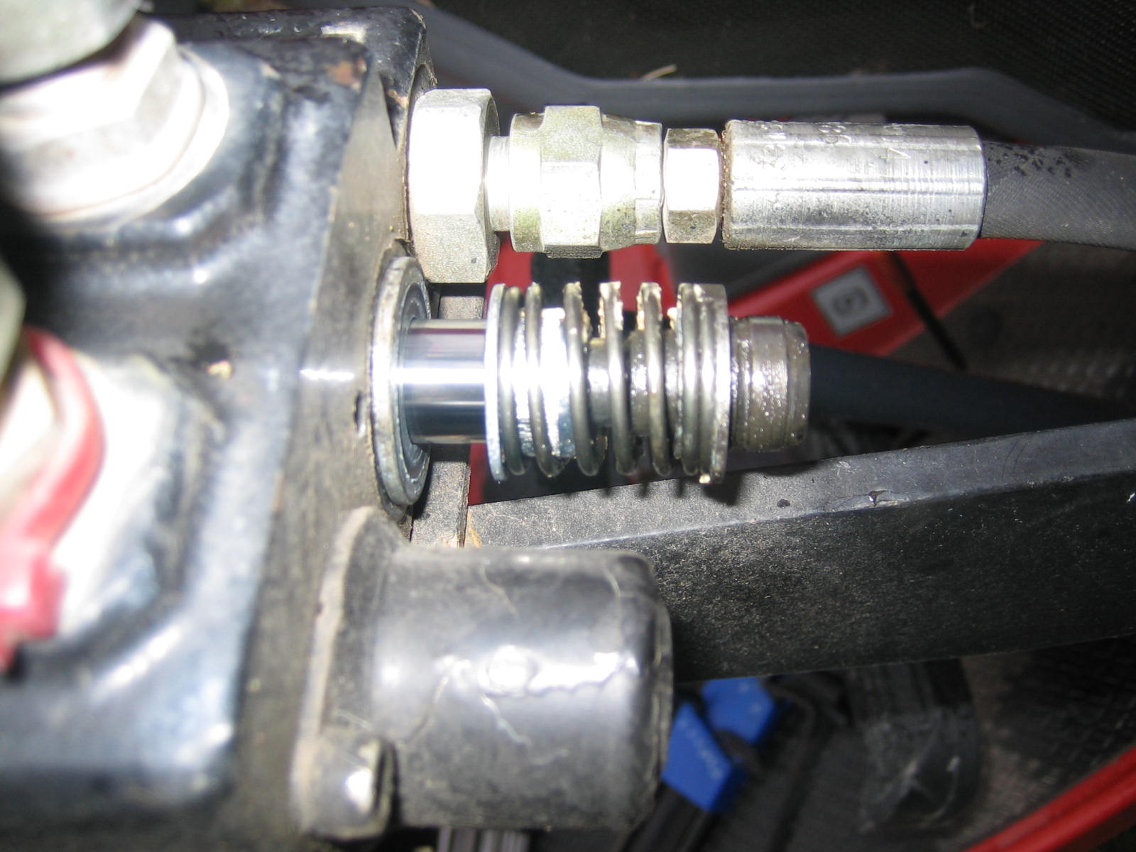

Probably an issue with the spring. If your valve is similar to the GC2300 just remove the end cover and take a look. Just lower the loader, shut the tractor off and move the joystick around to relieve any pressure.. The bolt attaching the spring to the spool can also loosen off, causing issues. Mine used an 4mm Allan key IIRC.

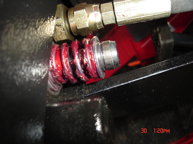

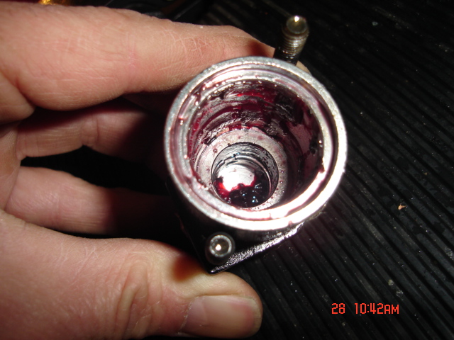

If this helps--
The float control consists of a sloped ridge on the bottom of the rod/plunger, which pops into a split ring at the base of the float control's cover -- rather like a snap closure on a jacket, for example. The split ring has to be open enough to be able to get the rod to pop into it, but --in theory-- tight enough so the rod stays "locked" into position.
I was unable to hit that happy balance. The rod will pop into position when the control lever is pushed upward firmly, but as soon as I hit a bump it'll pop back out again and you get the "digging" going on. Tighten up the split ring, and I can't get it to pop in.
So, I just keep my right hand on it with constant upward pressure to hold it in float. Not that hard to do.
Here's what the innards look like -- in the first pic, you can see the split ring in the very bottom of that cover; 2nd pic shows the end of the rod that locks into the split ring. As you can see, I cleaned & re-greased it, but it still popped out easily. Maybe somebody else has a better solution.
