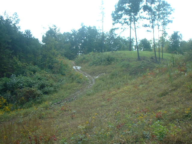

here is the hill I'm talking about.

Chris, from the look of the picture, the path portion of the hill looks like it is probably more in the 15-to-25 degree range. As you said you are only looking to climb it, not actually work on it, I think the little tractor should have no problems. Now if you want to work a steep spot, while running the PTO at the same time, then I'd be looking to a different machine. But transporting yourself and some implements on the path shown should not be a real challenge.
The small GC2300 will be nice inside the barn too, where a larger machine would be much slower to work.
Many tractors, even small ones can climb really steep slopes, working them is another issue altoghter. I think it is safe to say that a tractor can easily go places that it should not work.
I have steep slopes, not nearly as tall as yours, and I can get up and down them without problems with a Kubota, a Cub Cadet and a New Holland, I just can't turn sideways on them unless I use my Ventrac. By the way, when I go down my slopes I put the tractor in low gear range and 4wd. I forgot to do that about a week ago and started down a short but steep drop, the tractor started running and I locked up the brakes, I skidded all the way down to the bottom of the hill tearing up the turf for about 15' and the only reason the tractor stopped was because it reached flat ground. Be careful on the slopes.

as you can see in the pic my goats keep the hill to the right of the trail in the back very clean. I will be fencing in almost half of my property so the goats will clean the rest of the hills. As far as big jobs go I have been here 5yrs. and most of it is done. just have some little things left to do. My neighbor has a buldozer as well so I can always get him to push some dirt around and then just clean up after him. This being said I think the 2300 should be enough tractor for my farm. My neighbor will not agree /forums/images/graemlins/wink.gif but I think it will be enough. Thanks again for your help I can post more pics if anyone is interested.
