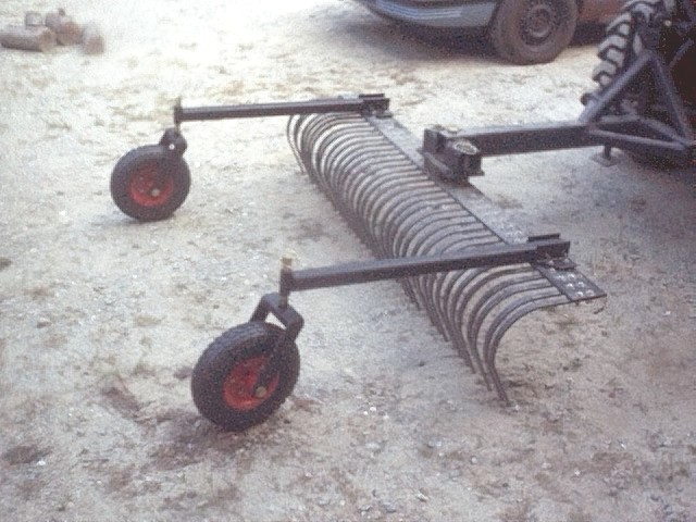

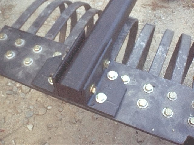

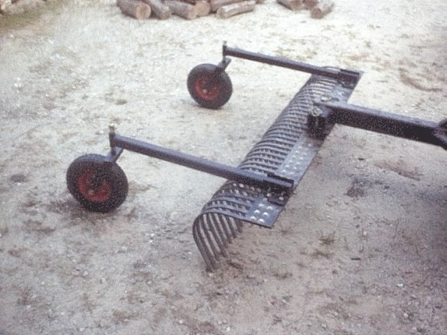

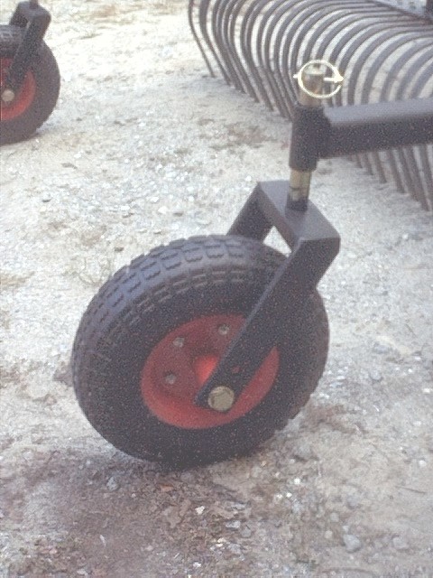

You obviously didn't look hard enough. There have been several very good threads on building gauge wheels. Here is a link to a post I made a few years ago on how I made my own landscape rake gauge wheels. The arms that the wheels are mounted on can be adjusted to any length you want from the rear of the tines. All you have to do is drill new holes. BTW, I made the rake too.
Gauge wheels build
These gauge wheels can easily be adapted to a BB or any other ground engaging implement.

Thanks for the help. It looks like most of the gauge wheels have a "fixed" height. What would be the ideal height for say spreading sand or gravel?
   / Gauge wheels #10
If you build them right you can add or subtract shims to adjust the height which would make them ten times more useable. Well, ten times more useable if you had ten different height adjustments anyway!!! :D
