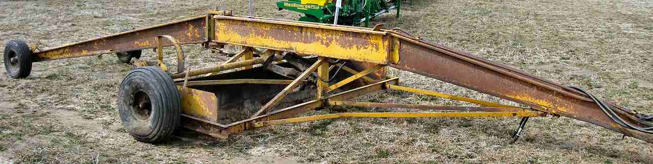

If your box blade has material in it, wouldn稚 it be deposited in said hole before the gage wheel reached it? I think the idea of gage wheels is to provide you a more regulated distribution of material than can be accomplished with the blade alone. Think if it as a mini version of the one pictured.
   / Gauge Wheel Skid Idea For BB #4
Yeah, I thought about that today. The idea behind the box blade is to hold material in it and fill in holes as it goes... Guage wheels should always have a good footing...
