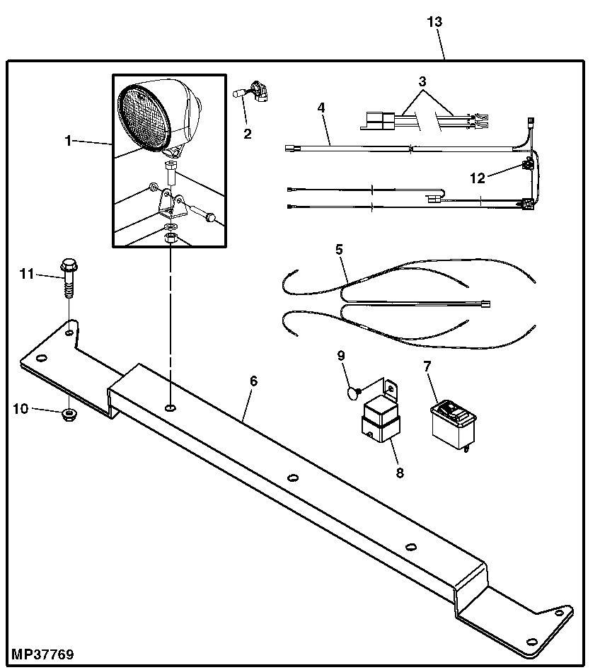

Maybe I just can't navigate JD's gigantic part website, but I'm about ready to throw my laptop through the window trying to get to the part number for the work lights that are on top of the gators I can find a bazillion pictures of on their site. I think they would look nice as rear work lights on my 3320. Waiting on the light switch to come in today so I can get going on it. Maybe I'll get lucky and they'll have a few lights in stock. Any help from anyone viewing today would be greatly appreciated.

I think this is what you are looking for:
1 AM135964 LAMP 3
2 AH166909 BULB 3
3 AM136296 WIRING HARNESS 1
MID 4 AM135947 WIRING HARNESS 1
FRONT 5 AM136295 WIRING HARNESS 1
LAMP 6 ........ BRACKET 1
7 AM117324 SWITCH 1
8 AM106305 RELAY 1
9 M71234 PLUG 1
10 14M7396 LOCK NUT 4
M8 Cart KEY PART NO. PART NAME QTY SERIAL NO. REMARKS 11 19M7866 SCREW 4
M8 X 20 12 99M7065 FUSE 1
15 AMP 13 BM22524 KIT 1
OPS LIGHT (ALSO ORDER TY26156 GREASE)
But I also think you won't like the price at $54.45 each!
I used THESE Hobbs lights that I ordered from Messick's, they are high quality lights used by a lot of OEM's.
BTW, I found the gator lights in JDParts by searching for "850D", a model of Gator, then selecting the "alphabetical" index, then under "L" I found the lights.
