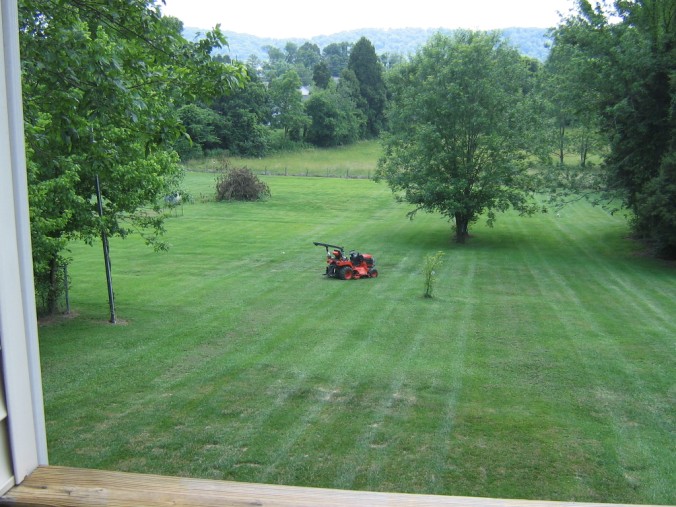

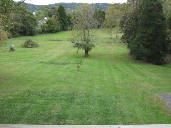

Useing the above mentioned cat1 to cat 2 bushings I also adapted a brand new set of gatorblades to the 60" MMM on my BX23 and their cut & performance far exceeded what I was getting from the stock blades.
I may retry the ole home made mulch plug again :D
Pic 1 shows the cut of the std blades.
Pic 2 shows the cut of the gatorblades.

WOW that is good performance! It looks like it sucked the leaves off that tree in the center of your yard:D
John
/ Gator Blades for BX decks #7
Not bad eh? :D :D
Actually most all of those leaves had fell on their own accord and the BX w/the afore mentioned gatorblades made mincemeat outta them :D :D

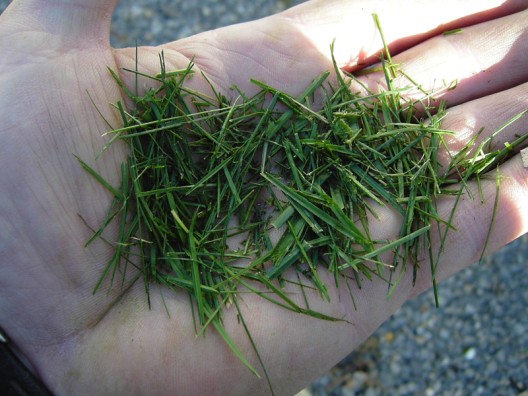

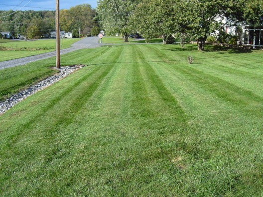

I just installed a set of gator mulching blades on my BX2200. 54" deck and they work great :D. I am very pleased with their performance. Even though these are the magnum mulcher's and are not supposed to lift the grass like the high lift blades, they do lift the grass rather well. I could definitely tell a difference. Because it was 7 days since I had last mowed, I left the bagger on to collect the grass. I was afraid that the grass would be too high to mulch. I usually empty the bagger 4 times with the regular blades on. Today I only emptied twice with the mulchers on. They really make a fine cut. Attached are several photos.

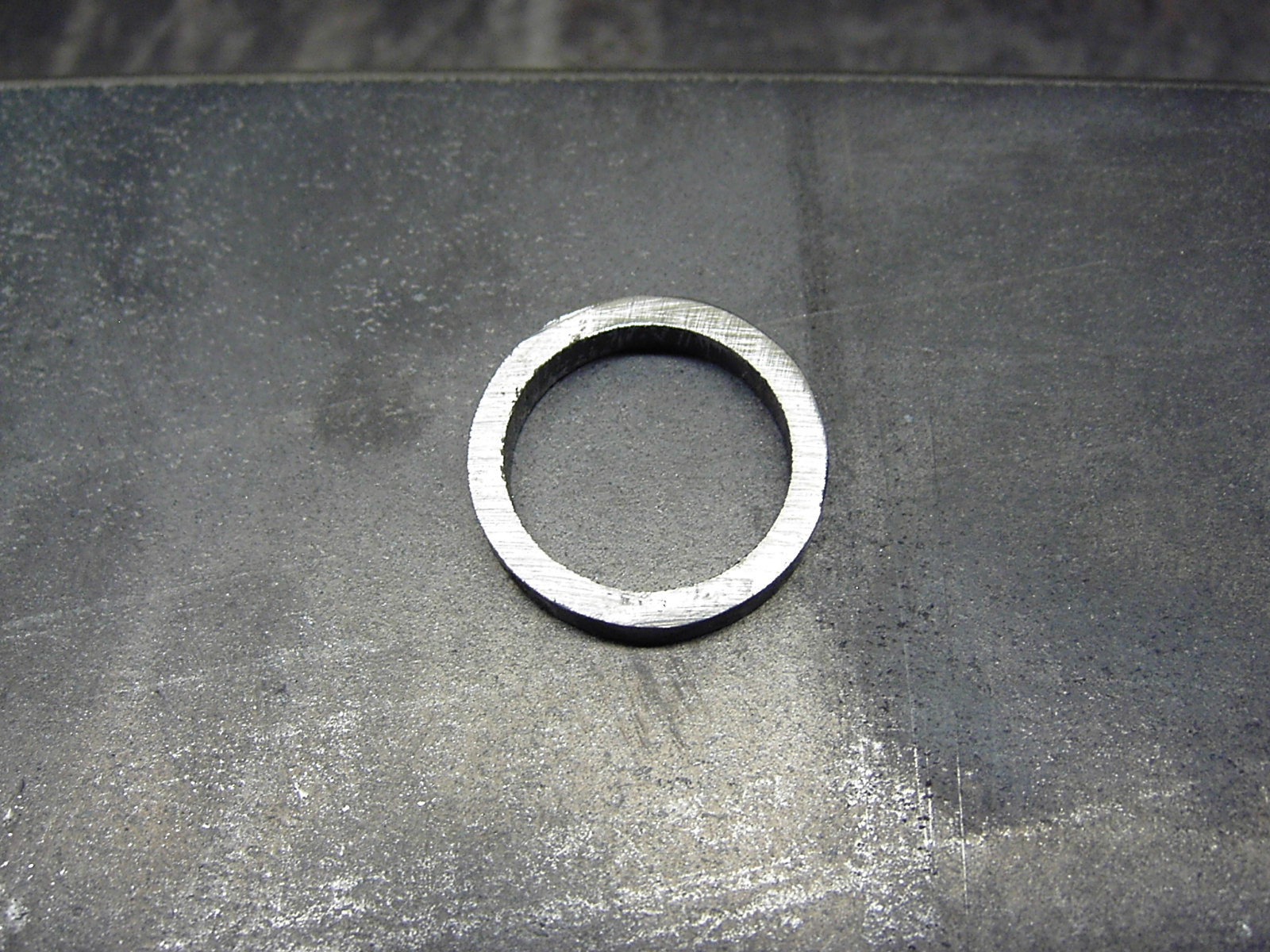

/ Gator Blades for BX decks #11

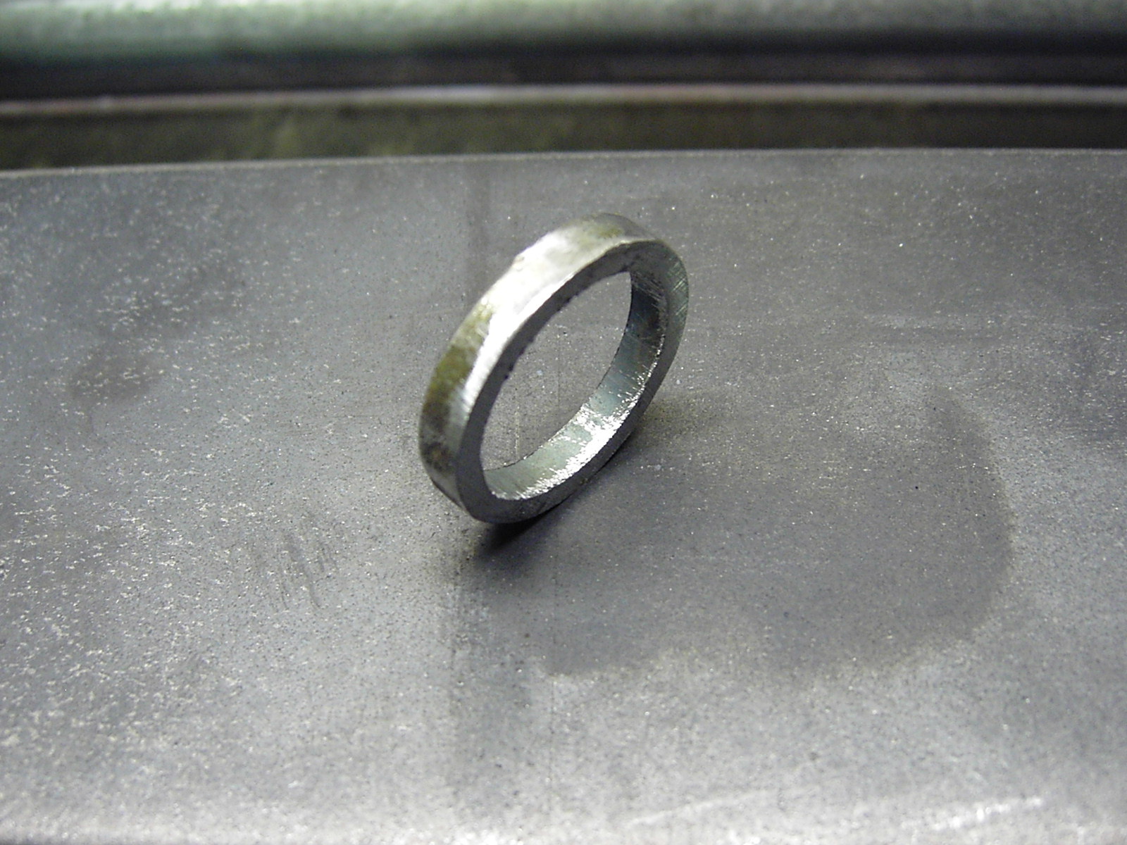

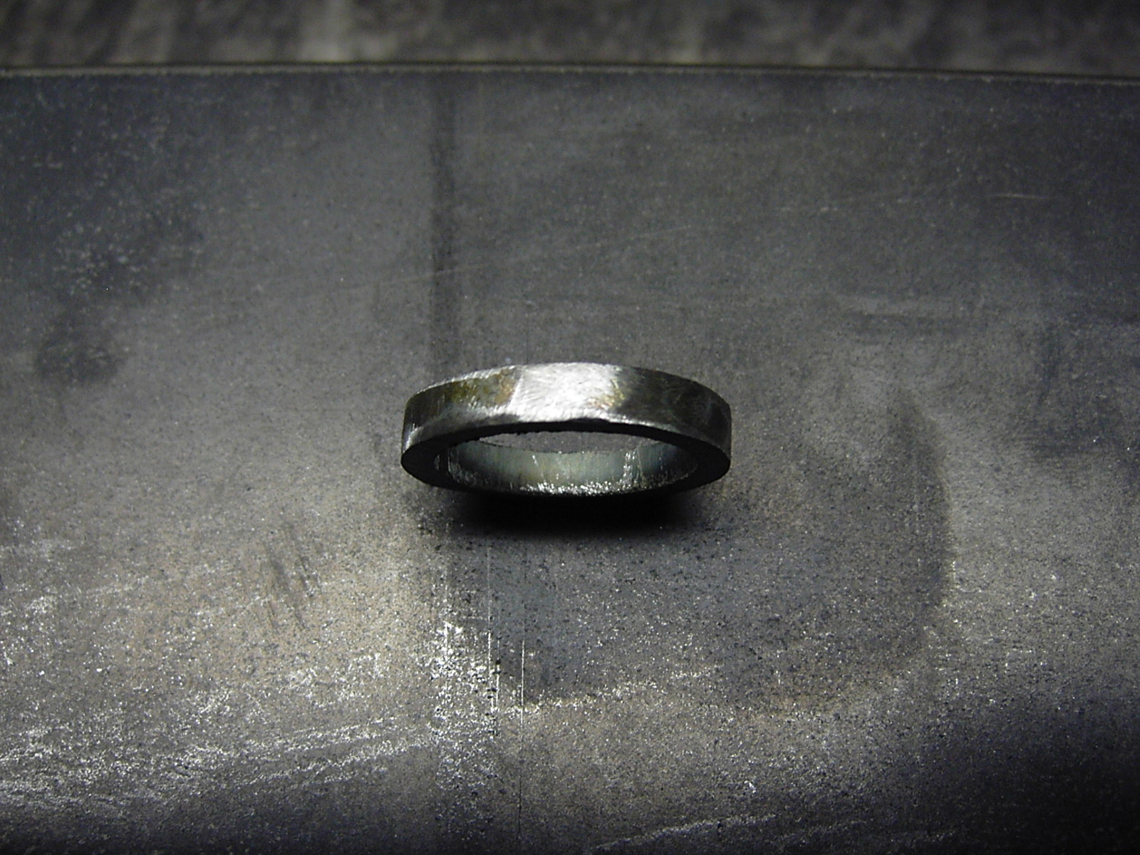

Those gator blades sound tempting. Can someone post pictures of the bushings that you need to adapt them to the BX deck?
Thanks,
Jack

Tdog,
Here are some pics of the bushings I used. I made mine out of a piece of Cat1 x Cat 2 bushing stock. I bought the stock at TSC. They measure 7/8 ID x 1 1/8 OD x the thickness of the blade. I just tapped them on the blades with a small hammer.
Bill
