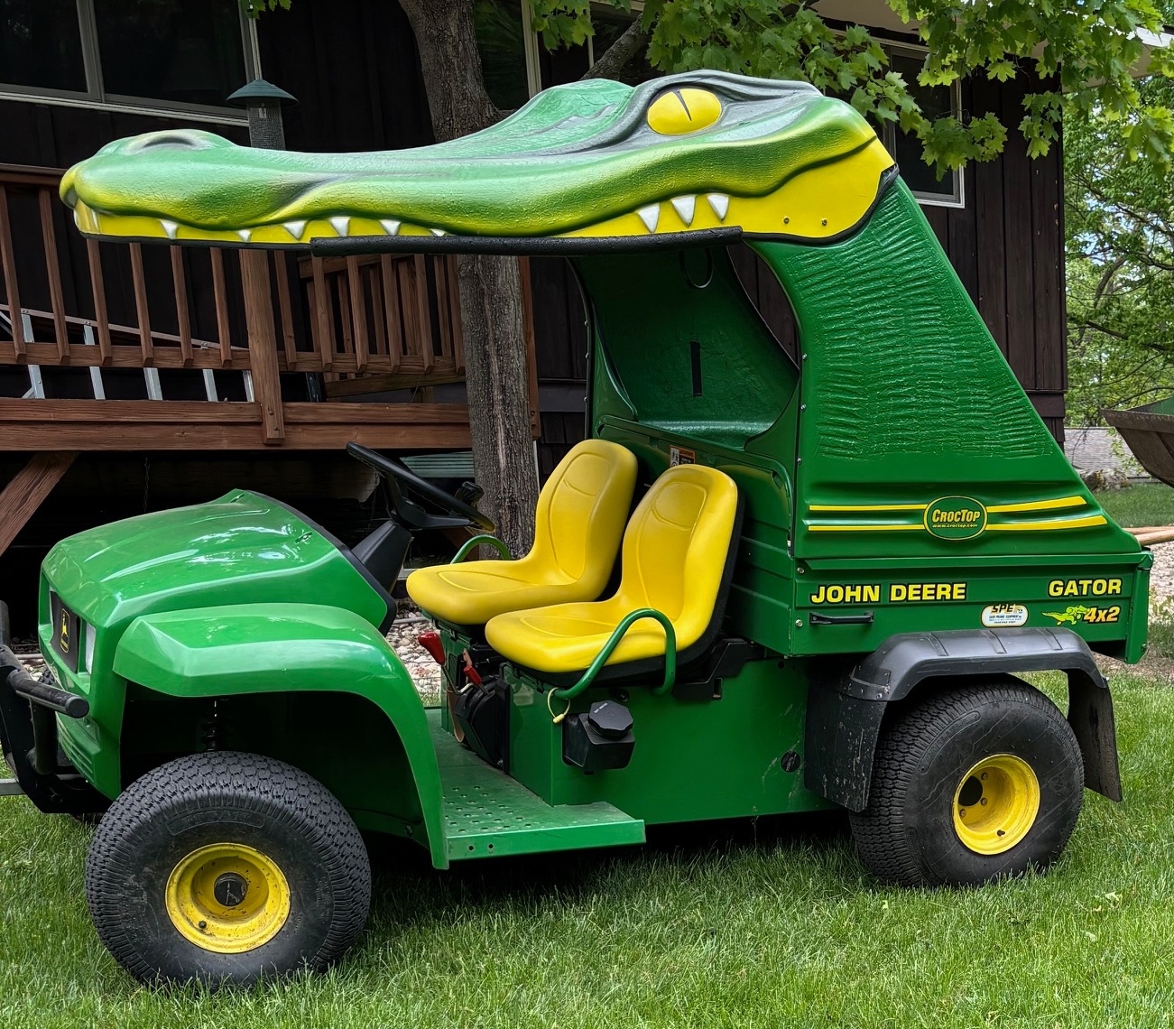

'98 4x2 Gator has delay in transmission engaging after sitting overnight. Revving up when in Neutral (5-10 seconds) before engaging in Forward or Reverse solves the issue, whereas engaging immediately is not smooth, and causes sudden engagement jerk in Forward or Reverse.
The tranny oil is "full" on the dip stick. Belt width measures okay according to service manual. 600 hours and started this recently this season.
Appreciate any thoughts ?

Now THAT'S a gator. Surprised you are not in FL.
CVT system has a centrifugal clutch. May be failing. I would start there.

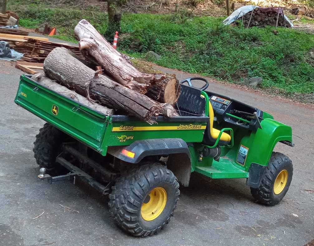

I tried to squeak a few more hours out of this Gator HPX850i. The UTV had many hours on it and it seemed the centrifugal clutch was failing. It was time for a full CVT rebuild. Common problem and you can get aftermarket parts. Symptoms not exactly like yours.
I tried to buy this machine as-is after it quit completely, but no success. After 2y sitting outside, the owner had it picked up to be fixed by a shop in town. After 6mo, it is still there.
