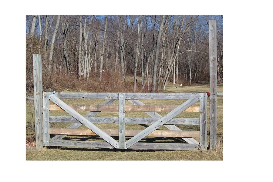

Don,
Here is a picture of the gate to our garden. I used 1"x6" pressure treated decking boards. The decking boards are held together with carridge bolts. Bolts hold up much better than nails. The gate width is 12' between the uprights. As you can see, I used 6"x6" pressure treated posts. The post on the right is 12' and buried about 3.5 feet in the ground with concrete at the base for stability. A chain extends from the right post to the end of the gate to take pressure off of the hinges. The hinges are standand gate hinges. It cost me about $100 for all of the materials excluding the end posts.
Hope it helps.
Terry

Thanks Terry. I think I will build something pretty much just like that. It
looks as though yours has lasted some time now.

/ Gates and adverse possession #32
Don,
The gate is about six years old now and is basically maintenance free. I've only had to tighten the nuts on the carrige bolts once.
What you see behind the gate is my yard not pasture. I took the picture with sun behind me.
Most of the trees you see in the back ground are Hackberry trees. They provide good shade and thats about it. There are also some Elm, Black Walnut, Oak, Pignut Hickory, and Box Edler trees.
Good luck.
Terry
